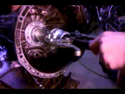

                        Cheers! its been a few years since i looked, I also found this one. its in russian(?) but you get the idea. his guy uses some percussive maintenance to get it out, i think id rather tuse that puller/pusher system. doesn't seem that hard at all, although if it doesn't move i guess the bolt holes that hold that contraption to the bell housing could crack.
                        Let me see if i can track down my busted gearbox and give it a go.....
                        https://www.youtube.com/watch?v=0tuC0Ibqqd
                        and this one is good too
