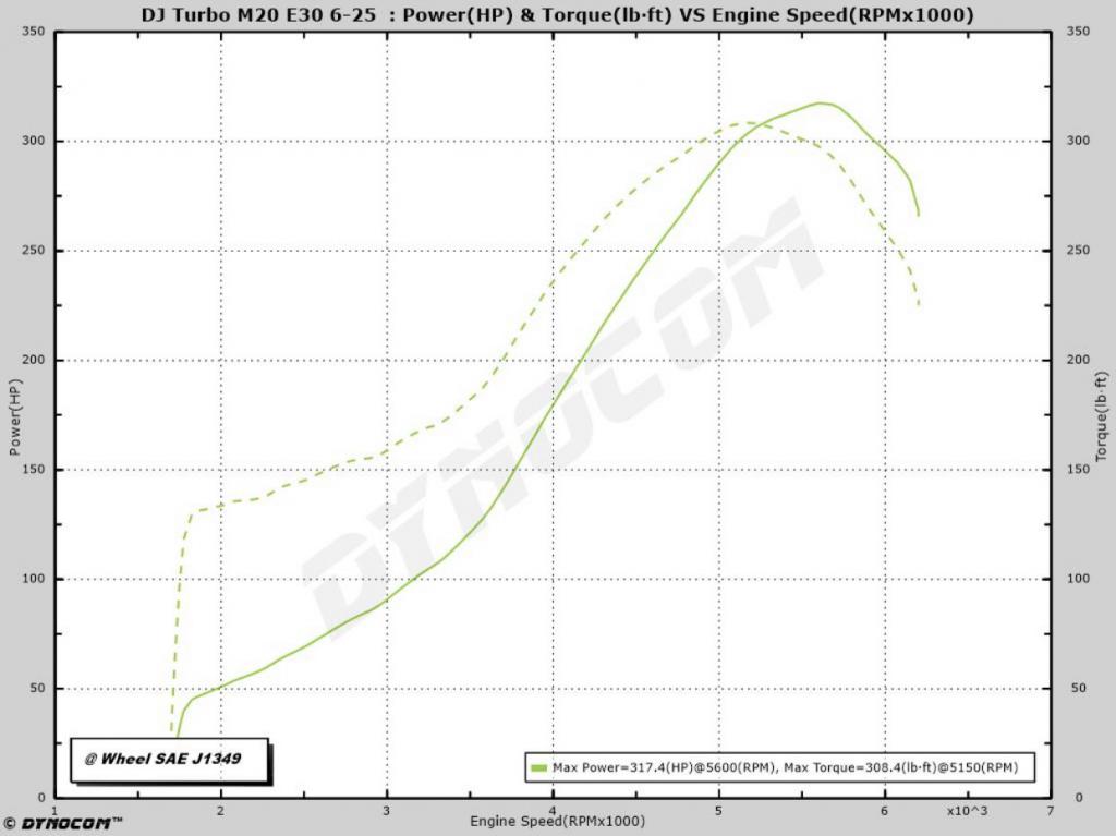

      Go check out my build as I just went through most of this stuff.
      I achieved 300-320 hp and 300-350 ft lbs on 14-16 lbs of boost.

      -tune with MS3 pnp and aem wide band(already in hand) - Yep. I choose Kdata which is like an open sourced MS3. I also used AEM wide band and AEM truboost (this has help A LOT to dial in boost).
      -dyno - we turned my boost down a tad and are now achieving a really nice curve at 317hp/309ftlbs.

        Here’s my current tune. I could do more but this feels perfect and drivability is spot on.
