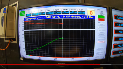

      Originally posted by digger
      pretty sure the rpm is axis is wrong which screws up the torque. it was peaking hp at 3300rpm lol or they were looking at roller torque and roller rpm
      Yeah I noticed that RPM thing, it isn't roller RPM unless the roller is 0.13m/5" in diameter by my calculations. Is dRPM supposed to mean derived RPM? How does one get RPM all wrong when you can just put the clamp on a spark plug wire and tell it there are 8 cylinders? Glad I just skipped through the video, seems like they phoned it in.
        its called laziness the number of operators who cant manage to get an rpm signal is a joke as it seems to be the norm
        not sure about dRPM my guess is youd be right, i know mainline have torque (rwhich is rwhp divided by roller rpm) and derived torque ( rwhp divide engine rpm) so when you see a mainline dyno you need to be careful. Anyway somehow theyve balls'd it up as the stock engine runs about 550Nm crank as rated so the chances of it making 700Nm at wheels is precisley zero
