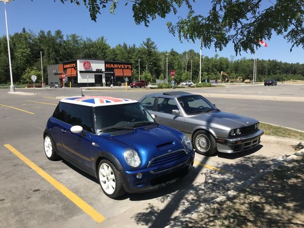

              My ex had an R53 (1st gen supercharged).
              Although it was fun to drive, it was a PAIN to work on. I had to blow the whole front end apart just to change an alternator.
              Also had awful drone after I pulled the muffler off and straight piped the rear section. I wonder if she ever decided to put a muffler back on?
              Hopefully the 2nd gen will be easier on you!
                  I would've loved an R53 but they seem to be much more rare, and any R50/R53 here seems to be a complete rust bucket.
                  Probably would enjoy the go-kartiness of the R5x, but the R56 still has some of it.
                  Seems so far that the R56 is just as difficult to work on, has fewer chassis issues, but more engine issues lol.
