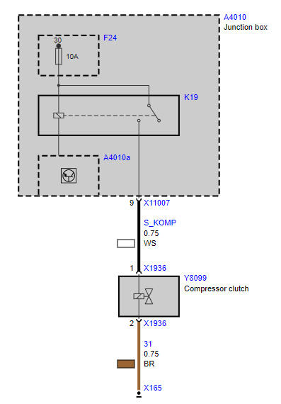

                          Trying to find time to drive the car a bit, and diagnose the AC issue before I do a 7 hour drive in this car on Wed. Hoping it's something to do with the wiring for the compressor clutch, as that's the only thing I touched (other than the evaporator when I was installing the FMIC, but I don't know how I could've done anything to that...)
                          No power to the compressor connector (X1936-1) when AC is on. Suspected I messed up a wire trying to get the FMIC coupler installed.
                          Guess I'll figure out where that wire goes before I cut all the insulation off:
                          A4010 is the junction box behind the access panel in the passenger footwell.
                          No power at X11007-9 (Front edge, middle connector, white wire)
                          Fuse 24 in this panel has power.
                          So something is wrong with one of:
                          K19 Relay
                          IHKA
                          Or some input to the IHKA (bad sensor, low refrigerant, some other error)
                          Not super pumped.
                          Just checked and there's no line pressure, so definitely a leak somewhere. ​​
