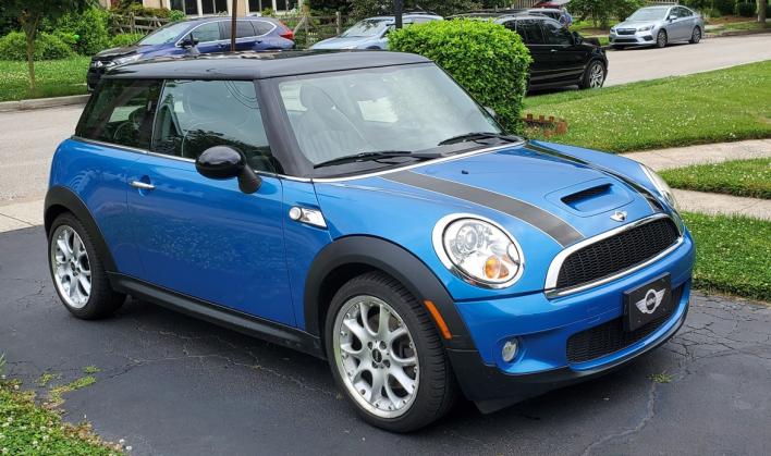

    A bit out of order, but some other pics from this summer:
    A basic pic a day or two after the first wash.
    This piece was missing since I bought the car. It came with that first parts order, finally installed with clips from the junkyard.
    Rear badge was rough, and can't seem to find just the mini logo as a sticker unless it's in a weird colour and from ebay/amazon.
    A beaver had clearly removed the badge to plastidip at some point and reinstalled with JB weld, so I used an Olfa blade to shave off the JB weld and a touchup pen/clear from the dealer to fill the chips. Some wet sanding/polishing turned out alright but still a few spots clearly touched up...
