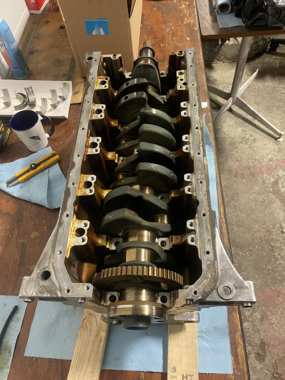

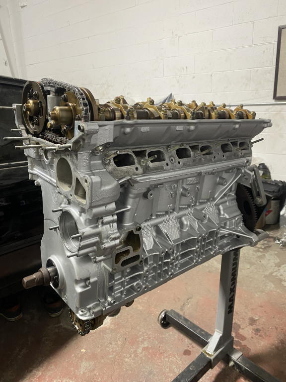

        Started reassembly of the head! All new valve stem seals, lapped the valves, cleaned everything up and reassembled.

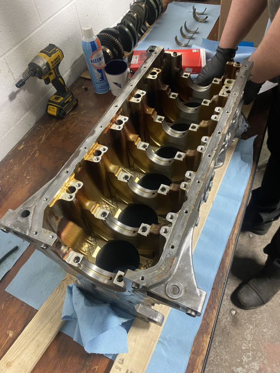

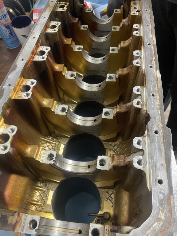

        Block was cleaned as much as possible

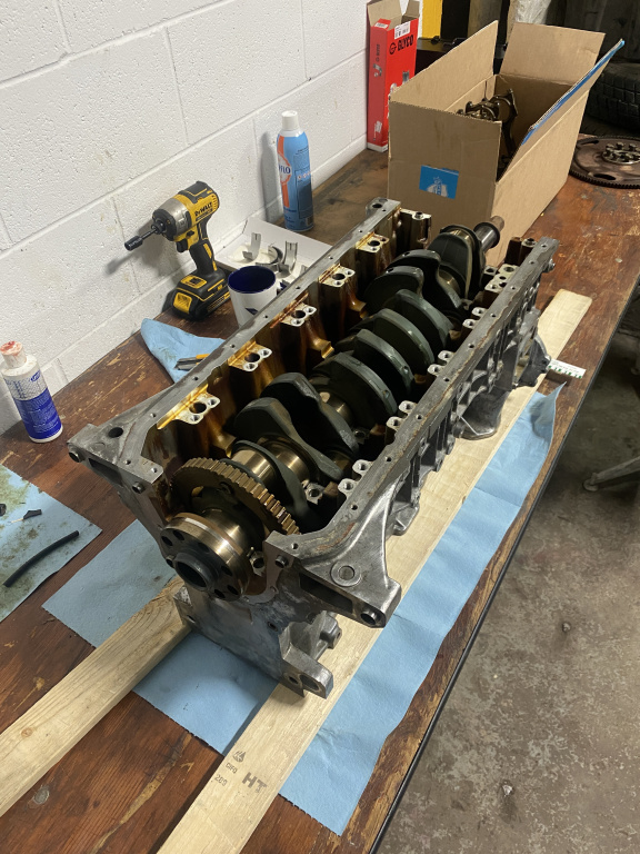

        New bearings and OEM hardware, crank back in

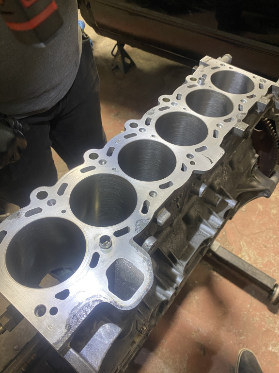

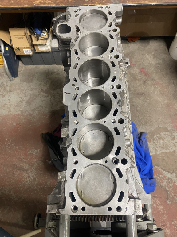

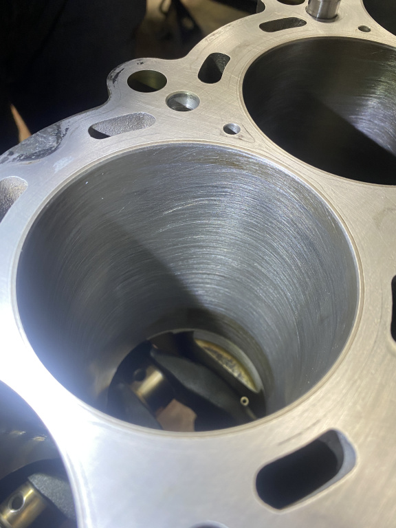

          Honed cylinders, ready for reassembly!
          Nice cross-hatching

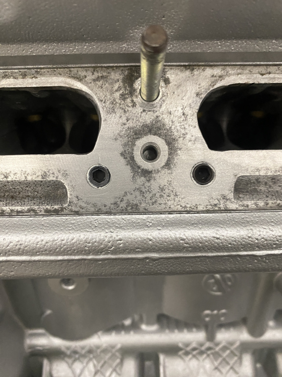

          A/C Delete Plug from Falk Manufacturing. Really need to clean this fresh paint soon..

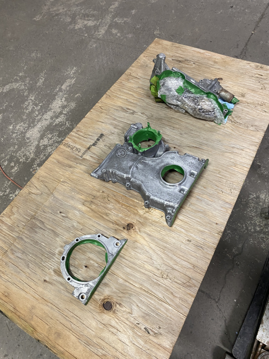

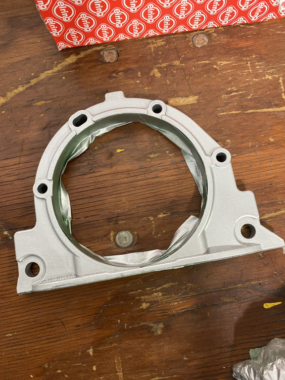

              Crank bearing gets a fresh coat of paint as well

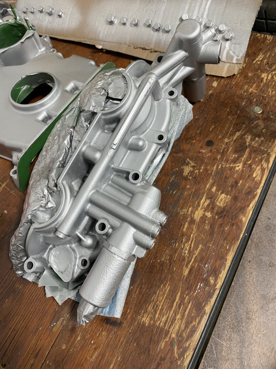

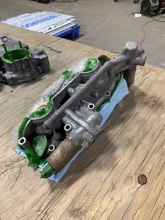

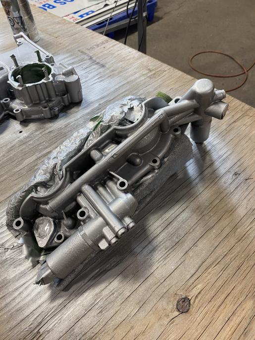

              Vanos unit looking way better

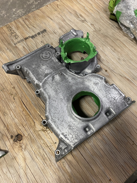

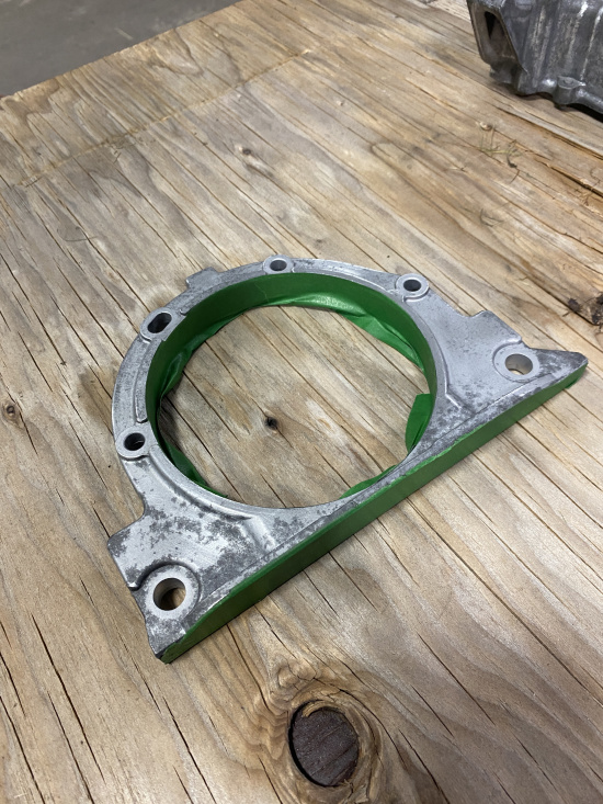

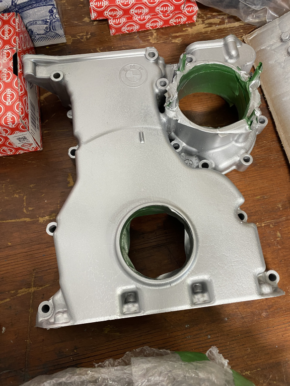

              Timing cover fresh and new
              Rear main cover freshened up as well

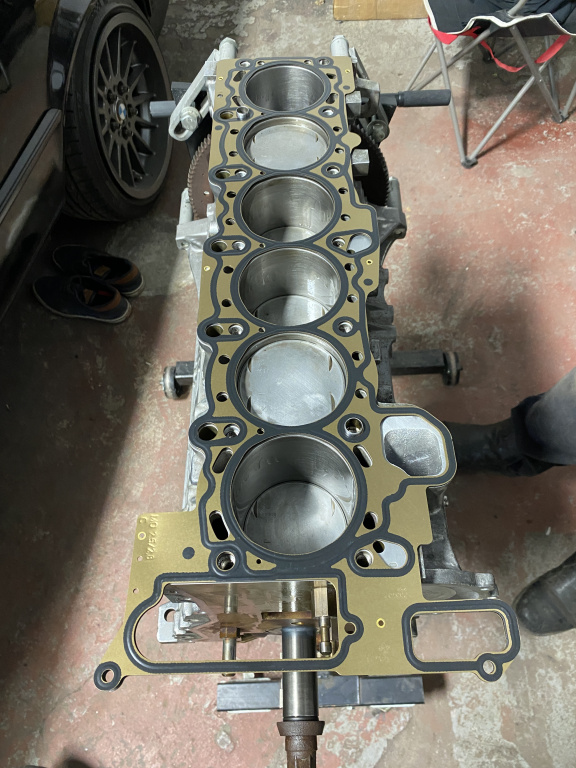

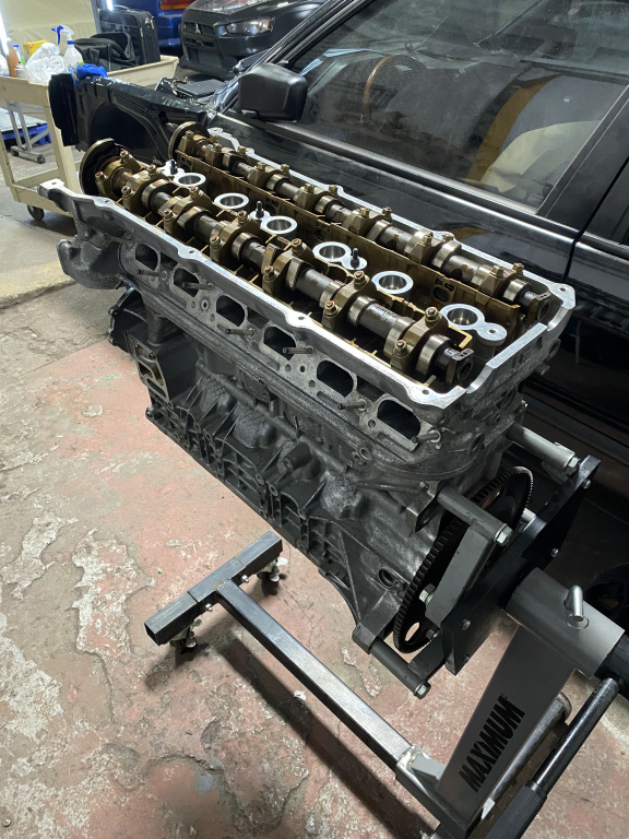

                New Elring headgasket

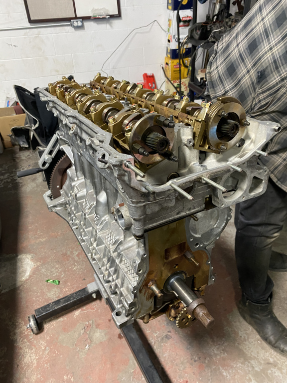

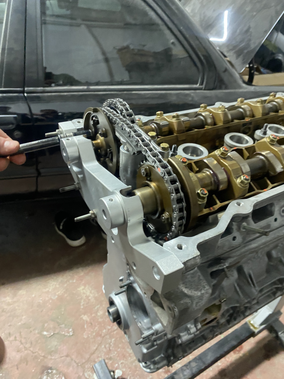

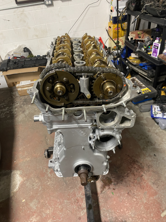

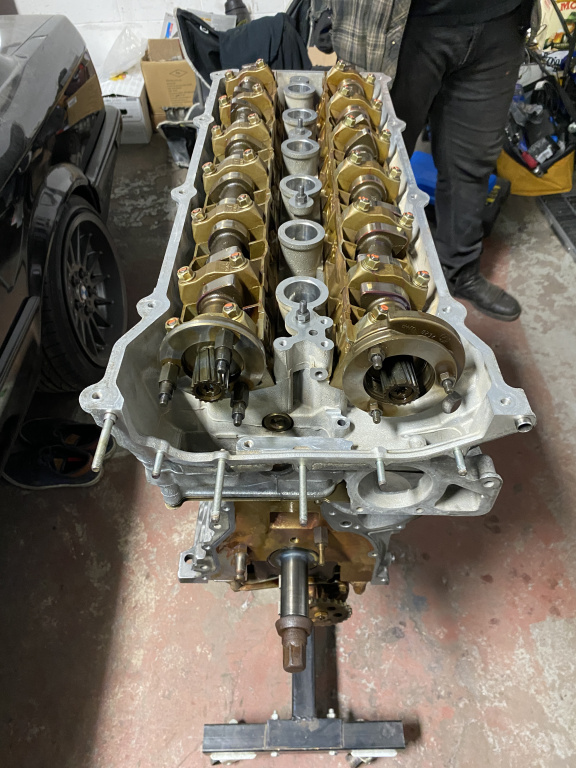

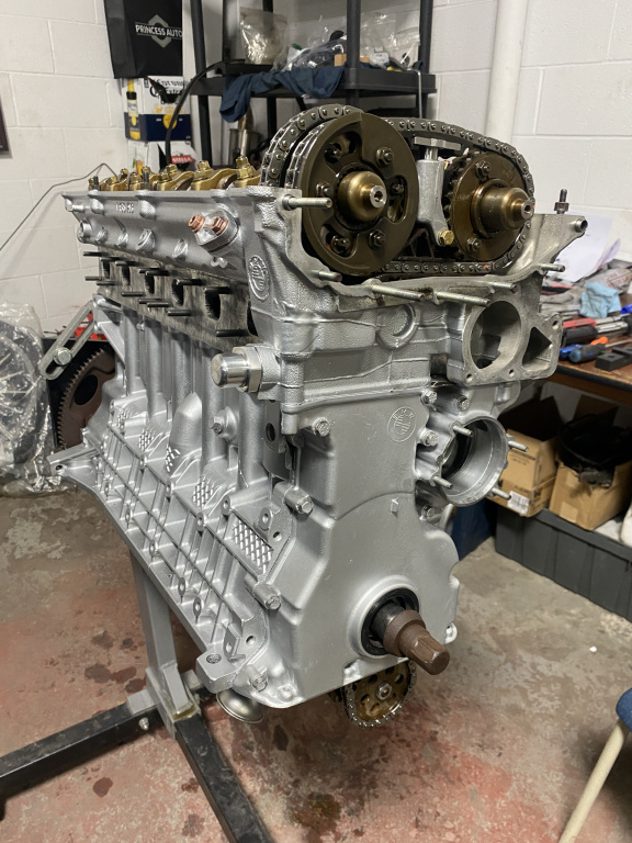

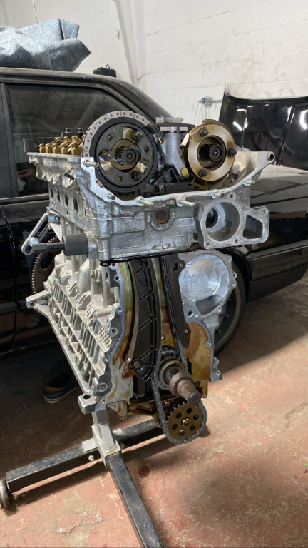

                Head back on, Timing coming together
                Took a few times to get the timing right!
                So fresh and clean

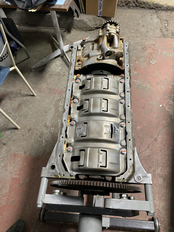

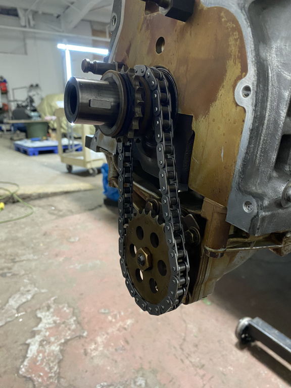

                  New Oil Pump Chain

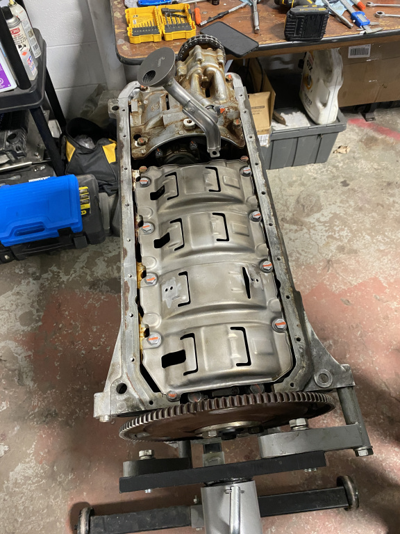

                  SAP Port Blockoff Plate
                  E38 Oil Pickup Tube installed
                  Bought the Vanos /timing kit on amazon and very satsified with the quality!

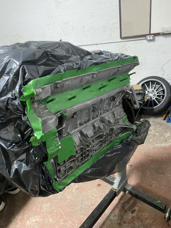

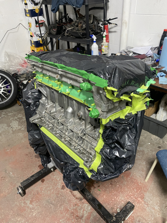

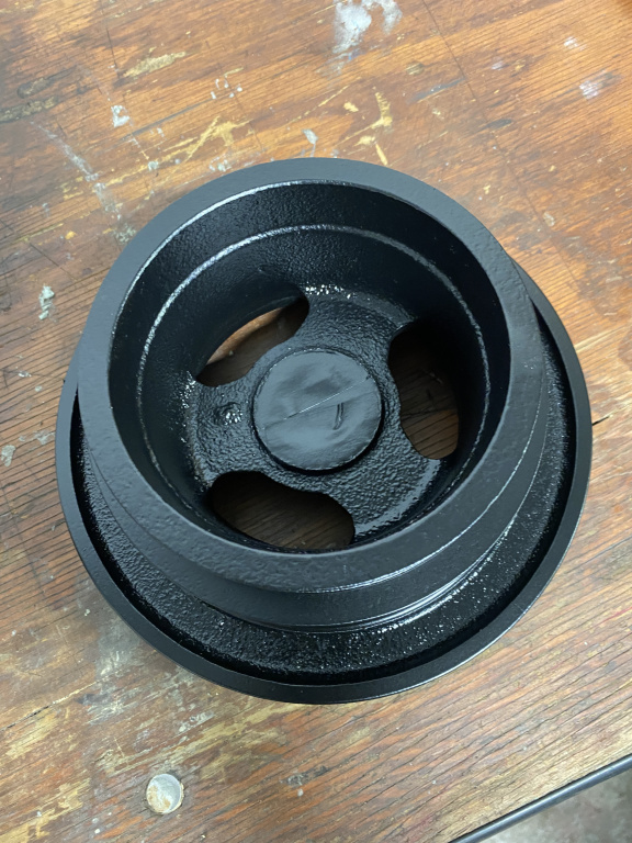

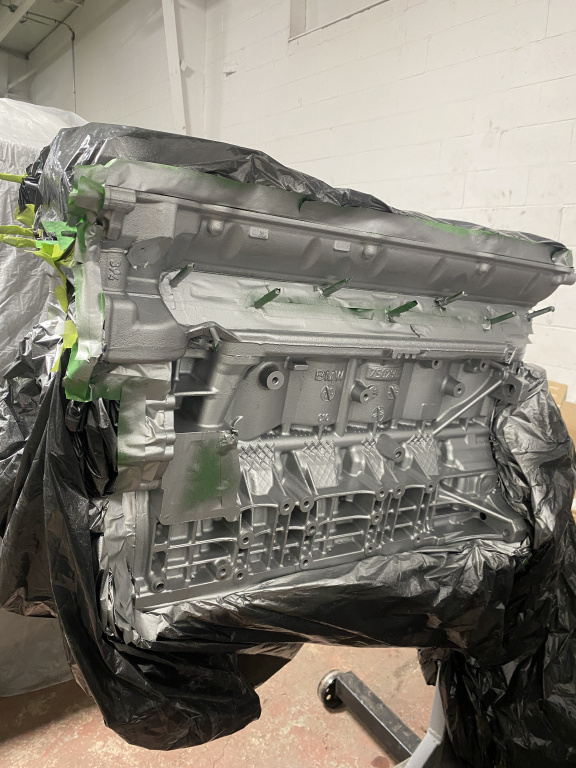

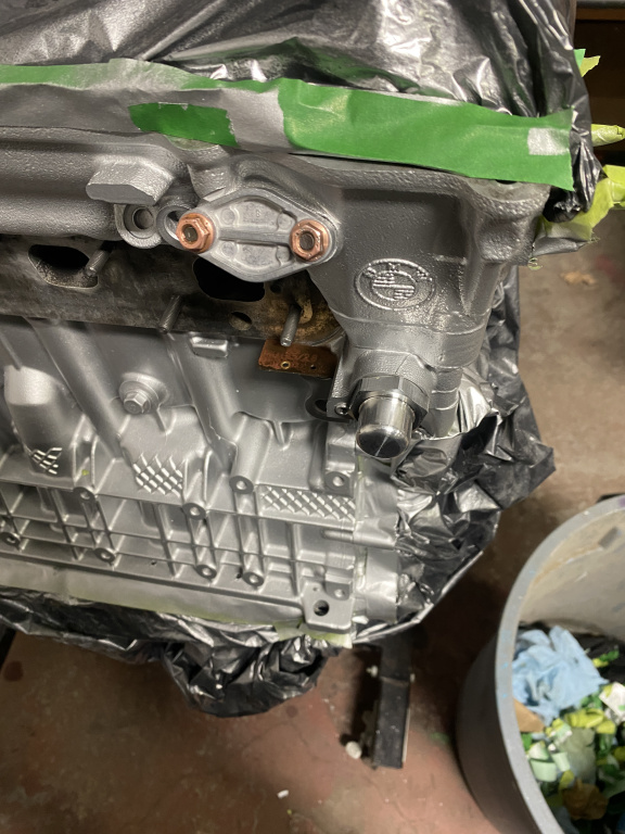

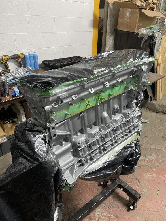

                    My OCD kicked in once again. Couldn't stand putting the motor in looking like this
                    Ignore the tape job, I did with what I had left :P
                    1st coat already so much better

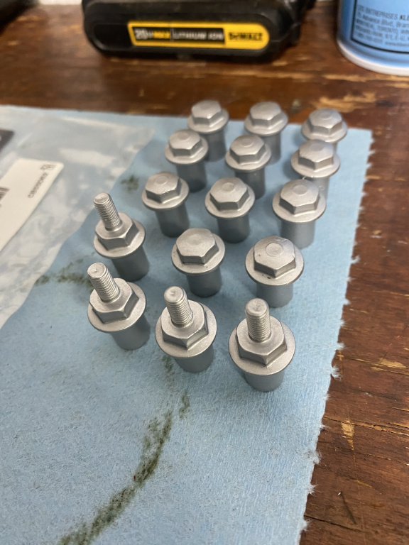

                    Valve Cover hardware gets a refresh too!
                    MUCH better

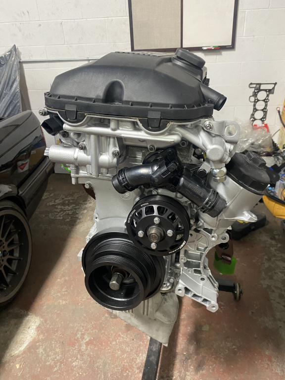

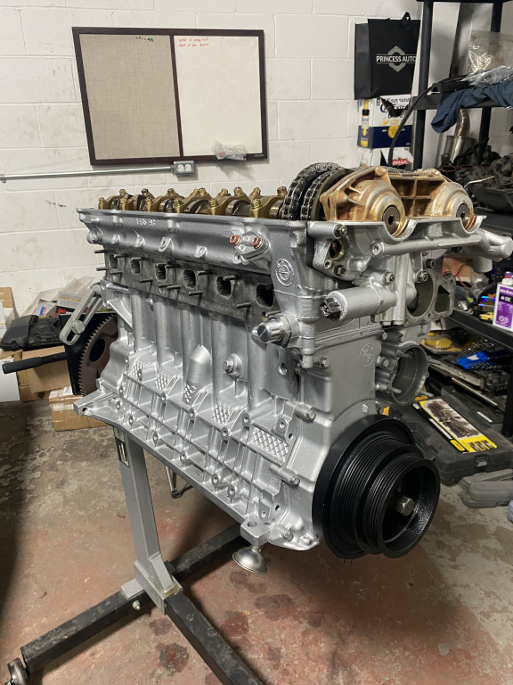

                      Timing cover installed. Engine looking soooo fresh
                      Worth the effort!

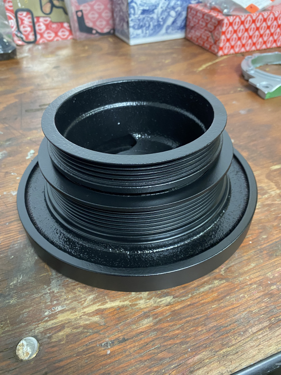

                        Crank pulley installed, and torqued to 302 ft-lb
                        rebuilt Vanos unit installed

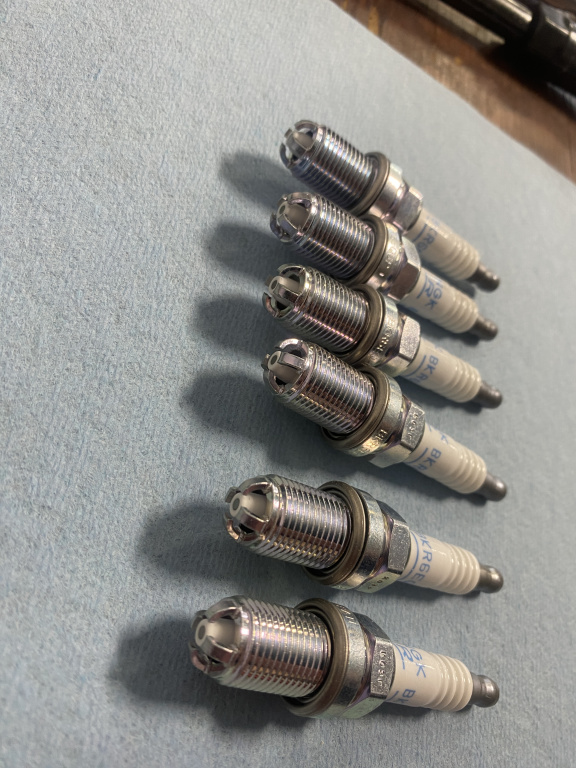

                        New sparkplugs to go in

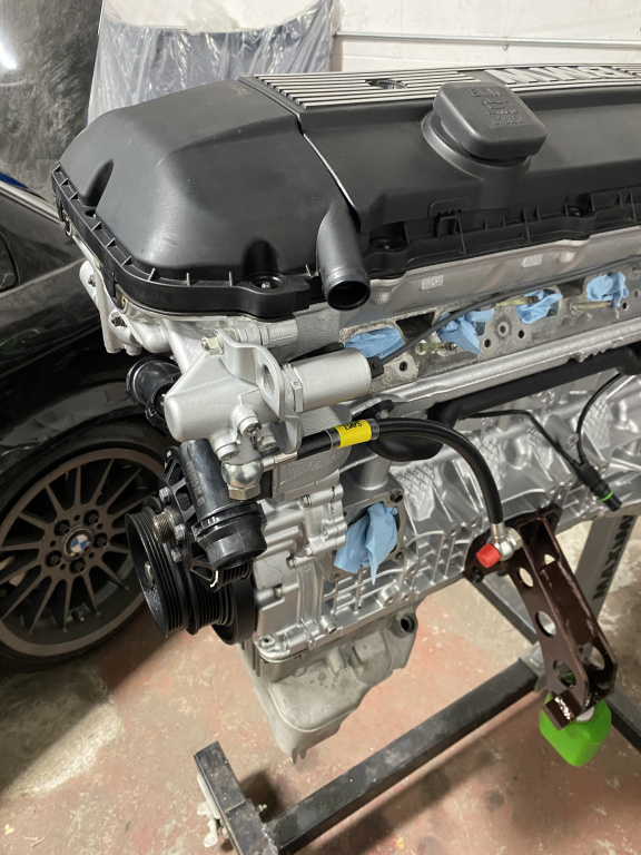

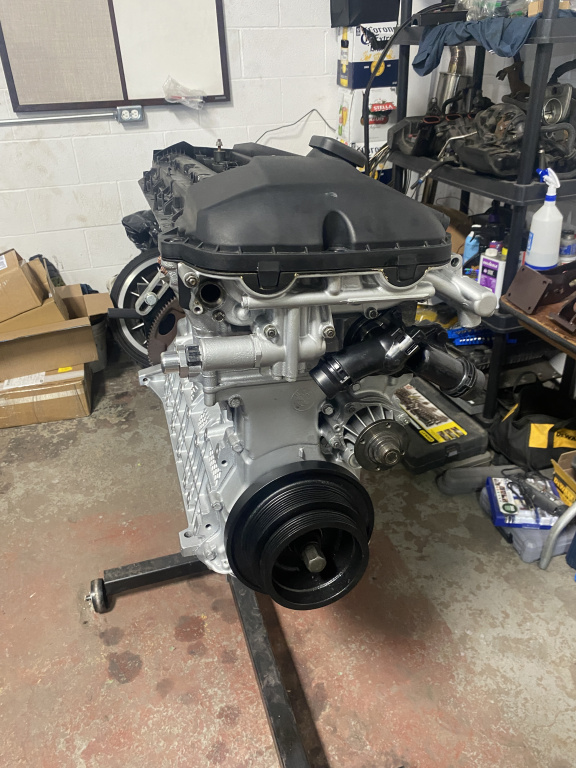

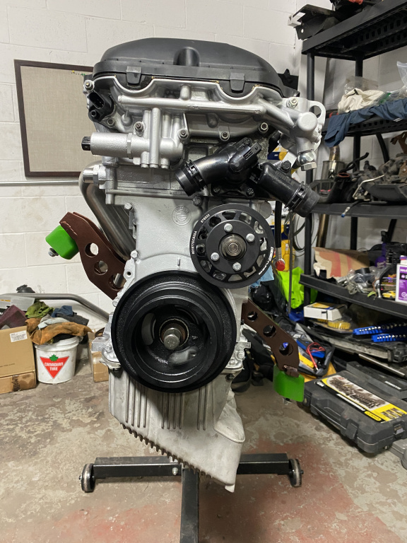

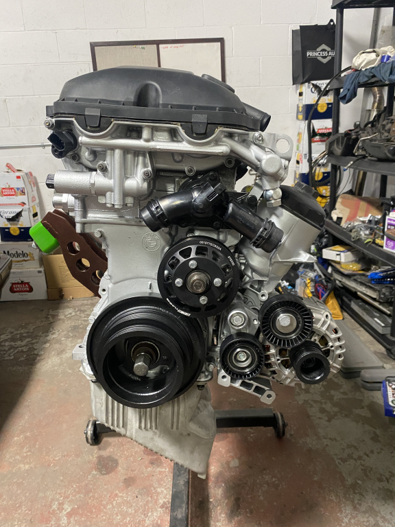

                        Valve Cover, new Thermostat and new OEM waterpump

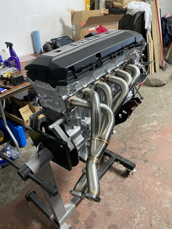

                        ECS aluminum Waterpump pulley, powdercoated engine mount arms, new sensors, new OEM heater pipe

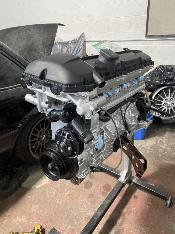

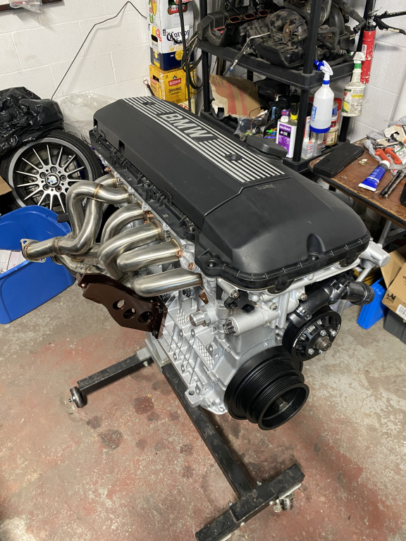

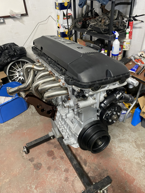

                        ActiveAutowerke headers fitted and looking AMAZING
                        1989 BMW ​325i - M54B30

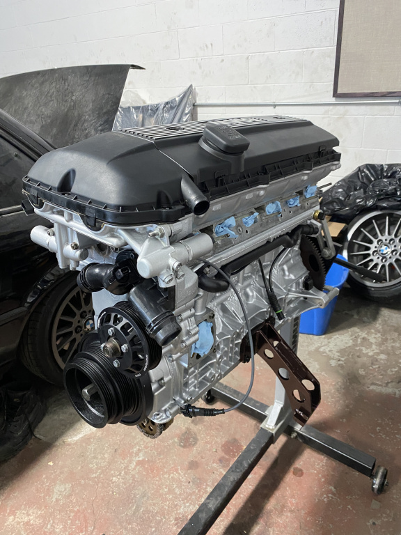

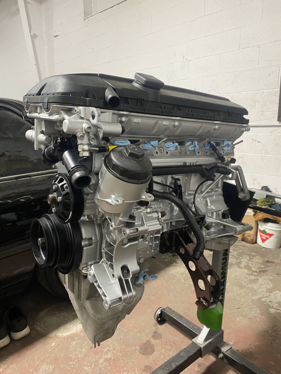

                          Looks factory fresh with beauty cover
                          Way too excited to see this in the car!

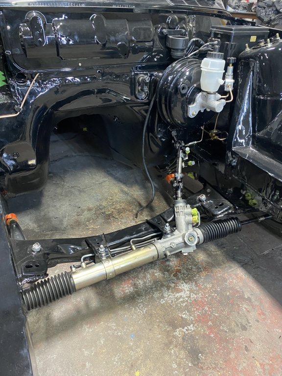

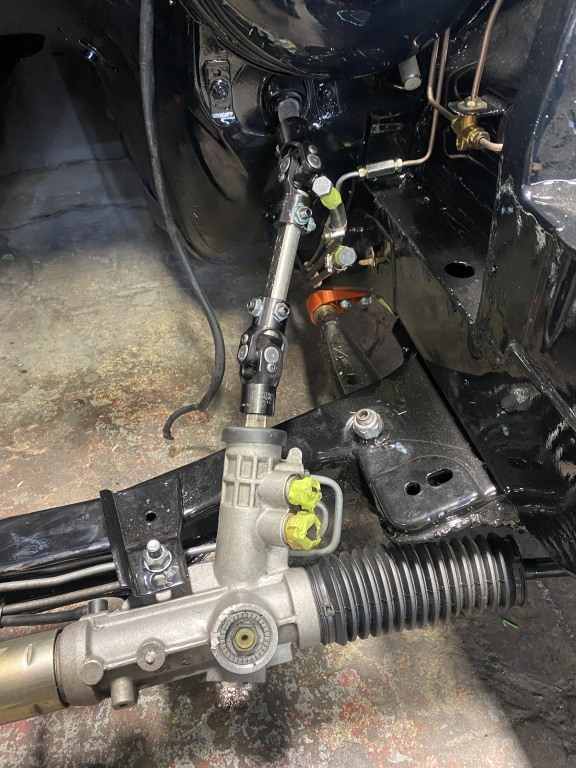

                          My steering linkage had a loose in it, so went with the CondorSpeedShop linkage! feel super smooth, and that means steering is officially done!
                          Love seeing parts going back and finishing off systems
                          Suspension, Brakes and Steering all done now!

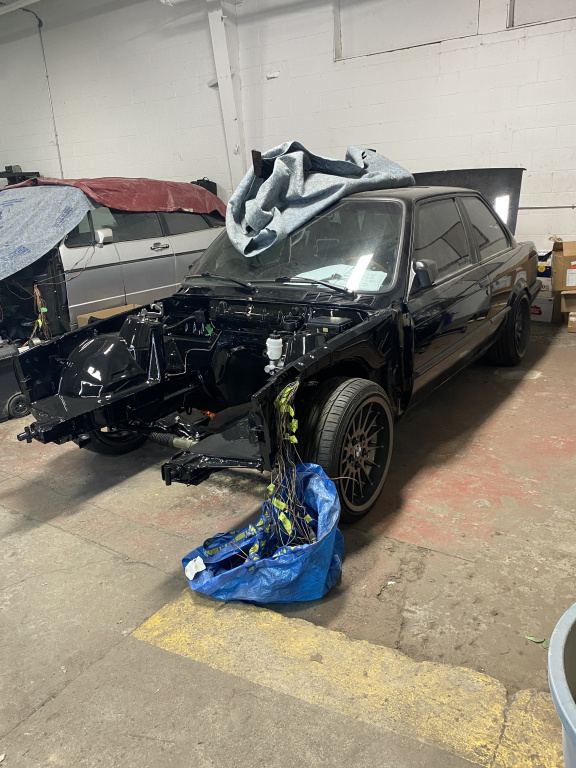

                            Back on 4 wheels and can actually move it around and steer now! That's an accomplishment in my book

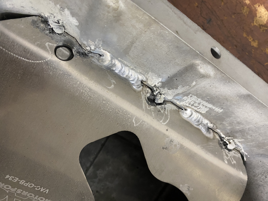

                            I received the E34 oil pan with the VACMotorsports baffle already welded in, but as you can see the welds were horrible and actually loose.
                            Got my buddy to weld it in properly so it's solid

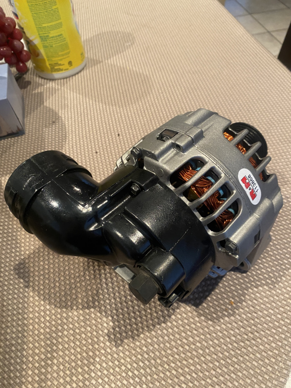

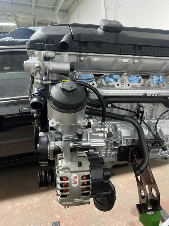

                            Rebuilt alternator to go with the refresh vibes

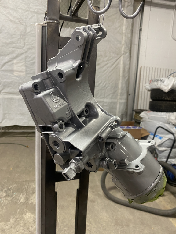

                              Oil Filter Housing gets a coat obviously
                              Matches the engine, we can move on!

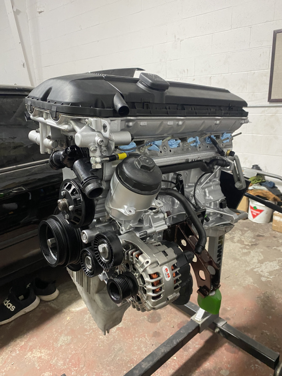

                              Starting to look pretty complete

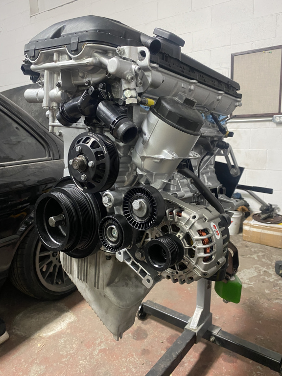

                                Belt tensioner, idler pulley, alternator installed
                                just missing the power steering pump bracket to be able to install the pump and belt!

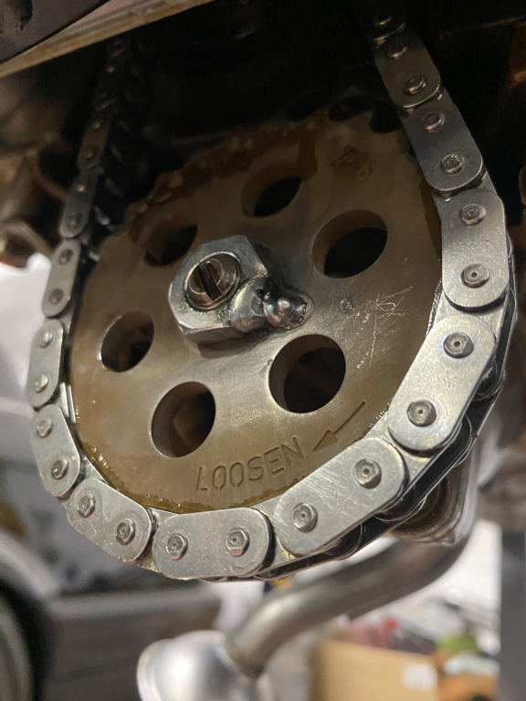

                                Oil Pump Nut welded on
