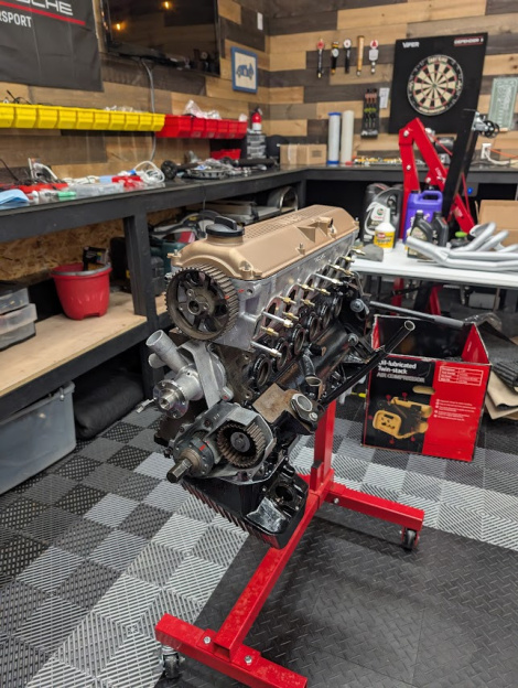

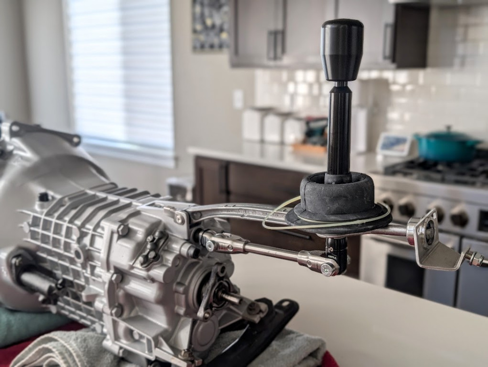

    I wasn’t really feeling like spending time in the garage last night, but a few parts showed up late, and, well, necessity is the mother of kitchen mechanics. So, there I was, doing transmission work at the kitchen counter. I replaced all the seals and installed some Garagistic shifter parts—because who needs a charcuterie board when you’ve got precision components laid out instead? Everything turned out great, and I’m pretty sure this setup is going to feel amazing when it’s all back in the car. (Bonus: my kitchen now has the faint scent of gear oil. Very classy.)
    On Friday night, a friend stopped by for some car work, but the real highlight was the BMW M-inspired coaster set he 3D printed for me. It’s wild what people are doing with 3D printing these days—functional, creative, and just nerdy enough to make me wonder why I don’t own a printer yet.
    Oh, and speaking of wild tech, we also tried out his new Quest 3 VR headset. After a few minutes of stumbling around and flailing like I was being attacked by invisible ninjas, I’ve decided that maybe VR isn’t my calling. But hey, at least the headset survived, unlike my dignity.

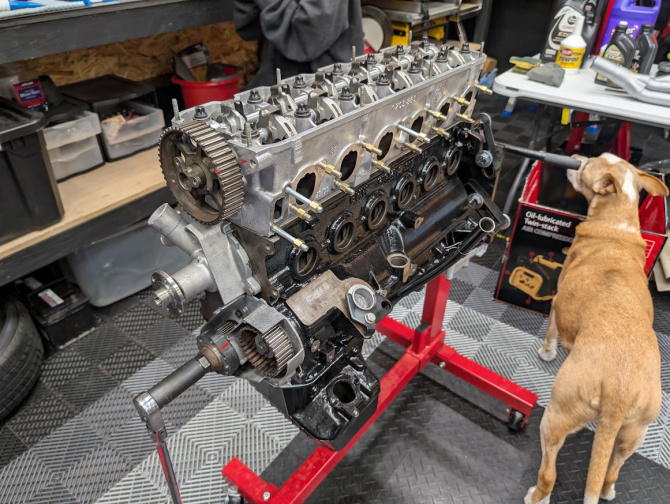

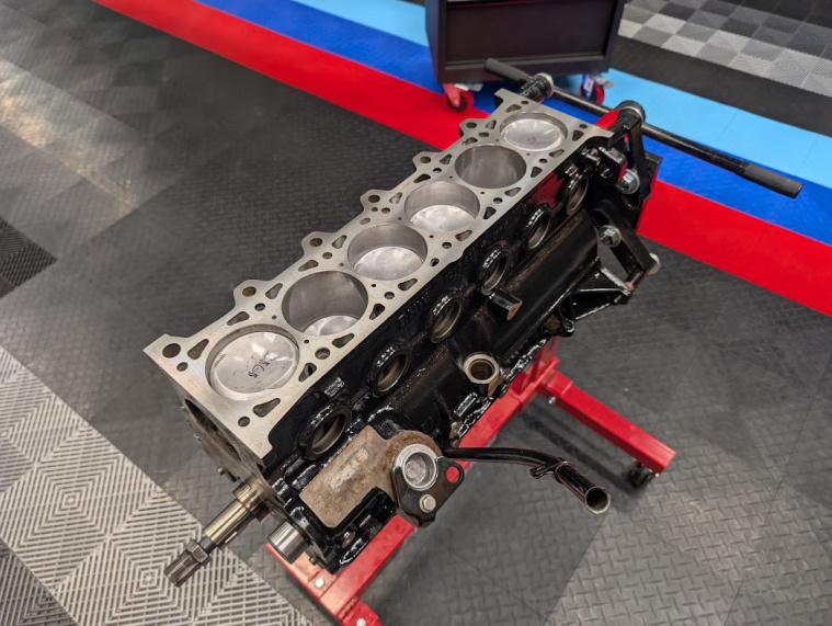

      Put the rotating assembly together a few nights ago. Here are a couple pics and video of the shenanigans:
      5 likes, 0 comments - jondanzl on February 2, 2025: "Rotating assembly complete 💪🏼 @lilbray".

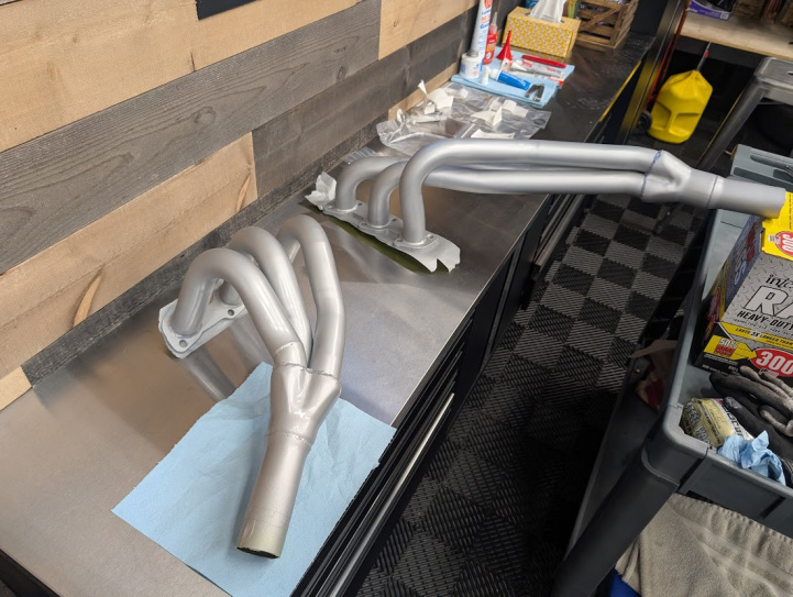

          #64

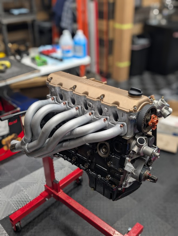

          After searching for over a year, I finally found a set of IE long tubes pop up on ebay, so I wasted no time submitting an offer and securing them. I received and got them cleaned up yesterday. Excited to have finally found a set and hope they fit well!
          5 likes, 0 comments - jondanzl on February 13, 2025: "@iemotorsports long tubes got the royal treatment tonight. Been hunting down a set of these no-longer-available headers for over a year!".

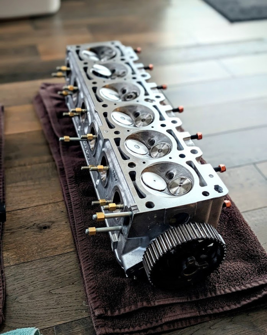

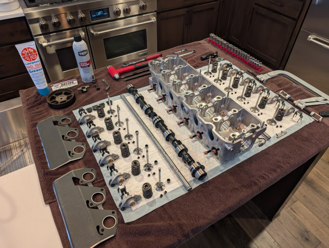

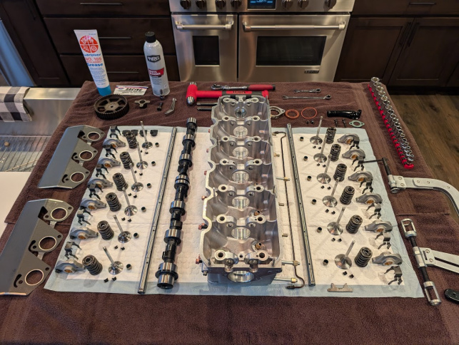

            I got the head assembled yesterday and wanted to share a quick warning for anyone replacing their rocker shafts, like I had to. The Ireland Engineering shafts seem to be slightly misaligned compared to OEM. The retainer grooves are just a bit off, which causes the rockers to sit slightly off-center on the springs and cam lobes.
            We were able to make it work by carefully bending the retaining clip, but it’s definitely not ideal. What’s odd is that when looking at the shafts directly, they appear to align, but it’s almost as if they’re not quite long enough, which shifts the retainer groove positions.
            I think everything will be fine, but I wasn’t thrilled with the fitment. Just something to keep in mind if you’re planning to install these!
            Sepcs are:
            IE HD rockers
            IE 272* cam
            Upgraded Intake and Exhaust studs / nuts
            Machine shop cut the valves
            New seals
            Reused stock springs and collets
            New freeze plug in the head
            New cam seal and o-ring

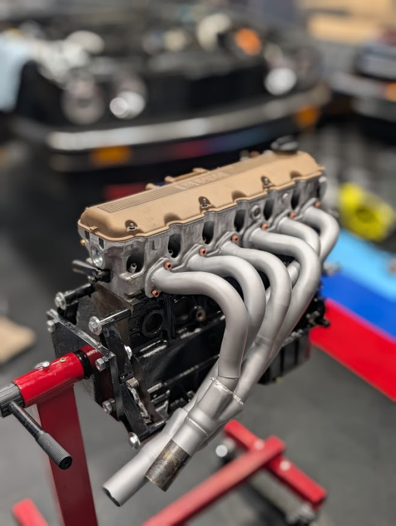

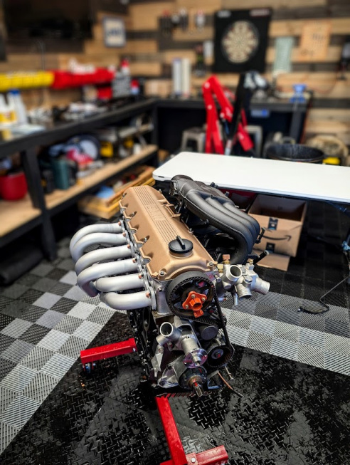

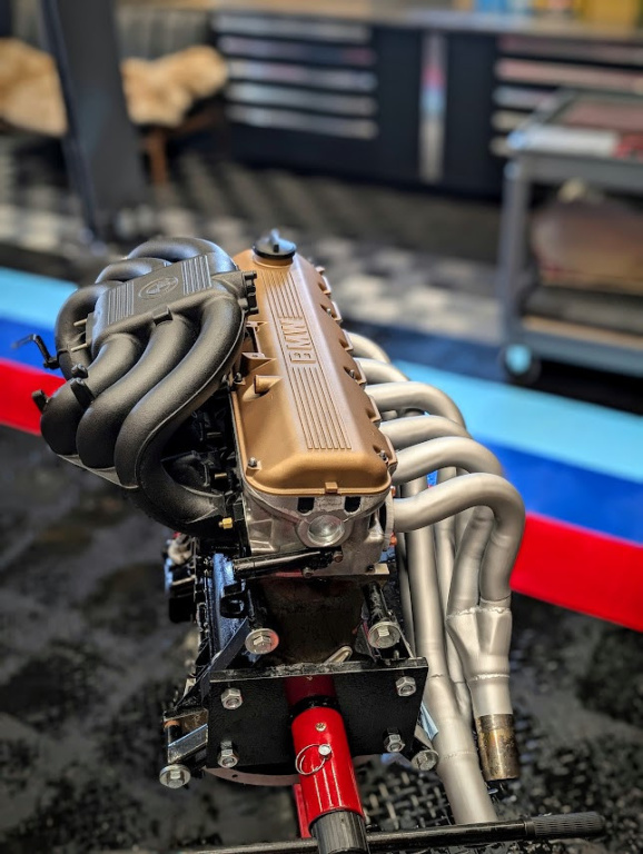

              #66
              Build is really coming together. I got my valve cover back from powdercoating and got head installed last night. The IE headers were nearly a perfect fit (so far), just needed to enlarge 2 of the manifold stud holes since I had replaced them. Really happy with how everything is going so far!

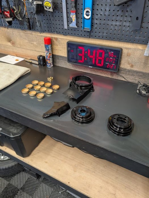

                    #69

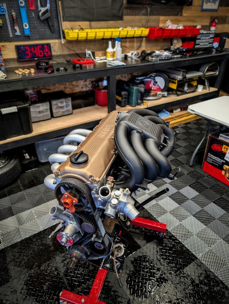

                    No video today but a few pictures. I got the intake manifold and strut bar back from powder coating. I went simple with a slight textured black, but like how it turned out. I am getting pretty close! I think I'll be ready and waiting on ECS tuning to get the Turner flywheel back in stock. My order is in, so I'm just waiting for it to ship at this point!
                    Timing cover is painted and Ireland Engineering sent me the correct freeze plugs after originally sending the wrong set.
                    I have the intake manifold and headers mocked up for the pics, but not permanently installed yet.
                    Getting close!

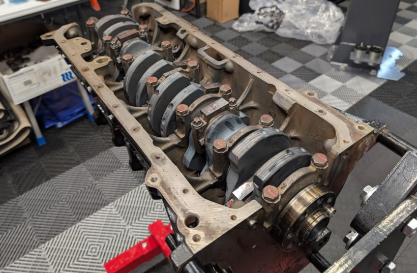

                      Those stamped intermediate gears are known to fail. They updated them to a sintered setup later on but there is a dowel or something you also need if you convert IIRC.

                          would you mind elaborating? Are you referring to the Intermediate shaft gear? Replacing anything right now is much easier than after the install, so I'd love to do some research on what you are referencing!
                          edit* Found some info here: https://www.r3vlimited.com/board/for...e-gear-failure
                          It looks like the updated gear is physically larger, or maybe that's just an illusion. Is the same size timing belt used with the updated gear?
                          edit again - looks like same size, same teeth. UGH!! I guess I need to consider upgrading while I'm at this point. Just don't want to tear everything apart to get to it :(

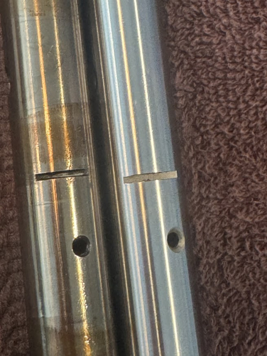

                          • m2d2
                            • May 2023
                            • 98
                            #73
                            Ok so looking at this picture, it appears I have the newer style sintered cam gear, but the stamped IMS gear. The IMS gear would be fairly easy to replace, just requires ripping the front off and retiming everything. Not that bad. I'm reading there are mixed reviews about reusing the stock washer since there isn't a dowel on the upgraded sintered gear for the washer hole, and it requires a shorter bolt. Is that correct? Reuse old washer as a spacer with a shorter bolt?
                            Click image for larger version  Name:	PXL_20250218_012403493.jpg Views:	0 Size:	173.8 KB ID:	10135484
                            • Northern
                              I like cupcakes & sh!tboxes
                              • 5265
                              #74
                              The cam gear was superseded early in production, but for some reason the intermediate gear was later.
                              There are probably a bunch of cars that are surviving just fine with it, but for the cost of a rebuild I think it's worth swapping out.
                              I guess it's the bolt that's different? I did it for my iX a long time ago but have no memory of doing it - I don't think I changed the bolt and just flipped the washer.
                              Originally posted by priapism
                              Originally posted by shameson
                              • m2d2
                                • May 2023
                                • 98
                                #75
                                https://www.rtsauto.com/e30-m20-ofte...sprocket-gear/
                                Thank you for the advice. I tore the front apart yesterday (it actually only took about 10 minutes, give or take) to get to the IMS gear. It seems to be in good condition, with no rust, but for a $30 part and a week's wait, it is not worth risking a new build on a stupid failure point. I did a ton of research yesterday about reusing the washer and the different length bolts.
                                *EDIT* The current bolt is approx. 35mm (approx. 1 3/8"), which is longer than the recommended and NLA bolt for the new sintered gear. So I need to source a shorter bolt for this, though I've read both bolts can be used successfully? From my understanding, I use the new sintered gear's dimple into the IMS hub, and reuse the washer, which now just floats between the bolt head and the gear. I'm glad this was pointed out now, versus later, even though I think the old stamped gear would have been fine for at least a while. I appreciate the peace of mind knowing it is no longer a weak/failure point.
