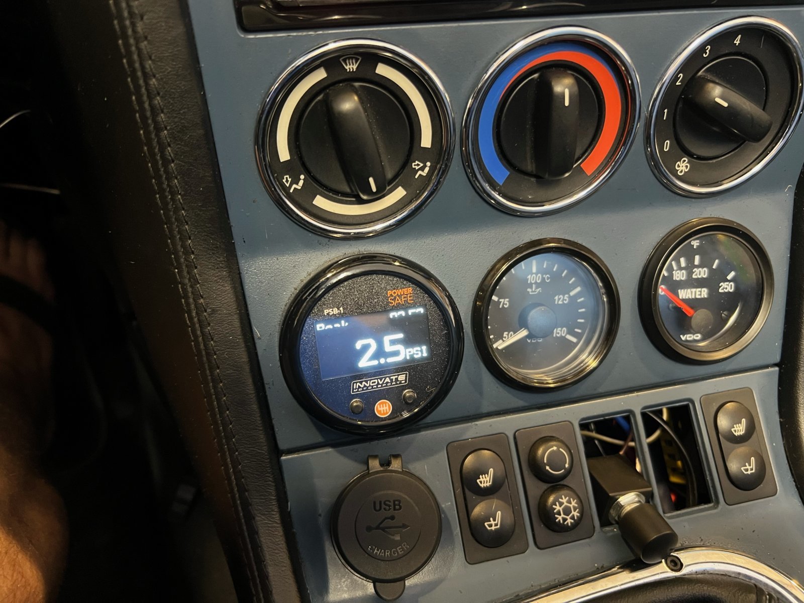

                  #128
                  This happened today.
                  I'm blowing oil from the bottom of the dipstick tube & it's hitting the cat & looked like burning oil, scared me before I verified that was what is happening.

                    #129
                    Thanks to finally having boost, my 27 year old dipstick tube O ring failed & blew oil onto the cat scaring the crap out of me with billowing blue smoke. I cleaned it up & replaced the O ring.
                    So far so good.

                      #130
                      Looks like I blew a cylinder.
                      Did a compression test and am 10 to 15 lbs lower than before the SC ( was 188-195) on the still good cylinders (175-185) but have 125 on 3. Oil on top of most pistons 3 is the worst.

                        #131
                        Another oddity, no blue smoke until temp is at 1/4.
                        Here are the plugs. (in for under 300 miles).
                        [IMG]https://cimg4.ibsrv.net/gimg/my350z.com-vbulletin/550x225/80-parkerbsig_5096690e71d912ec1addc4a84e99c374685fc03 8.jpg[/IMG

                          #132
                          What are you doing for crankcase ventilation?
                          Surprised to see an engine failure at such low boost. What kind of engine management / tune are you running?

                            #133
                            I replaced the "PVC" when I put in the M50 manifold, the SC has it blocked at it's inlet so I think is bypassed. The output that went to it is now running to the intake tube.
                            The bronze is the plug the blue hose used to connect to, the small hose on teh intake is where the blue hose is going & it has a valve inline

                              #134
                              The plot thickens (he said seemingly to himself)
                              It was suggested I do another compression test with all plugs out. Here's what I have: Also, the smoke is worse.

                                #135
                                Can you put PCV into the intake? (VENT)
                                Does the supercharger have a restrictor or need one for the oil supply?
                                If your cylinders are misfiring and have fuel in them the comp test numbers will be low.
