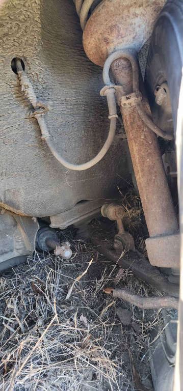

    ​​​​The very next day, As I was driving from an Insurance office to the DMV. I didn't realize that this car had no ABS, It was an early model and therefore as I attempted to brake and downshift from 50-30. My front brakes locked up and I accidentally sent my girl into a curb, Destroying the front right tie rod and my wheel.
    Yeah this wasn't my proudest moment...

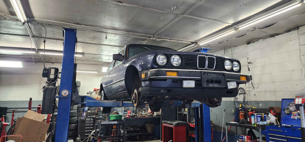

    After waiting for an hour for a tow truck to come and drop my car off at my house. The car was going to need tie-rods and a refresh of the lower suspension components so there it was, She sat in the back of my driveway, Disappointed and ashamed of my actions like a mother who has to ground their child because they broke their beloved vase. Now luckily I didn't give up, Sure it was heart wrenching but I picked myself up again and sourced the parts to bring to my mechanic (No tools to do it myself unfortunately) and eventually I towed her to my mechanic to replace the parts. However as we were pushing the car into the shop and onto the lift, One of the mechanics accidentally ripped off the rear bumper off one of the bumper shocks because he was trying to pull the car by it's bumper.
    Parts Came and was installed:

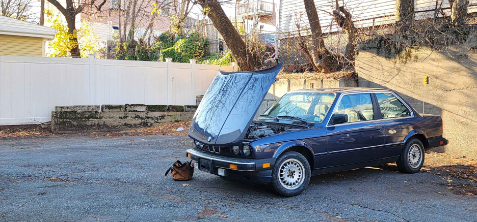

    ​​​​​​Now thankfully we discovered that one of the motor mounts was hanging on for dear life, Replaced and done

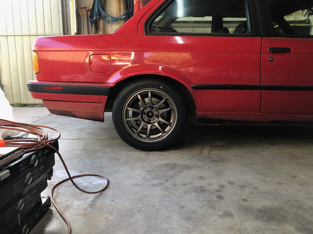

            • OSAH racing
              • Apr 2022
              • 244
              13 LBS designed for the e30. Tire rack

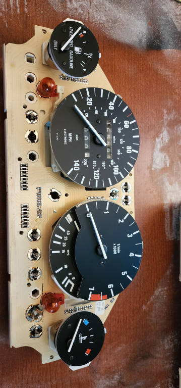

                      Third thing, I deleted the SI board from my gauge cluster by bypassing with a jumper wire along with servicingthe fuel and temperature gauges: Click image for larger version
