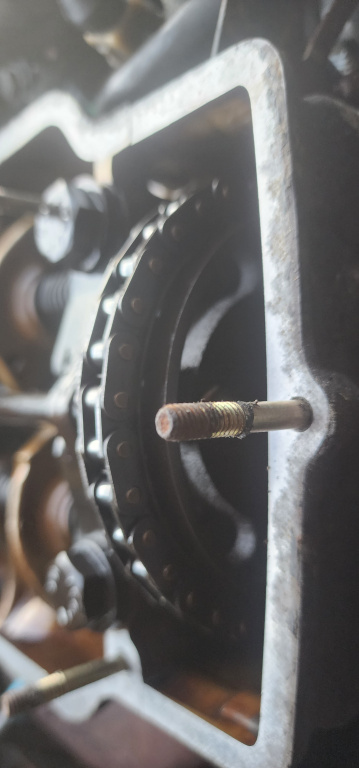

    So it took me two days to essentially figure out the overheating issues were caused by a worn out water pump and that I didn't flush the coolant enough, I will be flushing out the store bought coolant in favor of OEM coolant and replacing the thermostat. I might need to keep the old thermostat just in case the new one turns out to be faulty, In the meantime I also had a look in the valve train to see why my timing chain is rattling everytime i start the car. Click image for larger version

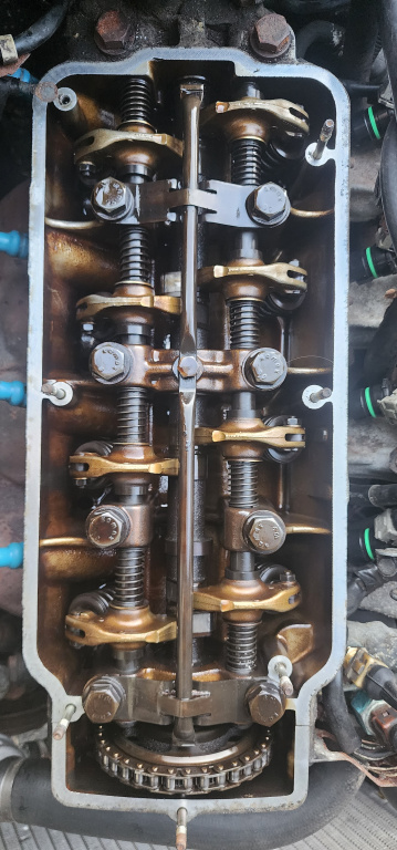

    Every component in here looks like it has normal wear and tear but the rockers are fine and there isn't anything loose. I shined a light down the timing chain and saw that the tensioner was well worn-out at this point. It didn't help that the engine wasn't ran for a month thanks to the ecu fiasco.
ID:	10138295 Click image for larger version
    It was like 6am when i took these photos, However i ordered new gaskets and a tensioner kit plus other stuff so that will be on it's way.

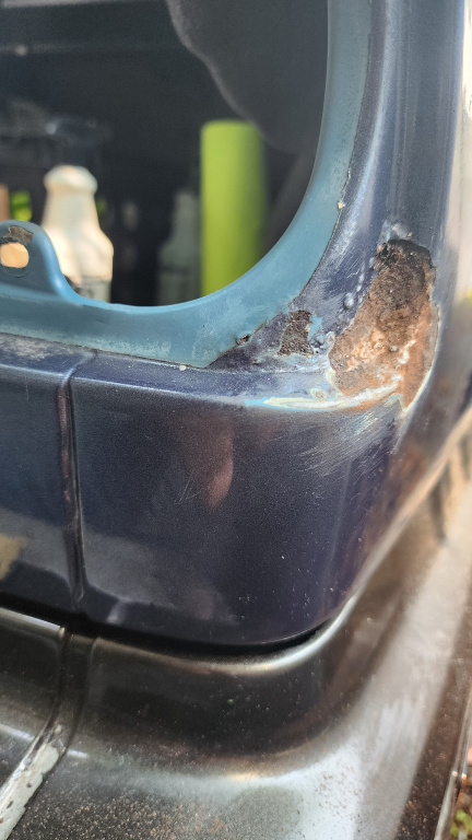

          Time for a long overdue update! In the time between my last forum post and now, I was able to do a few upgrades and start getting rid of rust bubbles on the car, Turns out there's some rust in the inner wheelhouse in the trunk but that's literally all of the rust, this car is 96% rust free for a vermont car which is shocking but thankfully the service records show it was looked after.
          Thanks to the bimmerforums and E21 Community, The first thing was upgrading the radiator to a chevy style 22x19 radiator. Ask yourself why do such a thing? Well because the original radiator finally cracked after I scored a rear bumper for the car. ​ This unit required me to drill a hole for a bracket (Temporary) to mount it correctly along with getting two new hoses for the set up.
          I used a Gates 21630 hose and a Mercedes 280 SL top hose for the set up, If you're looking to do this yourself for your 318i or E21, I highly recommend investing in a radiator with a drain plug but due to budget constraints, I went with the Speedway unit and it works just fine! The great news is that now this car runs a crossflow setup which should dissipate the heat better.
          I also took off the Siezed air conditioning compressor and left it hanging due to having no tools to remove the lines, I'll be taking the car to a shop to have them remove the lines connecting to the compressor along with a regular checkup.

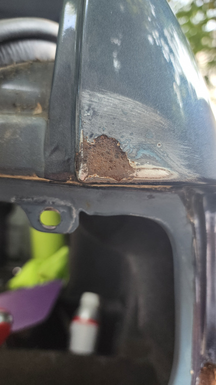

          As for bodywork! I'm no expert but I'm going ahead and reconditioning the metal in areas where bubbles had appeared, Unfortunately I didn't take photos for the first situation during the process but I will once I get the body filler applied and primer set, However I did take photos for the taillight situation, In the meantime I mentioned the bumper which is finally repaired and back on the car properly.

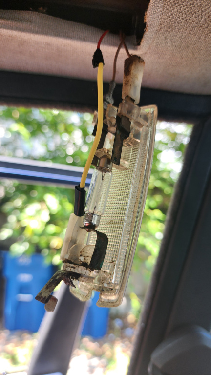

          As for one last thing, I found a pretty disturbing rodents nest in my passenger dome light but the animals are long gone from this car thankfully, I had to repair the wiring but that's it Click image for larger version

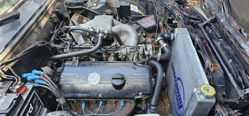

              I plan to head to my first E30 Related show once I can get all of the kinks worked out on the car, Just yesterday she shredded the top hose and popped off the bottom hose so that tells me I still need to do a lot more before she's ready for any trip, Now thankfully the previous owner used a copper pipe to connect two radiator hoses together so I redid that idea for the top hose, I believe the port in the pipe is for a temperature sensor and that's why the temperature gauge is acting twitchy but remains consistent. I basically need to get a expert to help me secure this radiator along with fixing a common oil leak. Click image for larger version

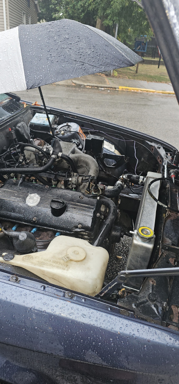

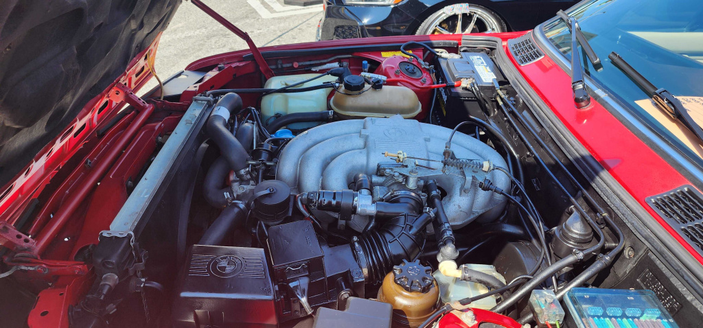

                  Oh absolutely, this is the most recent picture that I have! Haha. Click image for larger version
ID:	10144290 The finest engineering comes to having your Serpentine Belt snap as you're leaving your street. Thankfully it's all good now since I replaced the belt. I got rain gutter clips today as well to fix the dangling side trim!

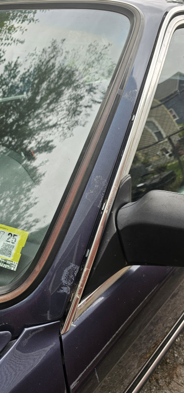

                    Rain Gutter Trim Installed, Tape was there to hold it temporarily but now I'm going to wash her when the weather is better. Click image for larger version
                    • 2mAn
                      Señior Mod
                      • 20764
                      Get some closer pics and take them in landscape, not portrait!...
                      Is there a fan on there?
                      BTW, if you want to add an analog clock to yours, its plug & play and makes a lovely improvement inside...

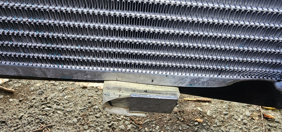

                        Will do so tomorrow! I will be adding a SPAL fan unit onto the radiator once I have some free time from classes, However the good news is that the hose can get extended so I'm doing that first.
                        • BadDays
                          • Dec 2024
                          • 160

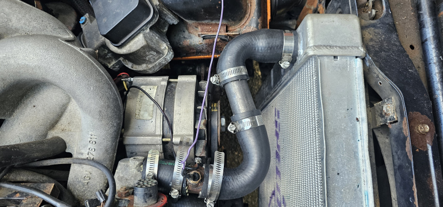

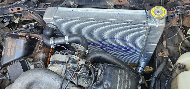

                          Update: Got some pictures since i was busy replacing alternator belts, the cause of these snapping is a stripped bracket that won't let the belt tension properly, I'll replace it as soon my next paycheck lets me do so, In good news! The coolant hoses are no longer contacting the alternator fan so this is the definitive guide for installing the Chevy 22x19 Radiator in your E30 with the M10, By no means am i a professional but this is how i went with the install.
                          You'll need to install a bracket at the bottom of the core support to hold the radiator, Using the original bracket is optional and that's what i went with but i highly recommend you weld it, Self tappers are an option as well. In this case I used rubber pads and tape to secure it to the bracket so the radiator has a cushion. Click image for larger version
                          It isn't pretty but it gets the job done, Next you'll need to aquire two hoses for this setup, The Gates 21630 Radiator Hose for the bottom and the upper radiator hose for a 1968-1971 Mercedes Benz 280Sl.
                          We'll start up at the top:
ID:	10144778 You will need to extend the hose to clear the alternator fan since I tried to do it like the E21 Folks and it only resulted in the hose being shredded in the middle, In this case I used the previous owner's creative idea of a metal pipe and the temperature sensor to extend the hose but if you need dimensions, The 1X1 up to 1x4 1/2 Black Steel Nipple Pipe from home depot will fit with no issues! I also went ahead and reconnected the temperature sensor but you may not have one so it's optional.

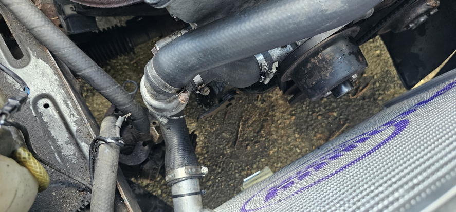

                          For the Lower Hose:
ID:	10144776 The lower hose will need to be cut in half starting at the first bend, MAKE SURE IT'S THE BIG CONNECTOR, You will need to use hot water to shove the hose onto the bottom inlet of the radiator and use a large hose clamp to secure it down, Turn the water pump hose to the other side since the thermostat is now pushed back to clear the bottom hose, However for all of my people with Air conditioning, You will unfortunately have to live without A/C for this setup but remove the air conditioning compressor so you can clear the setup.
                          As for securing the radiator, Make your own brackets or use zip ties if you got them.
                          Finally, Fill up the radiator and check periodically for leaks and low coolant, It takes around 3-5 Quarts of coolant to fill up the radiator and you can use regular store brand coolant. Bleed the system and you're good to go: Click image for larger version
ID:	10144779 Cheers! The next update will hopefully be that I can get more crap fixed in anticipation for a future car show later on in the fall!

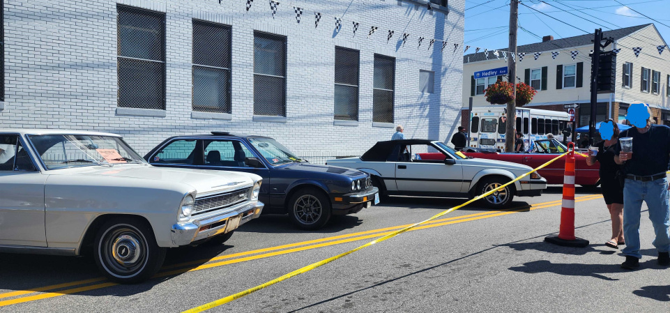

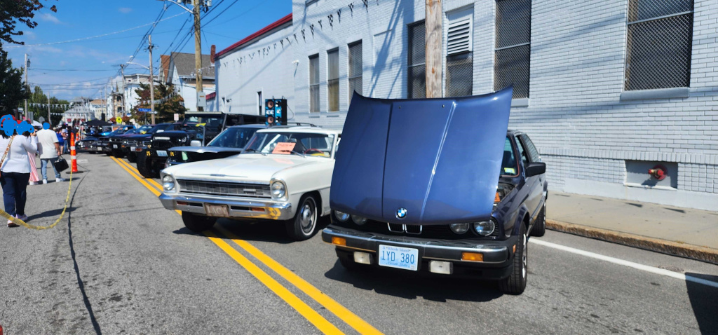

                            Had my first actual car show hosted in my town! There was a another e30 which i had a lovely chat with the owner, However I'm sure I'm going to attend more events and continue fixing issues on this car! (Blurred Out The Faces for their privacy.) Click image for larger version
