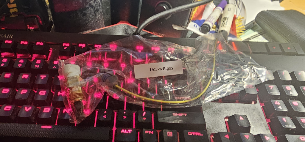

    I have already acquired the first piece of this puzzle, The Air Temp Sensor will allow me to hopefully replace the Air Flow Meter but just in case, I've seen people recommending a Volvo 2.2 LH Mass Air Flow Sensor which could work with my factory airbox, The only thing I need to make is a metal pipe with the sensor included and possibly figure out how to connect it, I'm going to have to chop off the AFM connector and solder in the GM sensor connector if it turns out there's no Direct Plug and Play (Most Likely)
    Anyways this winter time will allow me to research and gather the components to get this ECU swapped and then I can learn to set a base line tune, A Dyno will take over and properly manage the engine for me while I learn about this stuff. Paint is also a another thing that i need to learn and finish on the quarter panel so don't fear, It will be done once the spring rolls around, Also Let's not forget that for Christmas, Santa came down and brought me the two most important components of the build so far. Click image for larger version  Name:	20251226_171804.jpg Views:	0 Size:	212.6 KB ID:	10154068 One Ireland Engineering 314 Duration Camshaft that will need to be tamed to a 304 or 292.

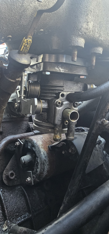

        I'm practically half way through the megasquirt installation as I already wrote up a guide for how to adapt your M20 throttle body to the M10 EFI intake manifold but here's the kicker, I said that you can mount it in the same way that the hoses would go onto the back.

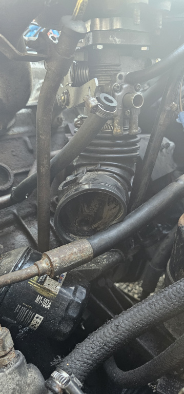

        However After doing this and then noticing that the throttle cable is not functioning properly, I Realized that in order to mount up your throttle cable, You need to have the hoses in the front instead so that the sensor and cable can be in the same location.
        This means that you need to run new heater hoses that can be shoved under the intake boot and then it can be looped to the ports.
        Also by the way, You're going to want to use a thin walled hose because the hose will clash with the intake boot and make it difficult to install properly if you just use a generic heater hose!

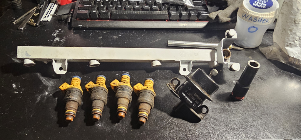

          Alright so here's an update in my standalone installation, I'm all done with the intake section besides a intake tube with the bung for the GM IAT. I have a new airbox that should arrive soon plus the 5/16 heater hoses, Consider it done! The next thing was that I did a night's worth of research to conclude that the Jeep 4.0 Idle Control Valve is realistically the best option but the wells and Niehoff were NLA, To combat this! I went onto rockauto and ordered the closest thing to the DIY instructions for 02again's adapter. The part is called: Standard Motor Products AC151T, One Forum post on Megasquirt says it's better than the wells. (We're gonna test that!)
          For Fuel! I decided to order a used pair of 19# EV1 Mustang Injectors from ebay along with the 3.0 Fuel Pressure Regulator but the seller mixed up the item so for now just pretend that black regulator is the correct one, I will also have to rebuild the 4 pictured ones here along with mix and matching the O-Rings for a snug installation.

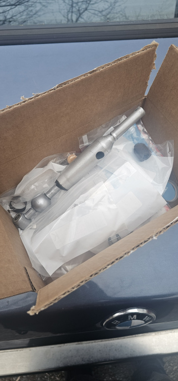

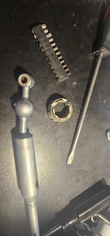

                    I also have this to say! I got the shifter components today and I'm ready to rebuild the shifter but here's a tip for anyone who's reading this and you want to do the 1.9 Z3 Shifter Conversion? Do yourself the favor and buy the $170 shifter arm new because i had a hell of a time dissembling a junkyard one to get the shifter arm, thankfully the bushing is still good so it will only be minor slop which i am fine with
                    That bushing wasn't long for this world!

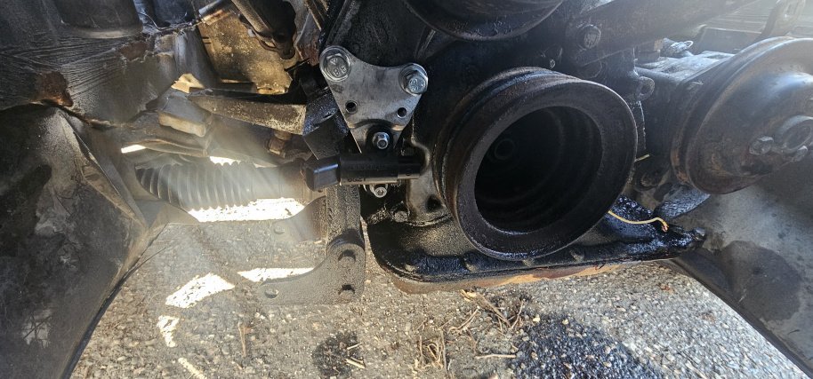

                        Small Update:
                        The landlord is pissed off about my car being disabled in his own words, Never in my 15 years of living in this apartment did i have any problems until the property was bought by a real estate group, This is a small hiccup in the plan but anyways I don't want to burden folks with that mess, Yall come here for my car and not the craziness that happens outside of working on this thing but essentially expect the photos that may be used in my guides to be in front of my house LOL.
                        The crank position sensor finally arrived and guess what? I have finally americanized my E30 with ford, gm and Jeep! In all seriousness the crank sensor was bolted on and now that's all left to do is have the pulley machined to accept a 36-1 wheel, The exhaust will be reinstalled with the stromung exhaust attached to the original cat and downpipe since i am too cheap to actually make a custom down pipe for myself, The ECU will be bought once I get the pulley machined and the ignition components installed. Click image for larger version
                        I am almost done with this! That Coil Based Dizzy will be made at some point when my PC is back up and running, for now? That'll do it for this update. Cheers

                          You're going to love the Z3 shifter conversion. I ran that in my E30 for quite a few years.
                          Adds some notchyness without getting too crazy.

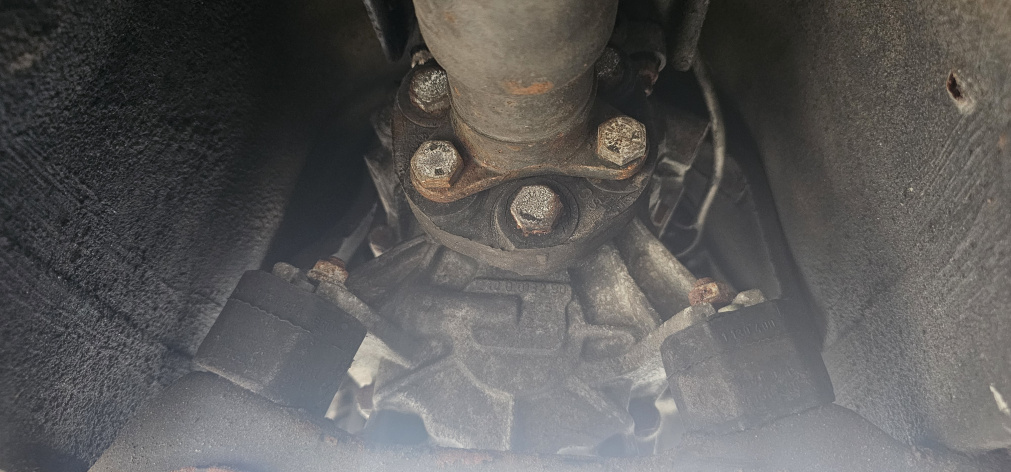

                              Indeed it is awesome! I got it installed and man does it feel great for a M10, I really want to release the guide but I ran out of time and my motto as a writer is: "Don't Halfass it unless you know it's terrible" All 318i folks with M10's need a short shifter but my positives turned into ridiculously complicated BS, The buffer stop was a real pain in my ass to install considering there's a piece missing and trying to secure it was like wrestling with hulk hogan who keeps dumping rust and dirt into my eyes despite the PPE! However that's nothing compared to my driveshaft nonsense! Long story short she'll never go in properly again due to someone else putting the bolts incorrectly
                              WHO THE FUCK INSTALLED THE BOLTS BACKWARDS?
                              I tried for 2 hours to get the driveshaft compressed enough to get the bolts in and the nuts secure but unfortunately no matter how much shoving and swearing I did, the bolts wouldn't pass the transmission flange enough to show the threads, Though the smart thing to do was remove the driveshaft all together and reinstall from the front? I realise that I did not wish to open that can of worms considering Poverty Tour was in 2 months and my budget was solely focused on getting it running and driving. Here's what I'm gonna do!
                              M10x1.5 60mm Bolts will replace the original 54mm as a temporary measure until I can address this driveshaft nonsense properly, Yes it will suck due to vibrations and eventually bolts coming out but I will keep spares just in case.

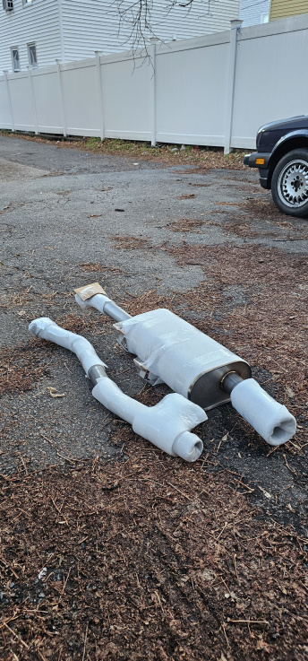

                              Other than this nonsense, I managed to secure a deal to get my exhaust repaired and have the flange modified for Stromung's M42 exhaust, The ecu will eventually come in and I can begin making a proper wiring diagram, I will bite the bullet and use a underdrive pulley from ireland engineering due to time constraints but thank god it's almost over, I got all of the intake parts but the new pipe doesn't fit the original airbox so that will be modified accordingly and as for cooling! M42 Radiator with the auxiliary fan wired on high once I get it running and dialed in! Phew! That's it for this one, I agree with you two, This shifter will make my E30 feel more playful vs rowing a OBS Ford shifter. Cheers!
