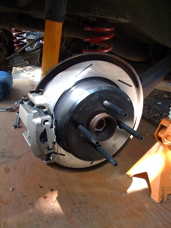

              Here is the only pic I bothered to stop and take all day on Sunday.
              It looks so minty fresh!

                Nice! I'm running non-vented at the back, too (blanks, not drilled or slotted).

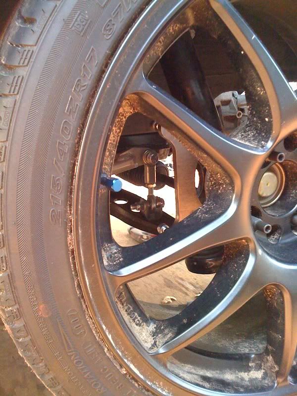

                  OK so I just got done being eaten alive my mosquitoes. So I got the fuse box/wiring harness/fusible link wired up.
                  Also got all the sensors hooked up that I could without getting the intake manifold on.
                  Went ahead and took a pic my non-existent front brakes. You can see the Massive adapter, the UUC sway and adjustable end link.

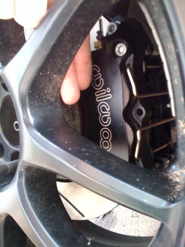

                    Oh sweet Wilwood tastiness.....
                    So the correct pads came in for my Dynapro calipers today so I went and threw everything on the car real quick and tightened it down.
                    Looks like my ugly, tasteless, mad-tyte JDM wheels are good for something. Can you say clearance? And there is even more room than what it looks like in the pictures. 6 pistons and 332x32 rotors could squeeze in there I think.
                    Still not big enough to fill out 17s, but looks much better than the stockers.
