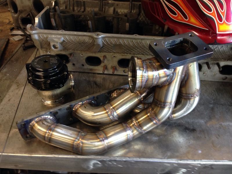

                        Originally posted by Dj Buttchug
                        yea but I pretty much chopped mine all up and built it the way i wanted. So my pipes route a little different.
                        to solve the issue I need to weld in a flex section to my down pipe. I think it happened when I came out of a parking lot and scraped my exhaust. Too much stress and it just snapped.
                        You need one of these...
                        Need a Turbo manifold? We have them in stock- Click here---> http://rapidspoolindustries.com/
                          Truth. If I don't make my own.....Otisfold for sure :)
                            It would be nice! but then I would have to re do my downpipe and IC piping to fit it.
                            Id also need one without the external wastage flange.
                            The worst part about whole thing is I have to un wrap my manifold. It was so nicely done :( and mani wrap is stupid priced.
                                Send me your crappy manifold and I can duplicate it so you don't have to change anything around.
