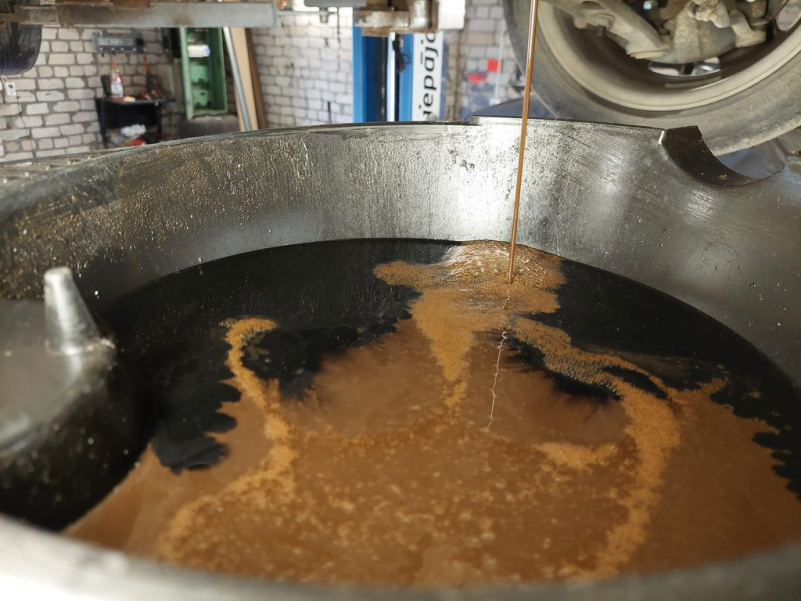

                ehhhh, there is antifreeze in oil, antifreeze itself is clean. I hope Its just HG
                changed oil to new one and set it for some winter sleep.

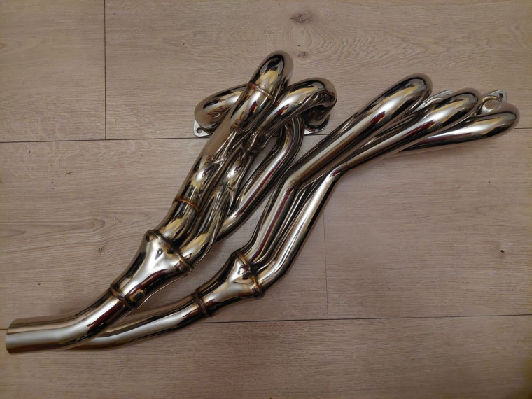

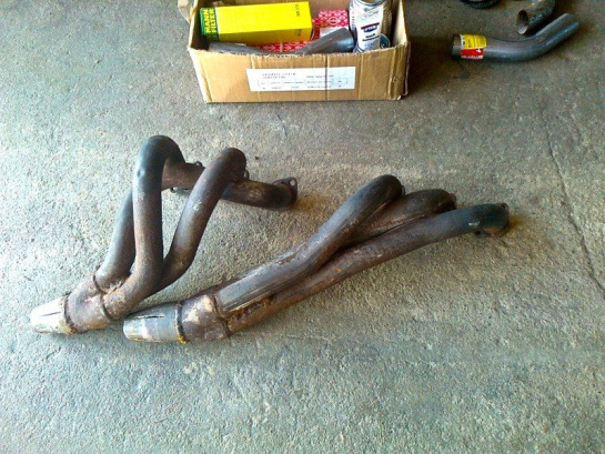

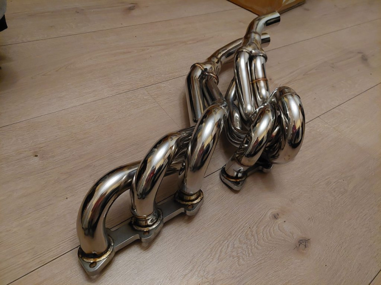

                but in the meantime​ some goodies arrived, new header, as the old sebring had done it's best and is pretty burnt out.
                It's some ebay header, but I kinda liked design and price, I believe I will modify It a bit and it will be pretty ok, as well I have plans on exhaust valves, so maybe I could gain some +1 hp more
                old one how it looked when I bought It, already 10 years ago​

                  installed new exhaust header, as I said after a long search I found the one I liked.
                  so got it after winter storage

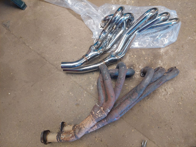

                  and now back to work
                  old one off

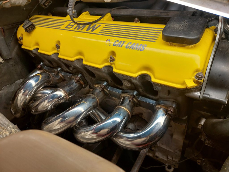

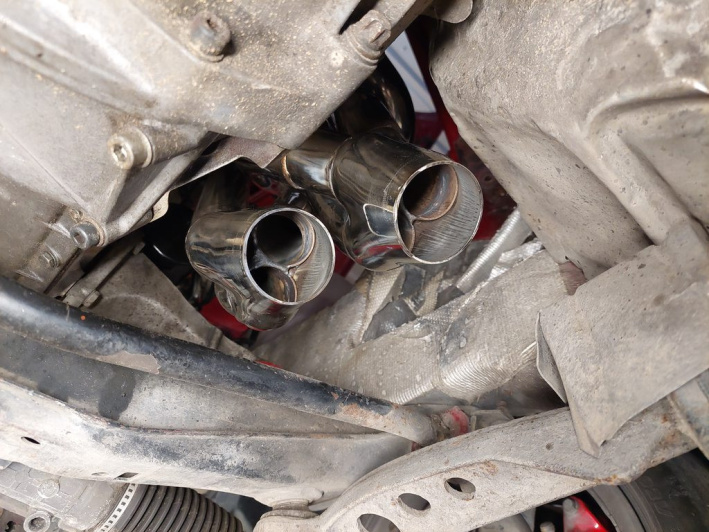

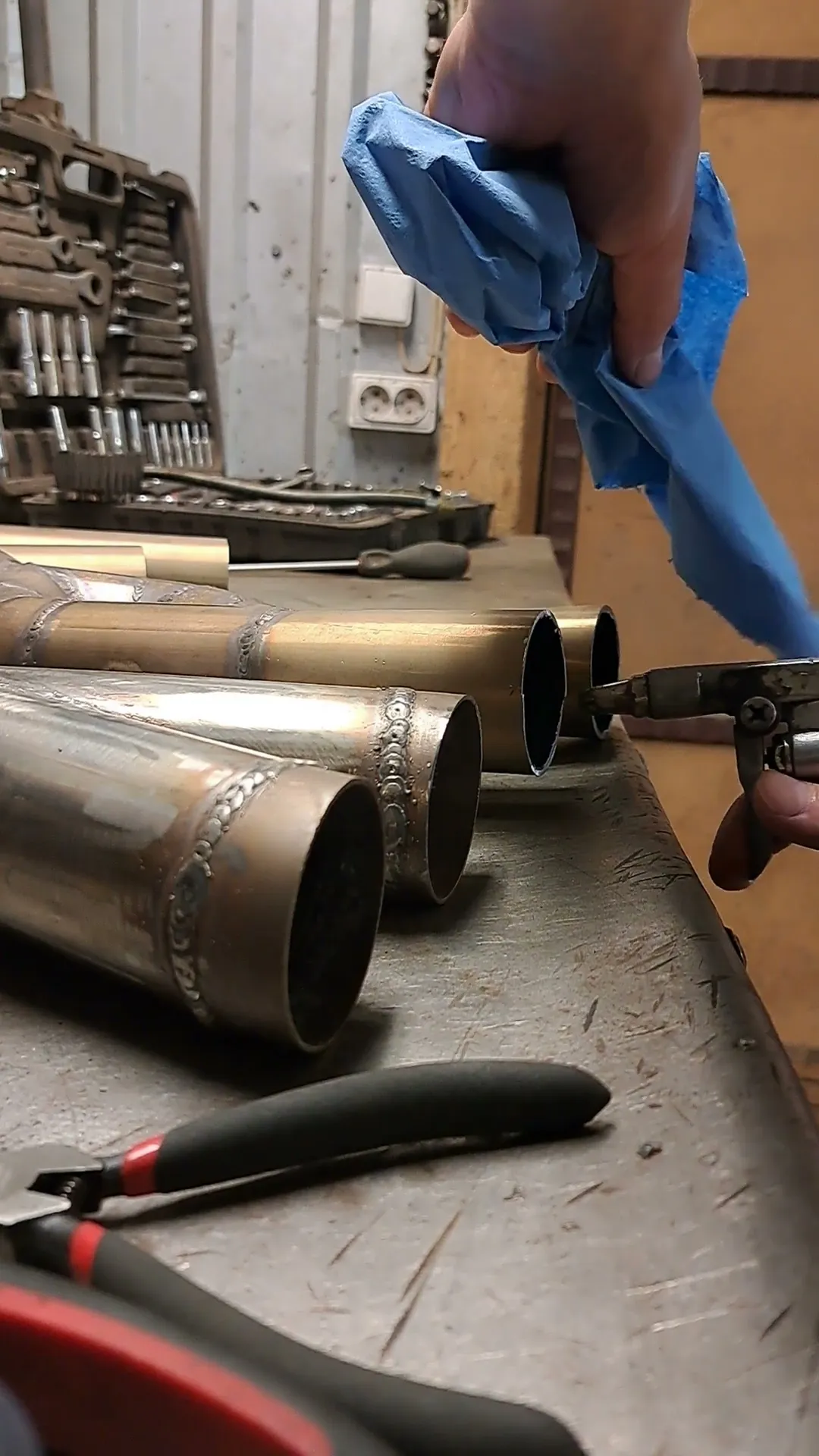

                  cut header ends to make them different and bit bigger in diameter, then bolted to engine to see all the clearances
                  ..oh my....
                  then made new connections with v bands
                  after that of course middle part
                  in progress
                  something like this
                  and bolted on car connecting it to old exhaust
                  made some extra heatshields etc. and everything works fine.
                  aalso readjusted valves, so everything was ready to roll

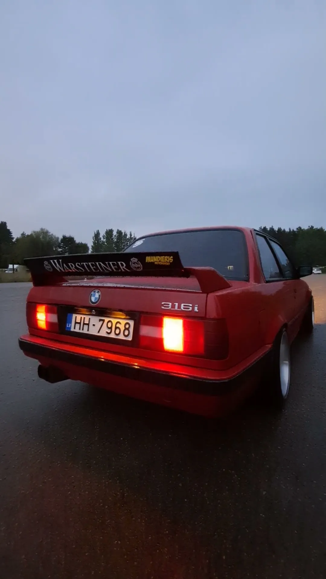

                    aaaalso, as you know I have rally e36, and since there are mostly E30 fans here, so DTM etc.
                    made new livery to my racecar, how do you like It?
                    so, that's all for now folks!

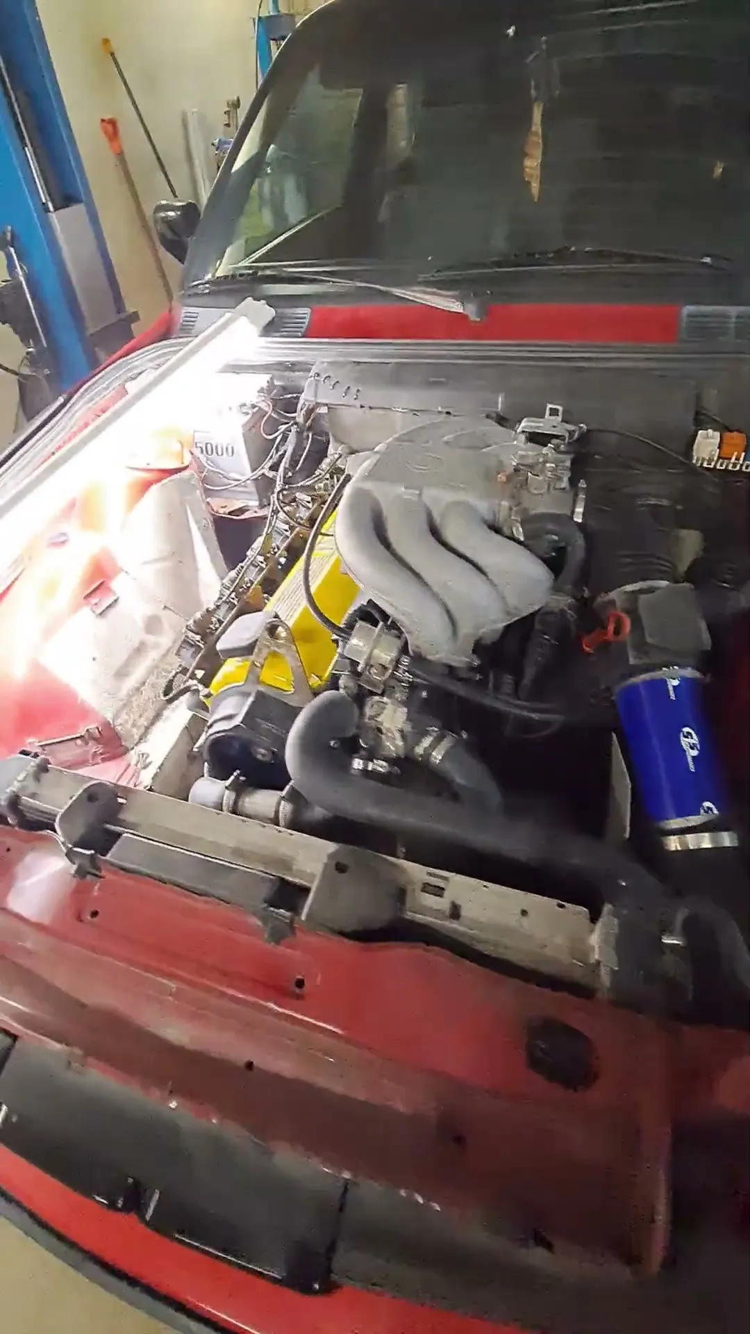

                            so, the e30 is alive again
                            ..a crack was found in the head
                            we repaired the crack not by welding, but by filling it with aluminum
                            after repairing the crack, we also replaced the guides, cut the seat angles, and straightened the camshaft tunnel
                            While I was waiting for the head, I repaired the stripped head bolt thread.
                            then the call came, the head was ready!
                            I received the head, everything seemed fine, only the plane of the head seemed a little rough to polish, but the master said that everything should be fine, okay, let's put it together.
                            new supertech std valves installed
                            This is what the repaired crack looks like
                            ok let's put it all together.
                            the inlet gaskets need to be slightly enlarged :D
                            Everything is assembled, let's try to start it!
                            ...BUT, fairytale gone bad
                            as I said, I didn't like how the plane was polished.
                            already when I bled the system I felt that something was wrong...
                            so antifreeze in almost all cylinders...
                            since I had to prepare for the rally, the e30 stood aside for a while, after two weeks I took the head off again, took it to the local guys to polish
                            these guys are serious, they polished it up, now everything is fine
                            interestingly, the head was very crooked, 0.12mm was ground off
                            I took a test drive, se everything is perfect now.
                            a little bit of lumpy m20 idle
