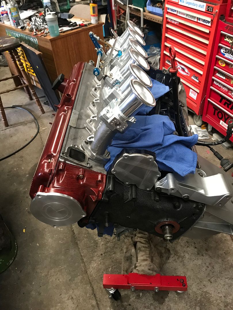

                            So itbs are home, trial fitted them on Saturday. Now it’s time to torque the head down & start buttoning up this motor.... well it would have been but rookie error on my part & I dropped a stud into the timing cover, so off cam the sump luckily I had a spare sump gasket. I found the offending stud nestled down at the oil pump.
                            So torquing thehead down next weekend along with timing the motor
                            Awaiting my flywheel to arrive, & deciding on clutch options, once that’s sorted the motor can go back in & I can figure out plumbing the electric water pump
                            • Anthony B
                              • Nov 2012
                              • 308
                              #44
                              Another Saturday’s work done, head is torqued down 30lb 15min, 60lb 15mins, 90lb 15mins once I get the engine running & upto temp I’ll pull the cover & they will all get another nip.
                              Covers are now on, sorting out the ignition coil mount plan is to use the old afm bracket & make a plate to weld to it.
                              And an early Christmas present from myself arrived, tracking down some clutch bits & pieces new flywheel bolts are a priority
                              It’s starting to look like a motor again, & slowly is getting closer to being back in the bay
