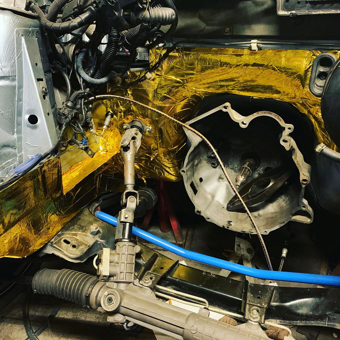

          Made a little more progress, modified the old afm mount for the ls1 coils to mount will make some leads to fit & got started on some heat reflecting

            Finally got around to some more work, modified the standard thermostat housing while Rama’s kit has a spacer to mover the thermostat forward to clear the itbs I’m aiming to keep as much room between the rad & front of the motor as possible. With the EWP I can delete the thermostat itself so this is more just a outlet.
            Put some more wanky reflect-a-gold in, just need my booster flip & I can finish up the bay & the m30 can go back in its home.
