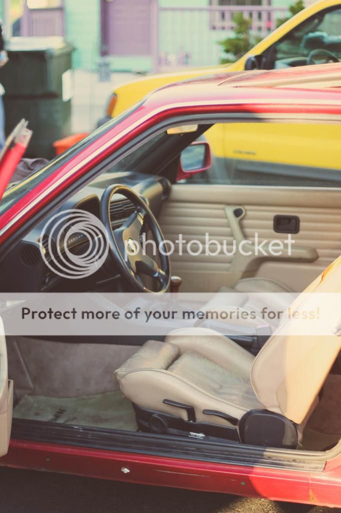

                            Car is finally coming along.
                            Found a set of pretty nice tan sports seats and got the manual swap all buttoned up.
                            Sourced a new piece of glass for the front windshield and also got my fresh hood back from the body shop. Going to glue my headliner back up and all that jazz when I finally get around to throwing that stuff on.
