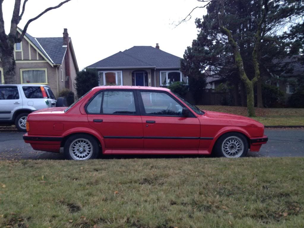

        this is my old ix on 14" weaves. Never had any problems with axles. Camber was off, yes, but it was not too bad. if I had kept it I would have eventually taken care of it though.

              It was on gc's ix coil kit, with koni strut inserts. The strut housings were cut 2.1" shorter.
                I'm assuming you did, but did you shorten the front struts? If not, how awful was it?
