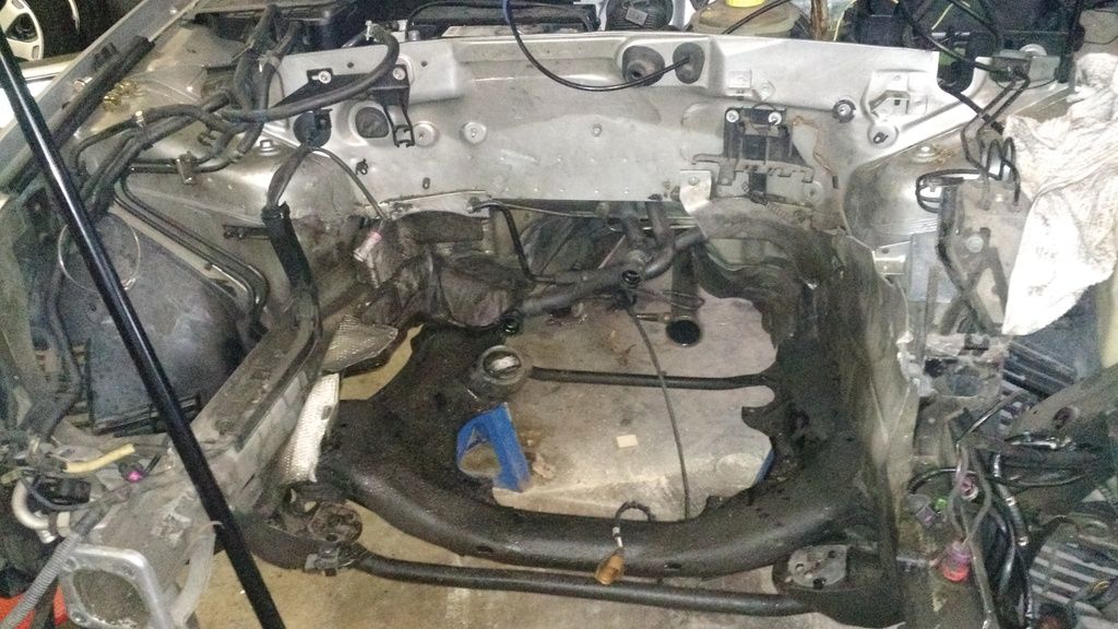

    Things are going to start getting interesting now.
    Parts list, ordered:
    -Piston rings
    -Rod bearings
    -Head gaskets
    -Manifold gaskets
    -water pump gasket
    -head bolts (no need for studs, stock hold)
    -034 Trans mounts
    -Apikol diff mount
    -Trans rebuild kit
    -inner cv boot (one is torn)
    -crank seal
    -rear main seal
    Need to order:
    -Timing belt
    -Clutch disk
    Since I just did a timing belt and top end reseal 10k ago, I'm going to reuse what I can.
    Getting excited. I've got some vacation time I have to use, so I looks like I'll have 3 day weekends all of December. Should give me some time to work on it.
    As for Single, I think I'm still going to go that route.

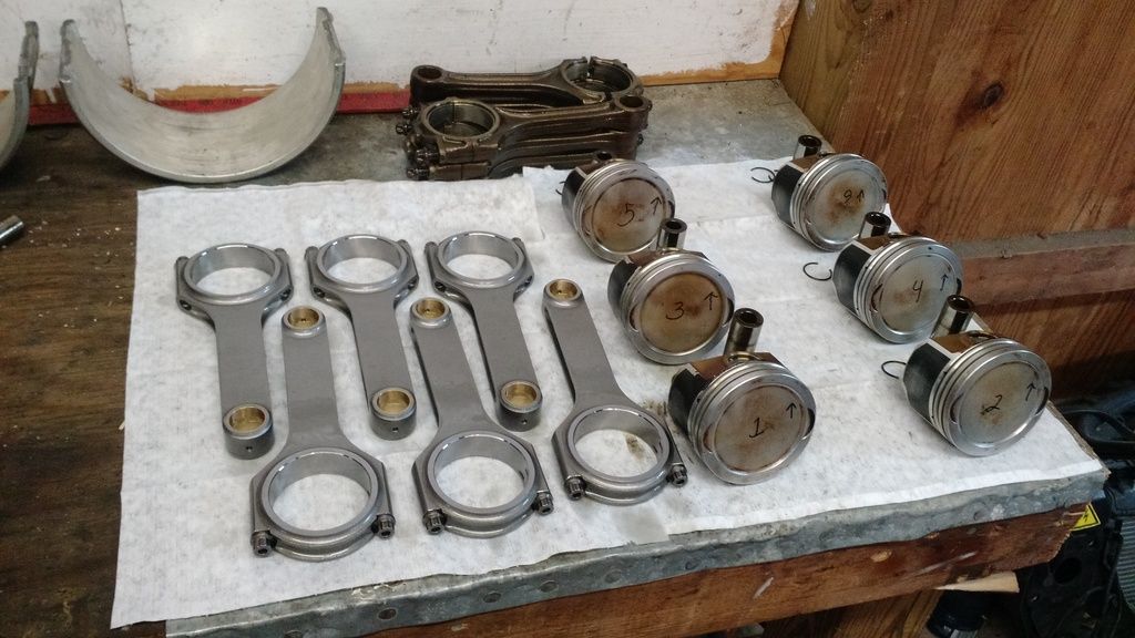

        Got all the kids together for a motivational family photo. Need a few odds and ends though.
        Rings should be here any day, still need intake manifold gaskets (completely forgot about that detail lol). Then I'll pick up a ball hone and be ready to assemble the new engine.
        Didn't see any obvious signs of damage on the old engine when I pulled the heads. Heads look to be in excellent shape, not even going to pull the cams out.
        After the new engine is together, I'll move on to the trans, then I've got a bit of cleaning to do before even building the single turbo setup.

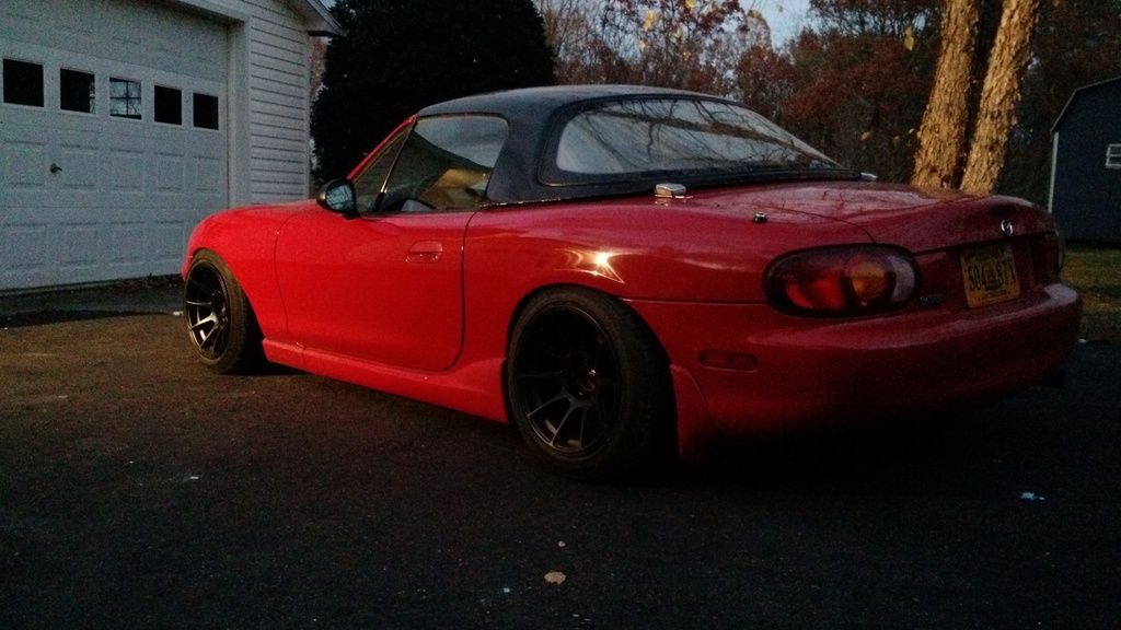

          that hardtop on that miata is hot. Almost makes me want one.
          Originally posted by priapism
          Originally posted by shameson
          • Exodus_2pt0
            • 5943
            #275
            You can buy mine! Been thinking about selling it for S4 funds. Only has 40k on it.
