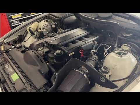

    I got the headers back on with the OE heat shield gaskets. I hate these things. It was not fun at all putting on the 16 copper nuts on these things. I also had to clean up the o2 sensor wiring as it was in pretty bad shape.
    The header/exhaust gaskets that he got had to have the bolt holes extended a bit. Used a rotary carbide to make them fit.
    Threw on a s52 oil cap I had, the one on there had a pretty bad looking seal, so why not. I also threw in the old chasebays PS reservoir I had from the e30. I really liked this thing so I've had it set aside since the deal on the wagon was made (almost 2 years ago). I also replaced the hatch shock - PO replaced one side previously. I replaced the OE airbox the PO put on with the old AFE setup I had in originally. I cleaned the filter and put on a drysock to help keep it clean. After priming the car a few times, the car actually started up and ran REALLY well. I was scared there was some kind of surprise waiting for me. The only real surprise was how soft and loose everything felt on the test drive. the shift knob flew off when i shifted into 2nd, and I forgot how soft a stock clutch setup is - it was kind of a funny moment. Brake fluid service, oil & diff fluid change are on the to-do list next (i think), I forgot how to reset the service light on this tbh, will have to have a refresher soon.
    The plan after the fluid change is to replace SLS rear suspension with bilstein b6 (already ordered)+febi top hats and see if i can fit some of my old e36 m3 perch + swift springs back there. I actually have spare 14kg rear swifts and 9kg swifts that I can throw up front When I refreshed the fortune auto fronts in the past I threw on 8kg Fortune auto springs. I'm really hoping to just recycle as many parts as I can to keep the costs down!!
    Quick little start up video!

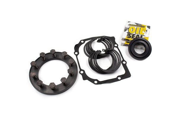

    RacingDiffs has a LSD retrofit kit that they offer for e46/e39. It uses a e30/e36 LSD core able to fit 188k housing but requires machining of the output flanges. This is great because I have a spare LSD core that would need a rebuild - just sitting on my shelf. (the problem is, i'm not sure I can find anywhere local to do a radial groove in the output shafts for me.) I am actually interested in trying this out, with the stage 4 or 5 rebuild kit they offer for e30/e36 188 diffs, I could potentially rebuild it as a 1.5 way differential vs a 2way. The other option for e39 is welded diff - which isn't great for auto-x or road courses I feel, OR 210mm diff upgrade which only comes in 3.15 or 2.81 open diffs or 3.15 lsd from e39 m5 and require axles and possibly drive shaft - which is a bit too long of gearing and overall too expensive for a car i want to slowly build/test.
    Enhance your BMW E46 with our ZF Plated LSD Conversion Kit. Ideal for models from 320d to 330i, this kit offers a cost-effective solution to dramatically improve handling and performance for racing or daily driving. Comes with a full installation tutorial.

        I talked to Ray from KAAZ and dm'd racingdiffs about their e30/e36 lsd retrofit into e46/e39. Turns out the 188k unit in both e39/e46 can be swapped with each other. MEANING....i could technically run a kaaz 1.5 way diff into the e39 if I do decide to make this the dedicated HPDE/AUTO-X car. Lots to think about - lots of monies. (I still need to order tires for this thing, planning on maybe kendas since I'm liking them a lot recently. Will probably run the tire sizes I used to (235/40/18 and 265/35/18).
