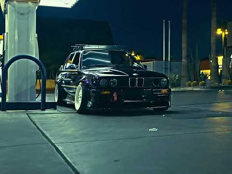

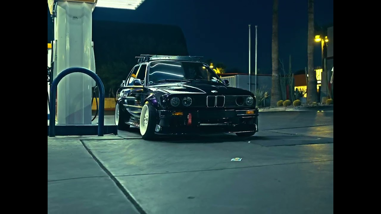

                      E30 content:
                      A videographer I met at our local drift events has been hitting me up to do a video shoot for MONTHS now. Our schedules just never lined up, and well I decided I should really do it before the car goes up on jackstands for maybe months.....
                      it needed a wash pretty badly......
                      my good friend ended up showing up to my house as I was prepping to leave to show me his new brixton wheels on his 992 turbo S - even more happy the video will have him in it tbh! really shitty how much traffic there was that night though.....I hope he got some good content LOL

                        #536
                        lil video he posted on ig!!
