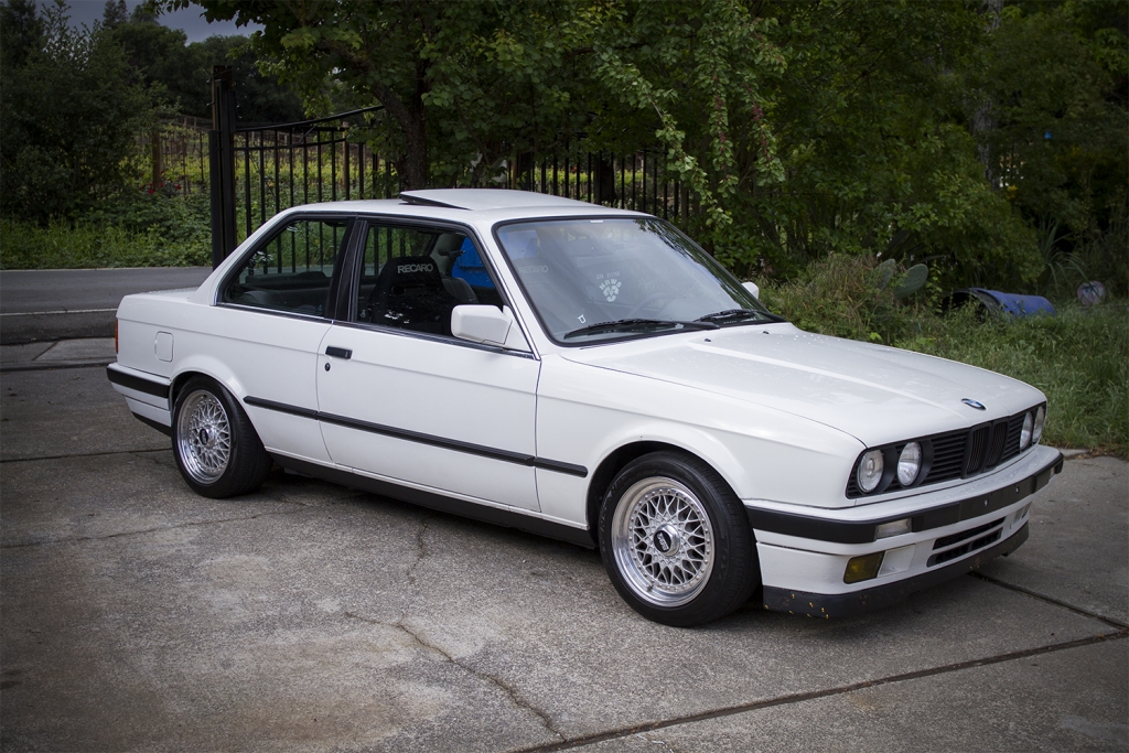

        As she sits today!
        Little update:
        Front Euro trim, clear oem zkw blinker's, buffed out the bumper and made the paint look nice and fresh! (as fresh as a daily driven bumper can be, at least).
        I sold the wheels last week in hopes to go another direction. Totally hating myself for it, but I'd really like a 16" wheel to fill the wheel wells more.
