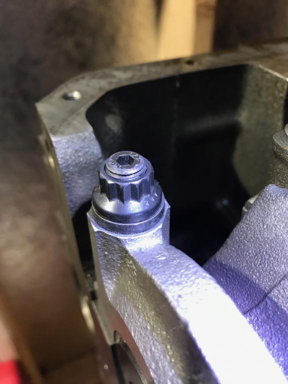

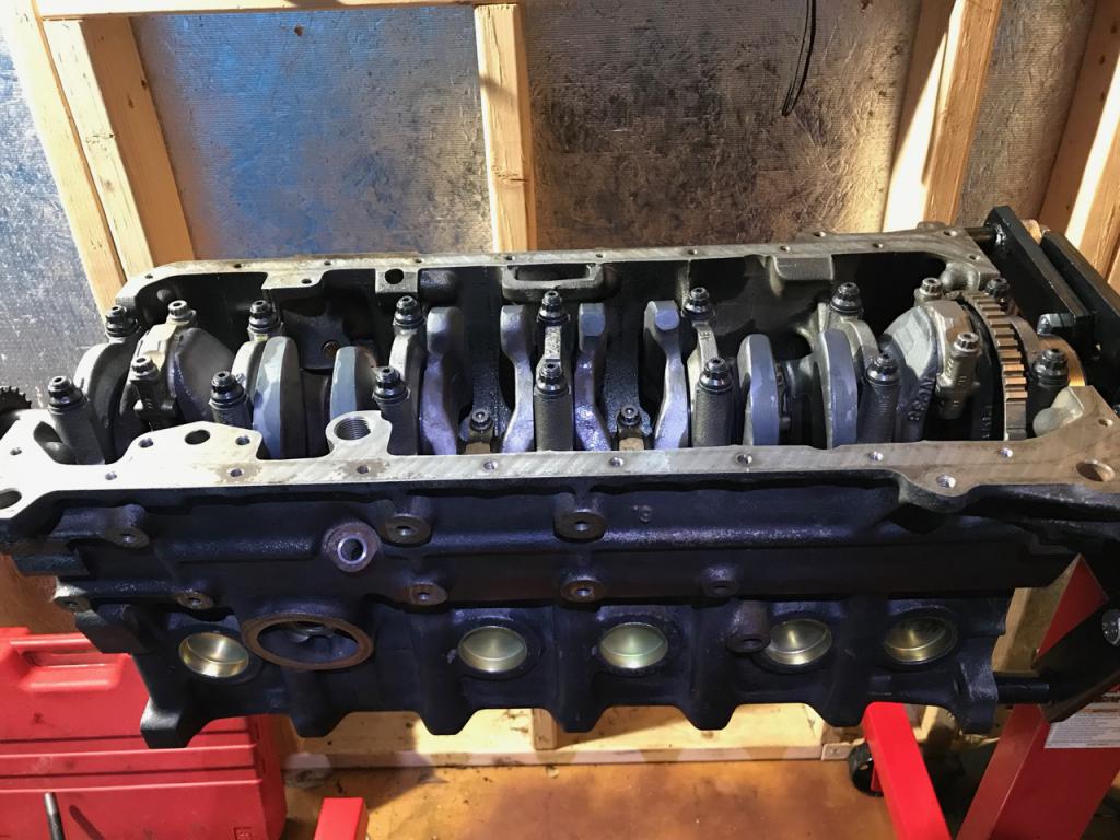

                Now, back to my bored/stroked (like a teenage boy?) engine project. Frustrated by the specced ARP main cap stud fitment, which is too short, I took a chance on another size and I found a winner.
                Specifically, the ARP part number 201-5000 (specced for the M50), which my machine shop directed me to buy, and others have also used in their M20 engine builds, does not fully engage their nuts if the studs are bottomed out in a block whose threads were chased and cleaned. Remember how I did that, and even ground down a tap so it would bottom out correctly? Strange how ARP lists part numbers for other BMW engines, but not the M20. So I took my machine shop's word, which seemed to correlate with others on this site, and I showed (in painful detail?) the results.
                Unsatisfied, I forked over another $130 for the next size up in studs; ARP #201-5002. These are specced for the S54 from the E46 M3. They are the same diameter and thread pitch, but about 6mm longer. Here's a comparison shot of length and fitment. Note, main cap studs in the background show the first one bottomed out, the others backed out of the block to engage most of the nut threads:

                And here are the new ones in-situ. Stud bottomed out in the block, fat-ass washers in use, and two threads protruding beyond the nut. As Archytas of Tarentum and Archimedes intended.

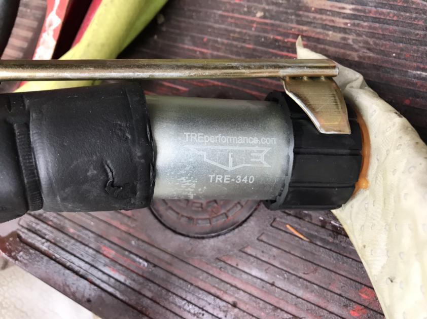

                    OK, I'm back. I've been distracted by a few things, including restoring a 76 Toyota Land Cruiser in my driveway. That was fun, and came out well. Also had to study to recertify for my medical board exams. That sucked.
                    I've been driving my e30 as a daily, but then it inexplicably stopped starting. Thankfully, in my driveway. Fuel systems are bugging me lately. I had the fuel injector harness fall apart before, and then I was one stranded by the fuel pump fuse blowing out. I think it was from a clogged fuel filter which I replaced.
                    This time, I traced it down to a lack of fuel. Thought I had a bad fuel pump, so I ordered a replacement. When I took out the one that was in there, I discovered an aftermarket high output, high volume pump. Probably the biggest you can buy, delivers enough fuel for a big block V8 making 800 hp. LOL, prior owners.
                    I have to wonder if it was over-powering the fuel pressure regulator, and adversely affecting tuning and performance. Never got around to dynoing this engine as I intended. If I have one more fuel or exhaust related problem on this car, I'm going to ditch my plans for that 2.9 L hot engine build, and swap everything out for a Tesla drive train.
                    Anyway, I put in a stock fuel pump, and all is well. For now...

                      I forgot to mention, that aftermarket pump functions fine, it was just a loose electrical connection to it. I may try posting it up for sale on one of the big V-8 hot rodder forums. Ha ha.
