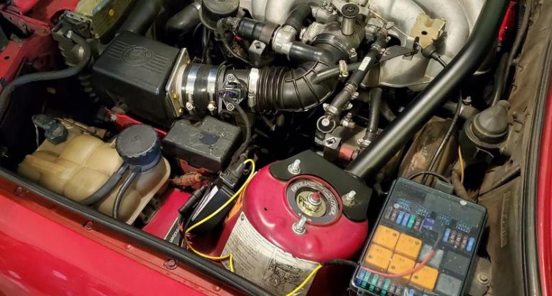

          I have one that I order at the end of last year. The MAF from SSSquid doesn't require a tune you can use an OE chip. You can also use any of their custom chips as well without a retune. I have Version 19 I believe with a 2.7i (Squid Stage 2.5) chip. The only issue I have is that every once in awhile it cuts out. But for just a brief moment and it's not to bad. I'm the bugs will be worked out as they go.

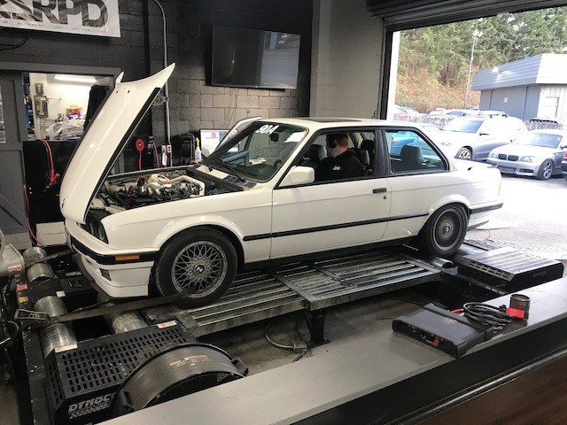

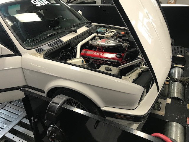

                      Just got my car back from a full day of dyno tuning at 22RPD. Any guesses on RWHP? Here's a refresher on what's in my engine:
                      2.9L M20 engine:
                      Block: M20 ETA block bored to 85mm by C&D Engine Performance
                      Pistons: 85mm Mahle Powerpak, 10:1 compression ratio
                      Rods: S52, balanced
                      Crank: M52B28 with Metric Mechanics pulley spacer
                      Fasteners: ARP head studs, ARP main bearing studs, ARP connecting rod bolts
                      Head: Supertech valves, Schrick performance springs, dual pattern cam (280/274), IE H.D. rockers, porting by C&D
                      Head gasket: Cometic MLS 86mm, .070” thick
                      Chip: 22RPD custom live dyno tune
                      Stock air intake box with K&N filter
                      Ireland Engineering heavy duty red spark plug wires
                      Bosch Type II 19lb fuel injectors
                      Malpassi adjustable fuel pressure regulator
                      New stock fuel pump
                      Racing Dynamics headers
                      Magnaflow 2:1 exhaust, no catalytic converter
                      '91 325i

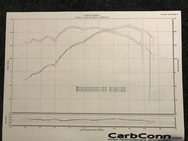

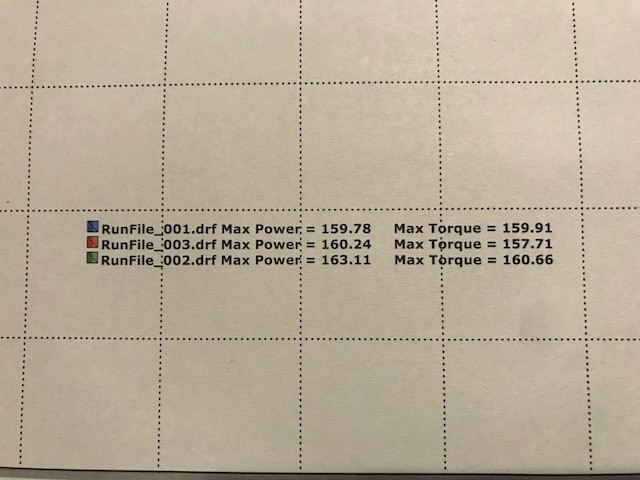

                          Whoah! An hour after posting this, I got 183 PMs with earnest HP guesses, and 22 decent offers to buy the car outright.
                          Well, not that many... Actually, none at all. No guesses, no offers to buy. I was lying. Maybe if this was 2015 again. Or if I was on Facebook (or is it Instagram?) I dunno, I'm old.
                          But I'm not lying about this dyno graph of my PREVIOUS untuned 2.7 (or is it a 2.8?) engine, RWHP. This is the verified stroker engine I bought on Craigslist for <$3K (transmission and full exhaust included), and is what replaced the fake Metric Mechanic 2.9 that was actually a tired stock engine when I bought the car. All documented earlier in this thread. Knowing what I know now, I most certainly could have gotten more power out of this with live dyno tuning. I'm posting this as my previous baseline, back when after the first transplant I thought the car was spicier than ever. Like a 4-star spice rating for your Thai take-out. Again, this is the PREVIOUS engine, which dyno's out for RWHP slightly better than stock. (It felt extra fast because of the short 4.10 rear diff.) This is not the current engine.
                          '91 325i

                              2.8ish with 10:1 CR is good, but the cam seems a bit mild. proper tune and a wilder cam should be closer to 200whp... my guess is 190 Bob
                              Simon
                              Current Cars:
                              -1966 Blue Boat
                              -1969 Red VW
                              -1986 White BMW
                              -2006 Green Thing
                              Make R3V Great Again -2020
                              • moatilliatta
                                • 6152
                                #285
                                22rpd always seems a bit high. 191 bob
