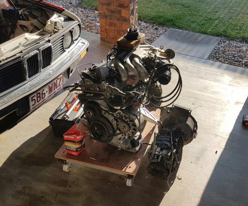

                Ok well i dont seem to post too much, but thought id write an update.
                Has been a rather interesting few months.
                Ended up going through 2 manual gearboxes to get a good one, then bought a brand new clutch to suit a single mass flywheel from a 320i.
                Got the manual conversion completed, and i got it on the road about 2months ago.

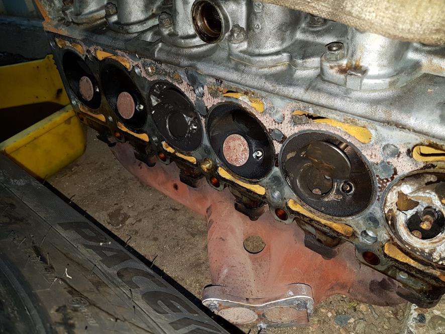

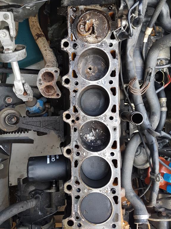

                less than 24hrs after getting it on the road my timing belt snapped at around 4000rpm, less than 2kms from home. Made a hell of a mess of the engine. holes in 3 pistons, broke 4 valves off, bent the rest. Engine was completely stuffed. I was amazed more than angry at how much damage it did. all kinds of carnage.
                On inspection of the engine it seemed it hadnt been looked after very well at all.
                Picked up a second m20b23 for cheap as (As everyone goes for the b25). Compression tested it and it came up very good (190 across the 6), but given i didnt know the history and i had a bit of spare time i decided to give it a once over.
                Pulled the head off, got it overhauled, new t-belt, new seals everywhere, essentially a top end rebuild and general tidy up. came up looking brand new.
                Put it all back in and it started first go (still running L-jet).
                Ended up getting a new exhuast made, which is a bit louder than expected but for $400 aud cant complain.
                Have been driving around for around 600kms now and all is well, super fun to drive.
                I installed the late model 60-2 trigger wheel on front of engine in preparation for installation of my haltech e8 ecu. I also got a wideband bung put into the exhaust and i purchased a wideband o2 sensor too.
                Plan is to run in semi sequential mode as the halteh e8 only has 4 outputs. I picked up the e8 for cheap yrs ago and have been looking forward to using it on a project. I will leave the ignition timing on the dizzy for hte time being, but eventually convert it to the GM twin posted coils. Im currently making a loom from an old engine loom.
                Few pics as how it sits at the moment. Is my daily driver now.

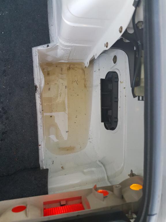

                          So we had a bit of rain on monday, seems i have developed a swimming pool in my rear right quarter area.
                          Ended up syphening it out with a piece of tube, and removing the carpet to let it dry.
                          Googleing the Internets suggests that there is a drain here that is blocked and perhaps I need to look at my taillight seals also.

                            Check your boot seal, and the seal on the right rear tail light. These are the most common leaks that fill that side of the boot.

                              The boot seal looks fairly good condition, possibly new at some stage. I think the taillight seal is actually installed a bit poorly based on inspection. will pull it out on the weekend see what i can do.
