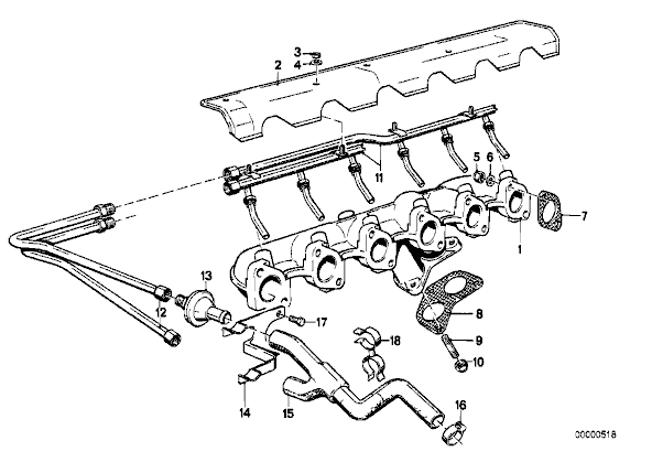

                                Fitted up my wideband yesterday.
                                Went for a 30min drive or so, and the whole time i thought that the numbers seemed a bit lean......at wide open throttle i was getting 13s,, idle i was up in the 15s and would even drop to 16+ (max lean reading) at times. very light cruise i could also see 16+ as well. It is a brand new NTK sensor and i calibrated it as per instructions.
                                After some investigation it turns out that what i thought was Exhaust gas re circulation is actually an auxiliary air pump pumping fresh air into the exhaust. You can see the pipes in the exhaust manifold below. BMW calls it a "pulse pump" or some such thing.
                                Fairly ingenious design in that it uses the pulse of one exhaust to push fresh air into the other exhaust via those air valves. Emissions thing to attempt to burn left over fuel in the exhaust, only on the very early m20b23 and only in Australia and Switzerland or something. Wasnt on the later m20b23 i dont belive. Quite a good idea, but not great when trying to read 02 readings accurately.
                                So next step is to block off that contraption and see if i get more reasonable readings.
