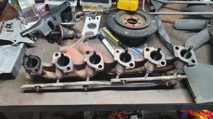

        burkey001 - Thanks for that info and the photo. I have a mate lined up to use his scope on the sensor. should be able to figure it out. I don't think the haltech e8 has the diagnostic feature, will have to have another look.
        lukeADE335i - Yer definitely L-Jet as far as i can tell. I actually have another m20b23 manifold that doesn't have the pulse thing, but unfortunately it has a different bolt spacing where it joins the rest of the exhaust. Why bmw had to change the bolts here who knows....If im going to buy any new extractors its going to have the ability to bolt a hairdryer to it ;)
        Im thinking i might just remove the pulse things from the manifold and put some bungs in place for time being. Just not sure what bungs to put in. Perhaps if i can track down some steel ones they might suit. Just worried about thermal expansion and potential cracking of the cast manifold.
        In other news I blocked off the air pump system at the air box where the number "16" is in the photo before. literally just shoved something in the end to block it.....no difference to the mixtures....So maybe it is really lean at low idle, once the idle is up to about 800-900rpm where its supposed to be it sits around 12.5:1 which is about normal.

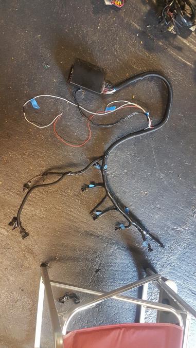

        My 10 new Bosch injector/temp sensor plugs turned up yesterday and a new TPS and VR sensor plug will hopefully turn up today. That should be all the plugs require, new shiny plugs all round.

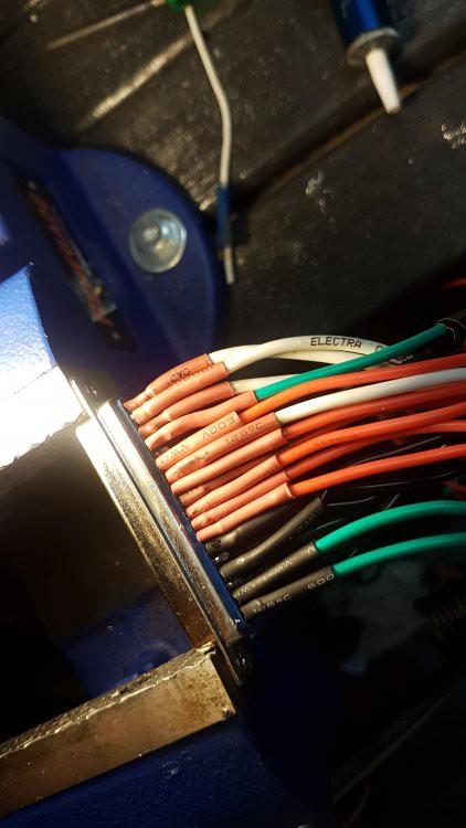

        I have a spare complete loom here, so my intention is to remove all the non engine wires (coolant gauge, oil pressure light etc) that plugs into the square plug near the fuse box (C101? plug), hopefully it all separates out nicely and i can combine it with my new engine loom.
        Then just need two new relays, one for main IGN and one for fuel pump. I already put the wideband on its own relay, i think it draws like 2-3A during heating so i thought it had better have its own power source. I've decided to put new generic relays in as the oem bmw relays are a bit difficult to find spares that aren't damn expensive. Plan is to put battery in the boot and mount the new relays and an additional small fuse holder where the battery was. I will build a little plate to mount them too. should look quite nice and be nice an accessible for when something inevitably blows.
        Also i have discovered that Ls1 coils are cheap and have built in ignitors. I could potentially go individual coil for each cylinder, and just wire them in wasted spark configuration....more research to be done.

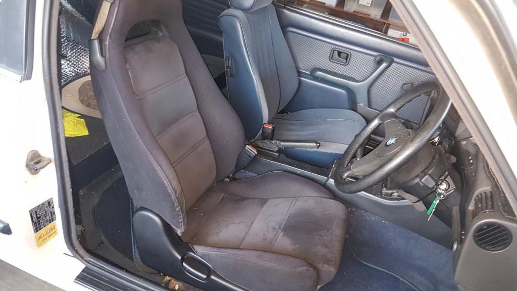

          Long time between drinks,
          Not a whole lot has been achieved, other than its been my daily driver for 6 months and haven't had any dramas. Just happy motoring.

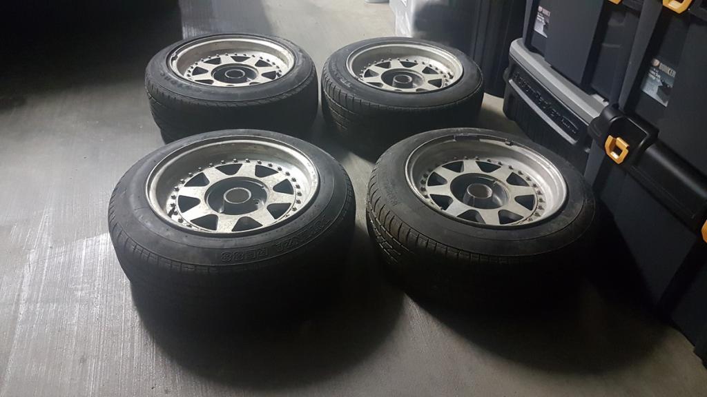

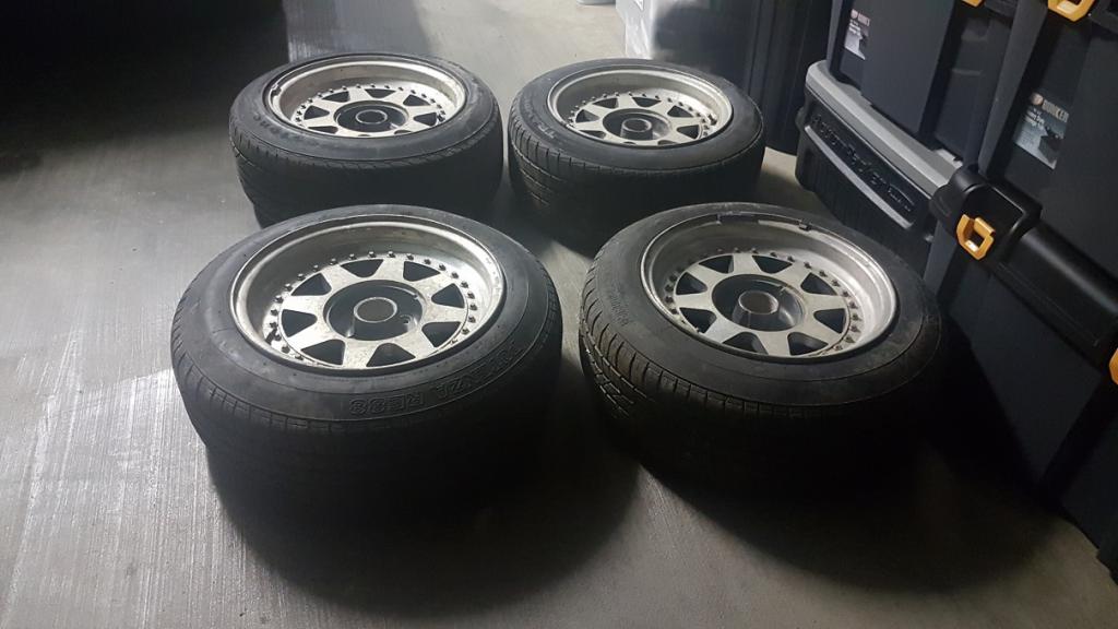

          Some of you may have seen my post, in that i picked up a set of Zender 15x8 zero wheels. Still havent decided what to do about them, or how to make them fit. Probably need to redo the suspension before i put them on anyway.

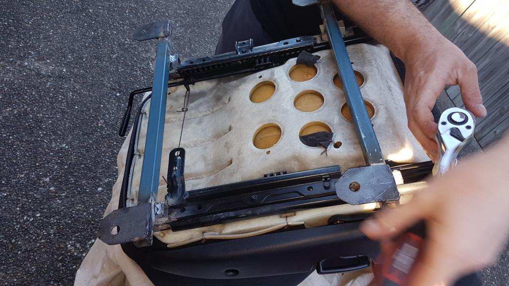

          I did purchase a pair of S7 FD rx7 seats a few weeks ago. Pretty good condition for age (2002?), They are like a dark charcoal swede. On the weekend i fabricated up a rail for the drivers seat. Pretty damn comfy and it looks quite good. Certainly an upgrade over the crappy calapsed seats that were in it. Price to date is 400AUD for both seats and material for rails. And like 8hrs of my time remembering how to weld!
          Hopefully get the passenger seat rail fabricated this weekend.
          Fwe photos, ive no idea why the seat photo has alot of white dots. something up with the camera phone i think.

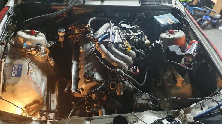

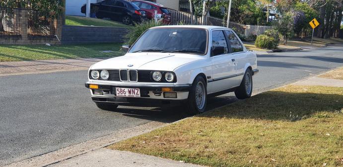

            Well its been a few years hasnt it. but the car is still here. had it for about 5 and a half years now. up to 190,000kms or so. So ive done about 40,000kms.
            I didnt post much here for a few years in there due to different work circumstances and generally not sitting in front of a PC all day, but now that im back to a desk job i started posting some more, so i figured i would update.
            Car is really just a weekend toy now due to having a work car, so it gets out most weeks for a drive or two.
            I sold those wheels above as it became clear that i would need to modify the guards to much to fit them.
            So i dunno, few mods of note:
            - Megasquirt 2 on the m20b23 with LS1 coils in wasted spark
            - koni yellow shocks
            - oem Mtech 1 rear springs with no spring pads , "super low" king springs front - this has proven to be a nice compromise in comfort and sportyness and work well with the Koni shocks
            - rear whiteline sway bar - this has been a great upgrade
            - EXIP 15x7 wheels with RE003 tyres - tyres are pretty good street tyres - hopeless on the track!
            - momo 350mm wheel.
            - Aicon fixed ! <-- biggest upgrade
            Anyway here's a few photos.
            Ive got plenty of plans but at the moment its really quite nice to drive. An LSD would be nice and i also need to paint the bonnet and the guards as the color is a bit wrong, but its presentable enough as it is. I do need to get the drivers side floor mat repaired one of these years too...

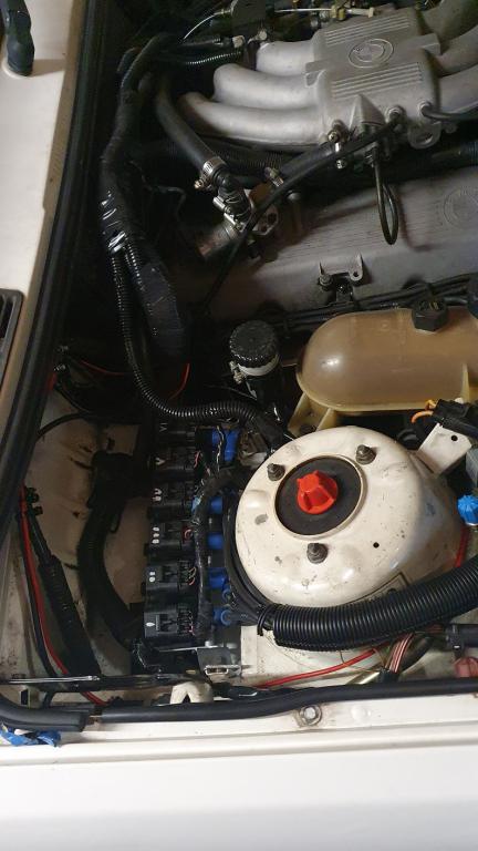

                  so the stats are:
                  -m20b25 ballancer with the 60-2 wheel on it
                  - megasquirt 2 with ms extra
                  - fuel injectors wired in 2 groups of 3 - just oem injectors, but i did just get a set of modern ones that ill be swapping in when they are cleaned
                  - 6 x LS1 coils running off the front LEDS of the MS wired in wasted spark
                  - move the battery in the boot - coils sit where the battery was
                  - AU falcon idle control valve attached to the rocker cover for full closed loop idle control - had to tap a few holes for the hoses but this works well - there is probably a neater option avilable but a mate used one on his 4age 20 and he had a spare - seems to work really well.
                  - m42 variable TPS with an adaptor plate to suit the m20b23
                  - ballenger motorsports afr500 wide band with an NTK sensor - very nice unit - expensive compared to others but 4yrs or so and ive not damaged a sensor.
                  Initially i had it setup for fuel only, and kept the m20b23 vacuum advance distributor running the ignition. I had it like this for about a year or so. allowed me to really fine tune the fueling, idle control and the acceleration enrichment. i spent ALOT of time getting the cold starts right as well as temperature compensations. i did have some issues when sitting in traffic the IAT would report very hot values and the ECU would lean out, but i eventually sorted it. also lots of time on dialing in the closed loop cruise settings and adjusting the tune to make sure that my tune was close enough so that the closed loop was only changing maximum +/- 5-10% or so. Acelleration enrichment was good fun to, i experimented with the wall wetting technique in megasquirt, which actually worked awesome sometimes, but i could never get it perfect all the time, reverted back to the TPS based which seems to work well enough.
                  I then added in the LS1 coils - wired in pairs and run off the front LEDs. LS1 coils being logic level driven they need bugger all amperage to fire. These have worked perfect from the second i installed them, zero issues. For the timing map i just used some data i found on WOT settings of the m20b23 vac advance distributor and then filled in the map to match a "normal" engine map. Which seems to work ok. I've added a degree or two here and there. its definitely faster and snappier than it was with the distributor, but i really dont know how far i can go without going to a dyno. which has been on my list for....a few years.... i think there is definitely more in it at the top end, but as to how much ill not know until i dyno it.
                  I have recently made my own set of band pass knock ears to try and tune the ignition - bolted a knock sensor to the block. it actually seems to work quite well, but jeez its disorientating driving around listening to it. I need to get a mate to have a drive while i have a play on the laptop. its also on the list haha.
                  The distributor still remains, as it runs the tacho, but theres no igntion wires attached of course.
                  As you can see by the engine bay photo its all a bit of a science project, but hey, it works good.
                  And all in all its been rock solid reliable. With the AC now working i haven't needed to do any sort of AC idle up as the closed loop seems to take care of it. it does dip a little bit if using the AC when engine is still warming up, but it never stalls. i have linked to a few short youtube videos, one where i was stuffing around with a new camera mic, and another showing a cold start. Dont really have any videos of it driving.

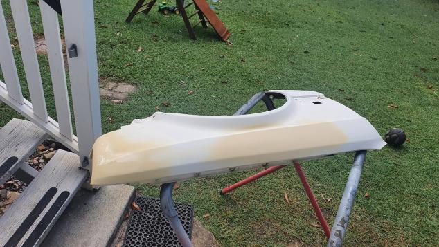

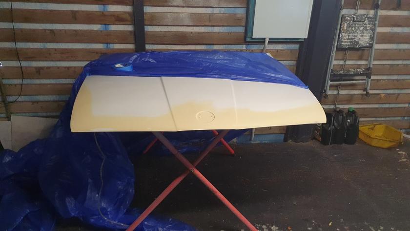

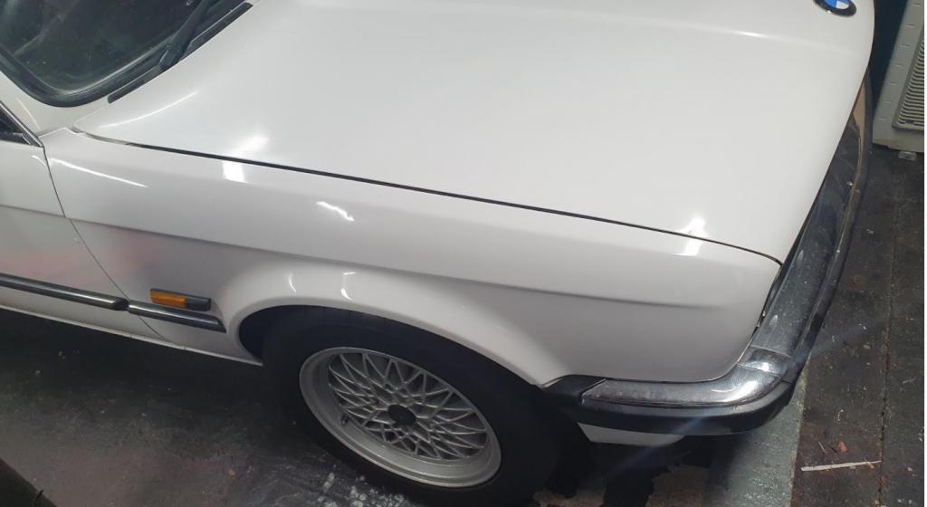

                    Well time goes on, few projects have been completed over Christmas.
                    For years the bonnet and the front right guard has had dents....and the guard was the wrong colour....and I've sort of ignored them. But I saw someone on here had done some rattle can spraying and decided to have a go. I have done a fair bit of acrylic spraying over the years but always used a spray gun, not a rattle can.
                    So I went down to the local paint shop and the guy was really helpful and spent ages color matching. So I got some colour cans, some clear, bit of bog and some spray putty, and a fancy 3M mask....
                    The car doesn't appear to have been crashed but it certainly has had some paint repairs over the years, best not to look to closely as its like 5 different shades of white.
                    Didn't take too many photos but here is a couple during, and then some other ones just for fun of the finished thing.
                    I still very much struggle with fixing dents, sanded and bogged a number of times and never really got it completely perfect, but its hard to pick the dents if you dont know they are there. But honestly its a significant improvement. and for the cost (like $120 maybe) i think its quite good.
                    So here's a few photos.
                    Click image for larger version  Name:	20211128_101555.jpg Views:	0 Size:	43.7 KB ID:	10043698
                    Click image for larger version  Name:	20220105_173927.jpg Views:	0 Size:	54.6 KB ID:	10043699

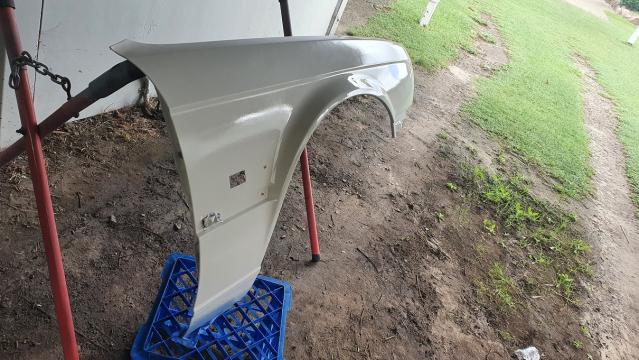

                    Here is the shine on the guard straight out of the rattle can. way better than i expected.
                    Click image for larger version  Name:	20220109_130209.jpg Views:	0 Size:	54.3 KB ID:	10043700
                    The guard was then sanded with 800 then 1500 and then i hit it with a buffing machine. Its actually not a glass finish but it does match the rest of the paint quite well in shinyness, heres a close up of the paint
                    Click image for larger version  Name:	e30 guard done.jpg Views:	0 Size:	46.0 KB ID:	10043702
                    You can see in the close up photo above the rust bubble on the door, the door was a spare I picked up years ago. . I have a spare perfect door in the shed, though its unfortunately silver. so if i get enthusiastic one of these months i will start on that door and give it the same treatment.
                    Honestly the rattle can turned out so well that I'm tempted to just keep going and do the whole car! least it will be all the same colour.

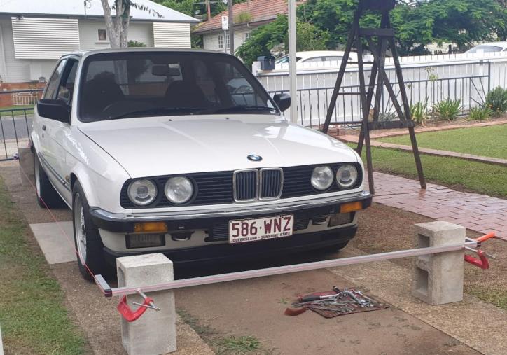

                    Other news is I blew the steering rack, fluid EVERYWHERE, i had suspected the rack for a while but was ignoring it as you do. It was a shaft seal and the rubber boot filled with oil and asploded on my driveway as i was painting the panels. I did buy an E46 rack but ended up just putting a spare oem one in that I had to get it back on the road. E46 rack looks like a relatively easy conversion I just need to buy a few bits so will need to save my pennies. Here's me doing a wheel align, if strings are good enough for formula 1 they are good enough for me. Drives pretty good now. (note: bonnet not aligned in this photo).
                    Click image for larger version  Name:	e30wheel align.jpg Views:	0 Size:	70.5 KB ID:	10043701

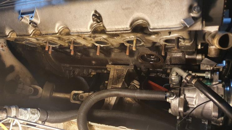

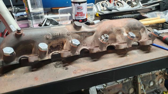

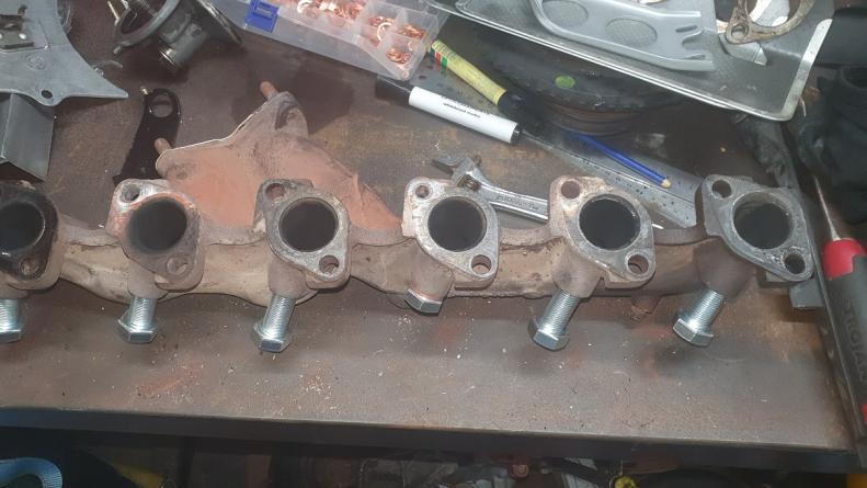

                            Well maintenance time. Timing belt. First car I've ever done 2 timing belts on - always sold a car before time is up. So engine is currently in a million peices.
                            Has been good fun to pull it all apart again after putting it all together 5yrs ago. A few oil leaks were found too to fix. The oil filter right angle doovey needs a new o-ring and the rocker cover gasket looks like it needs replacing. thats only a few yrs old. oh well. they are cheap. everything appears to be in good shape though.
                            However one job ive been meaning to go for years is block those stupid air injection ports. I tried to remove the ports with the manifold in place but i just couldnt get the spanner in, so ended removing the exhaust manifold on the car which was a complete pain in the ass, but i got it off.
                            These ports i believe were only on the m20b23 which you guys in USA didn't get in the e30, maybe you did in the e21?. Its an early emissions device before catalytic converters.
                            The bolts are m16x1.5, which is a fine thread, easy enough to get online. I did have to cut them down to around 6 threads. i used 2 copper washes as with one the bolt head hit the casting. and you can see i had to make a "custom" bolt for one of them as the casting was very much in the way of the bolt head. Just TIG welded a smaller nut on the top and then ground off the hex head. of course i don't anticipate any real changes from this just the engine bay will look significantly neater. But those stupid ceramic tubes in the exhaust ports cant have helped.
                            Click image for larger version  Name:	20220302_191102.jpg Views:	0 Size:	60.4 KB ID:	10048521 Click image for larger version  Name:	20220302_202006.jpg Views:	0 Size:	52.7 KB ID:	10048522 Click image for larger version  Name:	20220302_201948.jpg Views:	0 Size:	58.1 KB ID:	10048523 Click image for larger version  Name:	20220303_113423.jpg Views:	0 Size:	49.3 KB ID:	10048519 Click image for larger version  Name:	20220303_162652.jpg Views:	0 Size:	57.0 KB ID:	10048520

                              Oh wow. That's pretty interesting. I've never seen the an M20 manifold with exhaust injection ports. Does it have some sort of belt drive pump?
                              Super cool car and wheel setup!
                              @Zakspeed_US
                              • e30davie
                                • Apr 2016
                                • 1788
                                #45
                                Nope. its even cooler than a pump. if you have a look at this photo below (that is on the previous page) item 15 is a couple of 1 way valves. so it uses the pulse of one exhaust pulse to push fresh air into another exhaust port. Totally passive system.
                                https://www.r3vlimited.com/board/fil...tch?id=7189232
                                Ultimately its probably not a bad idea, as many new cars do the same thing with a pump, but i assume it would stuff with my wide band readings, so its been blocked off for years. but now (hopefully) its blocked off properly and looks significantly neater.
                                Once i get this all back together i am going to get a catalytic converter fitted. this car is pre 87 so in Australia no cat was fitted, but it does stink...and it is 2022....so i'd better get one fitted.
