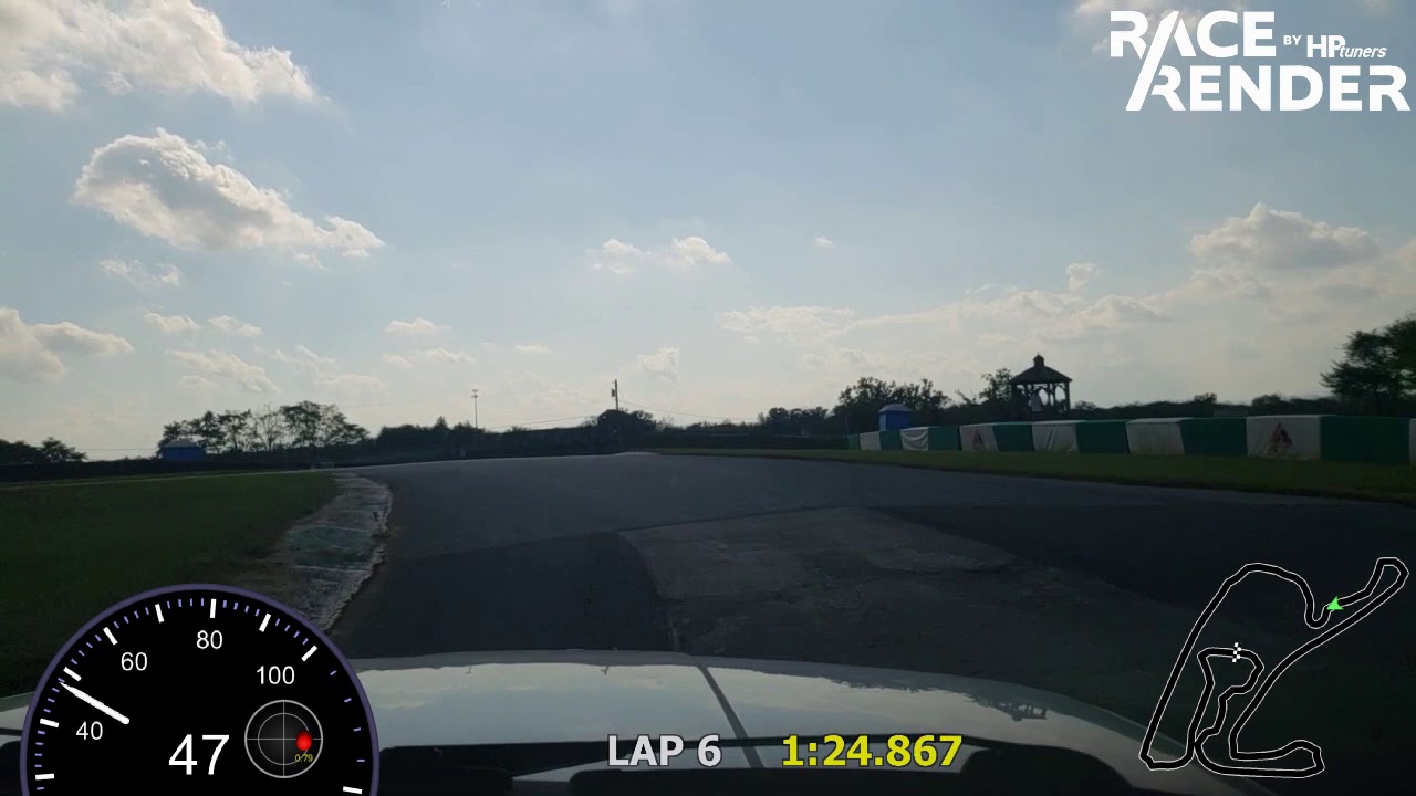

                          Video and Data
                          I bought a mount for my phone so I could use TrackAddict to record video and overlay GPS data (speed, track map). NJ BMW CCA is serious about safety (a good thing) and wanted everything tethered securely. Here's what I came up with for the mount/tether. I had previously made this to secure my first gen GoPro to my STI, but it works for the E30 as well:
                          Here's one of the many laps from this weekend:
                          https://www.youtube.com/watch?v=DcKE...ature=youtu.be
