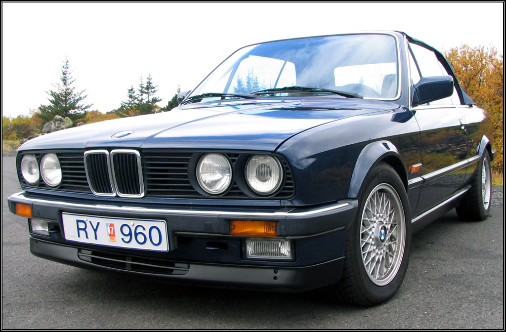

    In other news, I just pick n pulled a front lip off an '88 vert and it fits perfectly! $26. Going to re paint then just put it on. Pretty sure it's this guy:
