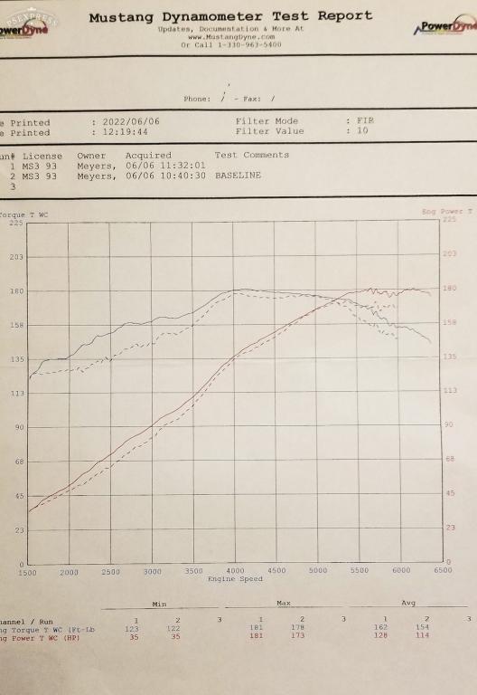

                      An update for anyone who's interested:
                      After taking about a year off from engine tuning to do this
                      I finally found a good tuner in Atlanta that knew Megasquirt and to some extent e30s. That's 181 on a Mustang Dyno so conservatively 195-ish on a Dynojet and 215 at the crank? I'm OK with that.
