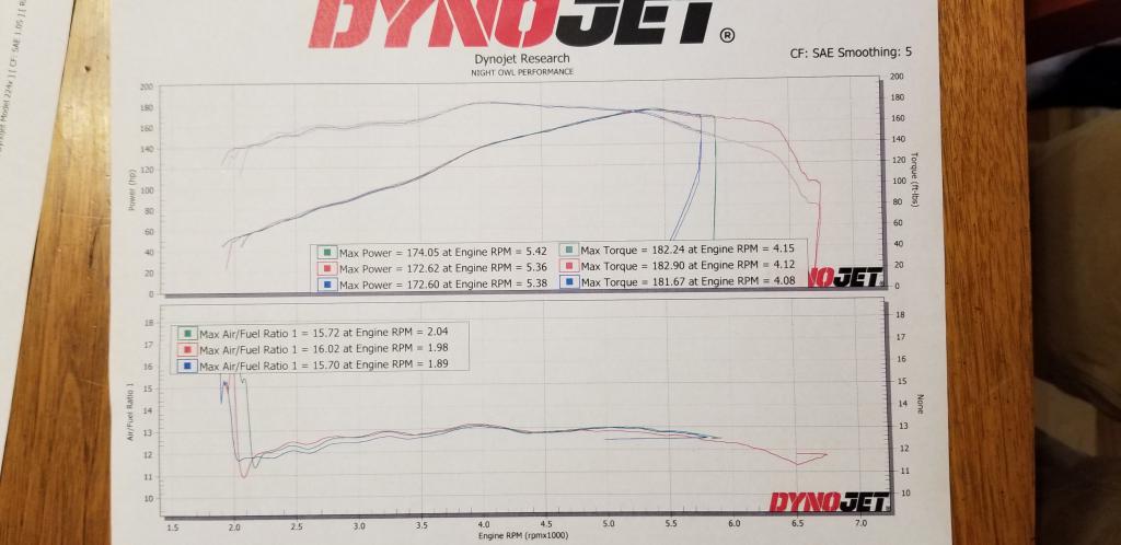

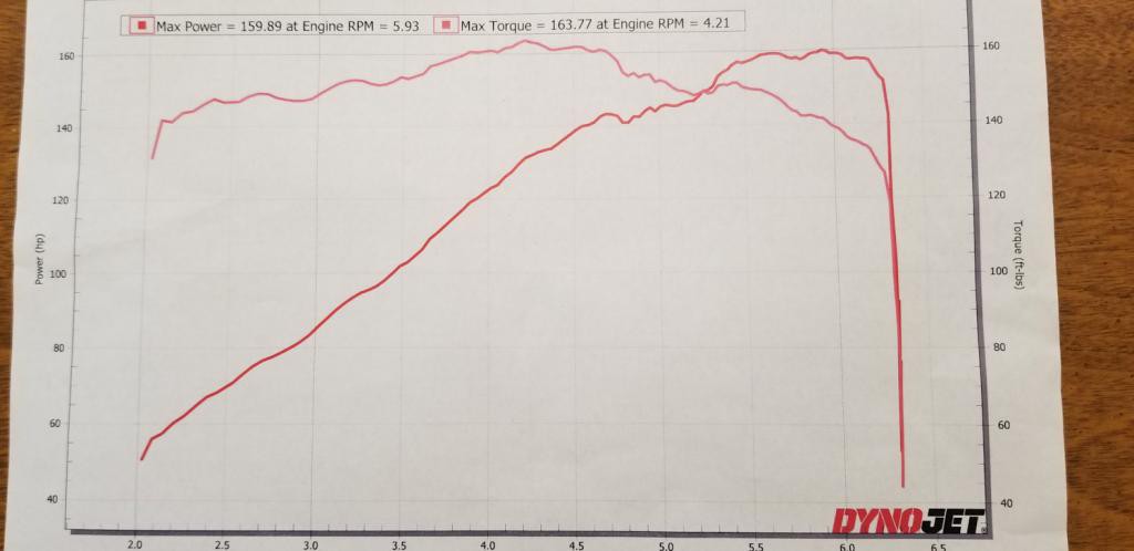

            Got the o2 sensor sorted out and have the car running reasonably well on the wideband now. DIYautotune helped me find a TunderStudio setting to fix the tach signal. Idle is still a little quirky but it's actually better than what I had on the stock ECU - actually, everything is better than the stock ECU, even with the Megasquirt still untuned. I've run VE Analyze some but I think I've reached the end of what I can do with it. The VE table is spiky and uneven and I realize I can smooth that out by hand but I'm not certain it matters. I think the AFR targets and timing need to be adjusted by someone with real knowledge and a dyno. Put it on the same dyno as before and got what I think is promising results. Is there another 5-10% to be achieved just from tuning?
            Before MS ECU:
Name:	Best 7_3_20.jpg

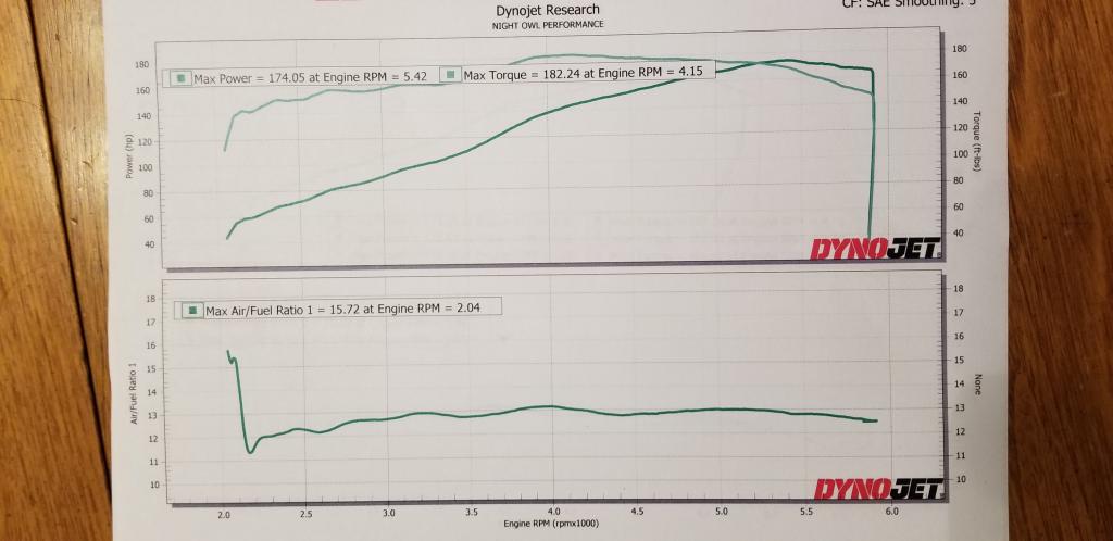

            After MS ECU:
Name:	Best 9_14_20.jpg
            Here's all runs from yesterday:
Name:	All 9_14_20.jpg

              Originally posted by Delanoso
              After MS ECU
              Click image for larger version  Name:	All 9_14_20.jpg Views:	0 Size:	58.7 KB ID:	9950711
              Originally posted by 2mAn
              Id aim for a realistic number around 175-180whp and anything more is a bonus. Might need more cam, but should be a strong setup as-is when properly tuned

                Congrats on sticking with it and getting some good numbers out of it!
                Too funny

                  #83
                  That's more like it!

                    #84
                    It must be significantly better too now in everyway
                    Simon
                    Current Cars:
                    -1966 Blue Boat
                    -1969 Red VW
                    -1986 White BMW
                    -2006 Green Thing
                    Make R3V Great Again -2020
                    • Delanoso
                      • May 2016
                      • 52
                      #85
                      I thought about that post when I saw the new dyno chart. Nailed it.
                      Yeah, it feels freed up. It clearly needs a bit more work but it's so much better.

                        No real power to be gained with fuel except maybe 2-3k where it should be no richer than 13
                        as for how much more power it depends what timing is like at moment and how optimal

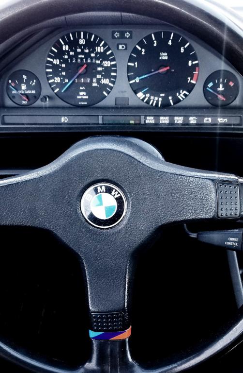

                          New gauge cluster from Bavarian Restoration!
                          My econometer doesn't work and neither do the economy functions in the OBC. The old gauge barely had tach and spedo readings. Greg at Bavarian Restoration says I'm missing a signal from Megasquirt. Can anyone direct me to some details on that? Not finding anything on my own that really makes sense.

                            Had to look back at the first post to see if you have an early model. Since you do, the tach, OBC lockout, and the eco gauge all run through a white plug next to the ECU in the glove box. Black is tach, green is OBC ignition lock, yellow is the eco gauge.
                            Who's MS box did you buy? DIY and Whodwho's are a little different from one another, but either way the yellow wire needs signal - maybe start by checking for A/C on the yellow with car running.
                            john@m20guru.com
                            Links:
                            • Delanoso
                              • May 2016
                              • 52
                              #89
                              I see the plug. The black wire is cut so we got that moved to the proper location - my tach works. I have no signal on the yellow wire. By A/C did you actually mean an alternating current signal?
                              • ForcedFirebird
                                • Feb 2007
                                • 8300
                                #90
                                Yes, it's PWM, but you can use a DMM set to A/C to at least tell if there's any signal.
