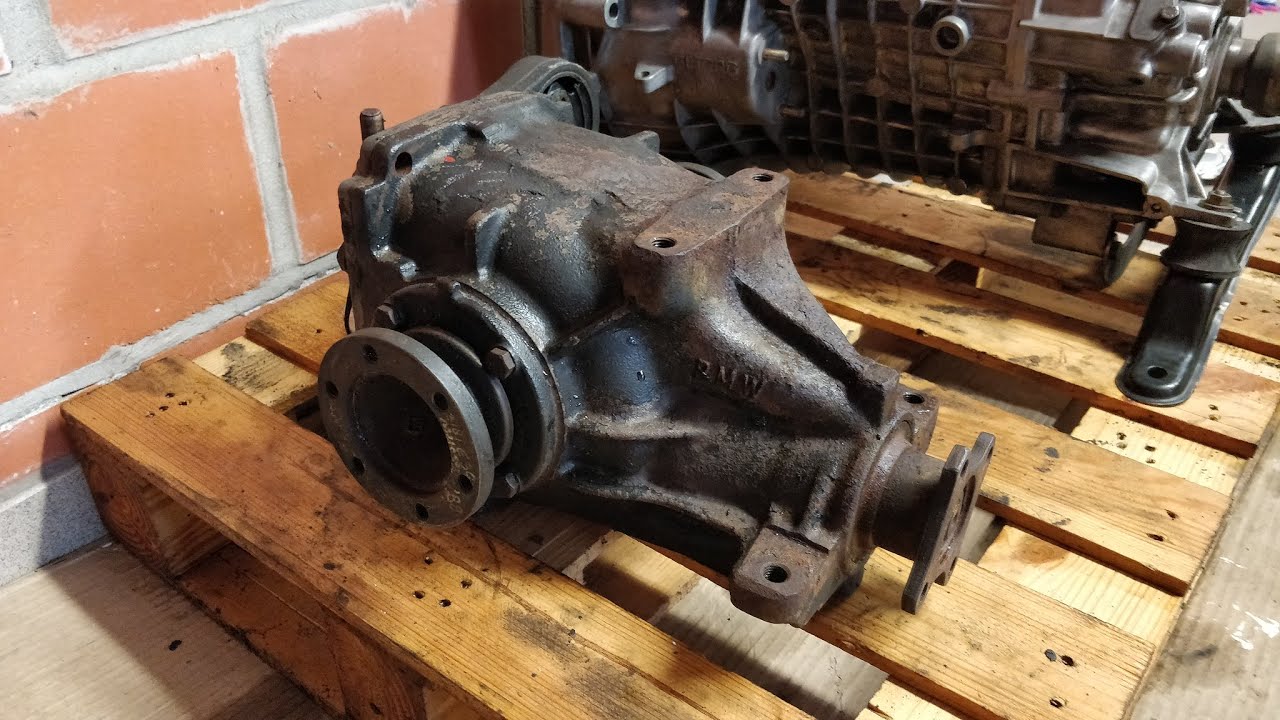

          Small update and some questions cornering my differential swap.
          On Monday I went to my local 2nd hand E30 parts supplier. I was searching for a 4.10 open diff (original spec for 318is) for quite some time. He received some new stock and I immediately went to pick it up.
          He told me if I tried it and it was not good that I could just contact him and change it for an other one. Let's keep our fingers crossed that this one is good.
          So my plans for now are to swap the diffs to check if it runs fine with no noises. If the 'new' one is good, I'll change the output seals, cover seal & washers for the oil plugs. I don't want to waste money on a bad diff.
          Before pressure washing:
          IMG_20201226_100105 by Pieter Van Nevel, on Flickr
          IMG_20201226_100112 by Pieter Van Nevel, on Flickr
          After a pressure wash:
          IMG_20201226_103244 by Pieter Van Nevel, on Flickr
          I then proceeded and opened the speedsensor to check for amount of metal shavings. I thinks the amount of small flakes are okay. Does not seem like any excessive wear has happened. Also the oil in the diff was quite black and old. I changed it while it was out of the car.
          Speed sensor magnet from the 'new' differential
          IMG_20201226_125657 by Pieter Van Nevel, on Flickr
          Speed sensor magnet from my 'old' differential that was installed in my car. It's hard for me to compare with anything else, these are the first differentials I check myself but I got a feeling that this is a bit too much to be good.
          IMG_20201226_162322 by Pieter Van Nevel, on Flickr
          It's quite pleasing to see that the original diff still was in quite a good shape. No excessive rust on the outside. The car was originally a Spanish car, so never seen road salt and I think little or no rain.
          IMG_20201226_161204 by Pieter Van Nevel, on Flickr
          When comparing the two differentials it is obvious that the old differential has more bearing noise, a metallic dragging noise which make me really think this one has seen its better days.
          I must say that there is also a big difference in the amount of force you have to put on the input shaft to make it turn. The old one does turn nice and freely despite the noises. The new one is a lot rougher to turn but does not make as much noise.
          I'll add a video to show the differences in sound. I'm looking for some of your more experienced inputs & remarks about these parts. Thanks in advance, it is really appreciated!
          Left is the old differential that came out of the car. Right is the one that will be going in.

                  Good news, I installed the differentials and no more bearing noises. So pulled it from the car again to start everything to give it a new set of seals and clean it up.
                  I then started chipping all the loose chunks of rust with an old screwdriver and a rubber mallet. Also scratched and removed the grease that was in all the small nooks and crannies.
                  At work we have this heavy duty Kärcher Hot Water pressure washer that I used to give the thing a last clean up. At home I applied a layer of Brunox rust converter with a brush. Also gave the flanges a coat.
                  Next on the list will be giving it a nice coat of matte black paint.
                  I also removed the fresh oil I have put in a couple of days ago, it was already a grayish-brown colour. I'm thinking it got this colour because of water that got inside while cleaning? Only drove 4 or 5 kilometers with this oil..can't hurt to give the diff an oil flush?
                  I already started looking for the output flange oil seals, cover seal, o-rings, new crush washers.. dealer here is in holiday so I have to have some patience.
                  Most of the hardware can be reused, but I tend to get me some diff mounting studs to make the installation a bit easier. Because it was a complete pain in the a**. I think I fr*cked one of the threads on the bolts/diff. 3 of the 4 goes in smooth.
                  Only thing that bothers me is that these seem quite pricey online and most come from US suppliers. I do not want to pay +50,-€ for 4 studs.
                  So at the moment I'm trying to figure where I can buy some similar studs.

                      Today some time has been spent on the differential. Gave it coat matte black. At the moment this will be on hold until I get the parts. Mounting studs are on their way from Germany
                      IMG_20201230_173155 by Pieter Van Nevel, on Flickr
                      IMG_20201230_173139 by Pieter Van Nevel, on Flickr

                              Also good news, a friend of mine will mediablast my diff cover and press in the new bush on his hydraulic press. Should have it back by the end of the week. So it will be a joy to look at after all .
                              I already regret that I did not order a set of new yellow passivated hardware..
                              received_1150866905348720 by Pieter Van Nevel, on Flickr
                              When removing the cover I checked the gears inside for wear and damages. All looks okay, but on the spider gears that turn when cornering there are small pits.
                              What are you guy's thoughts about this? I didn't make any noise when driving and I hope it will at least last another couple of months/years.
                              IMG_20210110_115758 by Pieter Van Nevel, on Flickr
                              IMG_20210110_115838__01 by Pieter Van Nevel, on Flickr
                              IMG_20210110_115812 by Pieter Van Nevel, on Flickr
