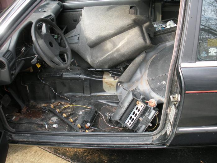

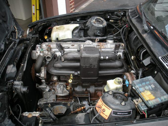

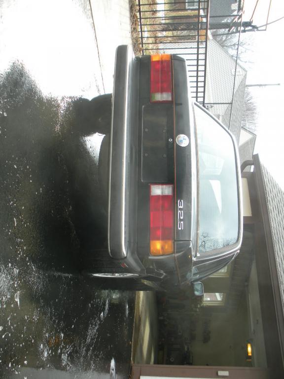

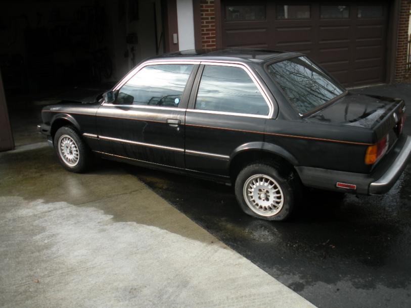

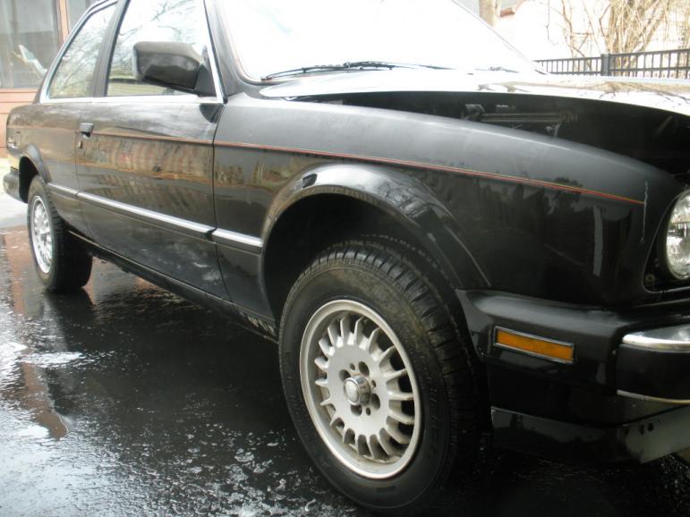

    I have a new child: 1986 325. This car was originally a 325e with an automatic. The story that I heard is that a group of guys was going to take it Lemons racing. From what I can tell, they pulled the engine and transmission and installed the M30 and 5 speed. And that's as far as they got: no driveshaft, no ECU, no exhaust. (It's hard to know what happened to the interior.)
    Yes, I know this looks like a hopeless cause, but it's not. Here's why:
    1.) There's hardly any rust on the car. The only spot (so far) that I have found is a small hole under the gas pedal. The body doesn't have any rust on it.
    2.) I didn't have to pay any cash for the car. I did some work on another friend's car and he gave me this one as payment!
    3.) I didn't have to pay any shipment charges for it. I just had to wait 3 hours for the stupid tow truck to show up.
    So, I need a bunch of parts for this car. Here is today's list:
    1.) M20B25 engine and getrag 5 speed transmission (I don't want the M30 and I have a home for it.)
    2.) Front and rear sport seats
    3.) Carpet
    4.) Complete exhaust system
    5.) Driveshaft
    Anybody got any spare parts for sale?

      You should just keep the m30. Looks good in there

          Woohoo! Glad you got her home. The M30 is a b34, and with how little parts are there to support the M30 swap it's likely not worth the hassle to finish it off. If it were a b35 I think it'd be a different story.
          1989 Hooptie 325iS Build Thread
          1989 Zinnoberrot M3 Build Thread
          • e30austin
            • 15382
            agreed, and that one looks like a US spec B34 variant (8:1 compression, yay). would absolutely install a B25 and be done with it.

              The m20b25 is everything. You will not be disappointed with that move.
