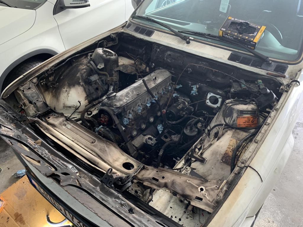

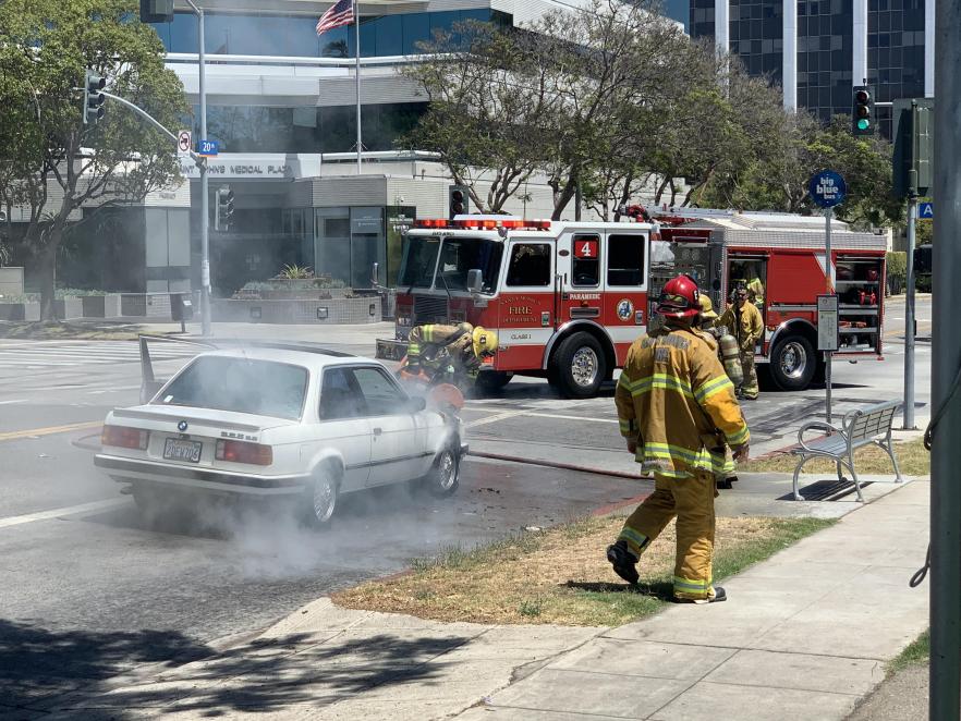

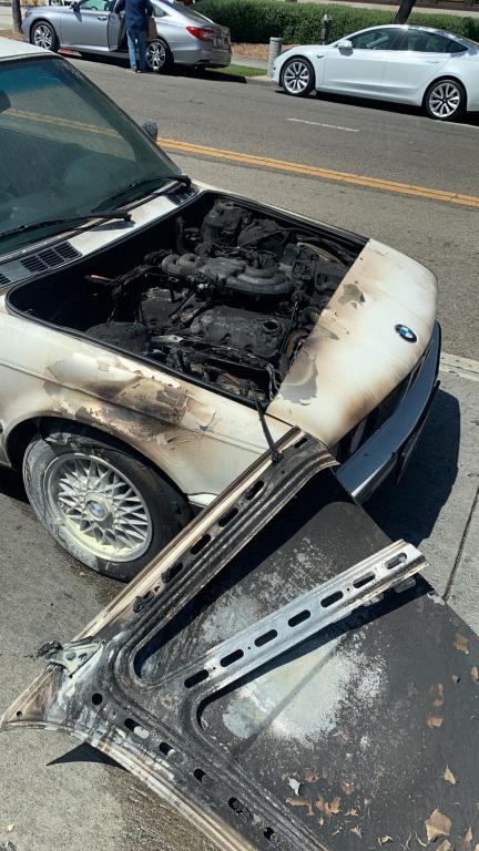

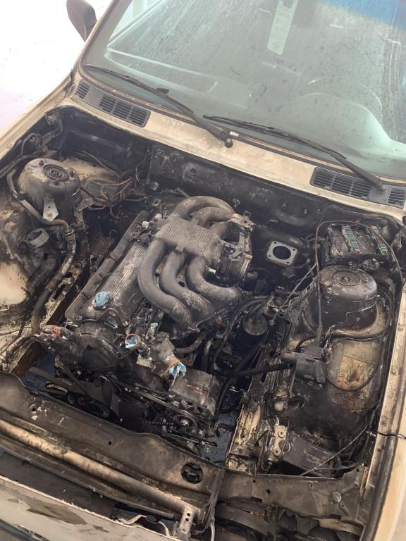

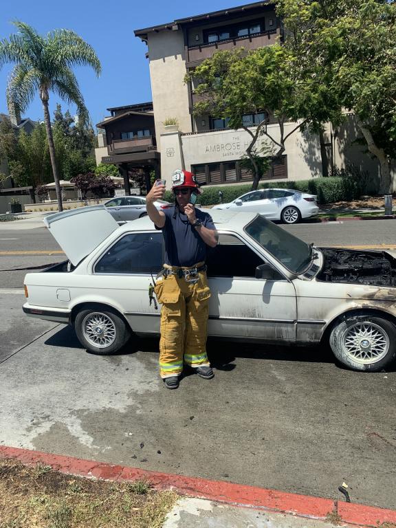

    On the weekend of the 4th, I was on my way to watch an oval race at Irwindale Speedway as you do, and when I pulled up to a light a few blocks from my house, I heard a pop followed by smoke and passersby yelling at me to get out of the car. I shut the car off and jumped out, saw flames underneath, and my heart sank as I watched helplessly as my pride and joy burned. Very luckily, there were a ton of witnesses so 911 had already been called by the time I got out and there was a fire station literally one block away from the intersection so they were there within minutes. My hood release cable melted so they had to chop my hood off to put the fire out.
    Most everything plastic and rubber in the engine bay was torched but luckily none of the belts snapped or anything, so I was confident the motor was alright. I towed it home and began stripping it down, removing all the burnt stuff to get a better sense of what happened. The firemen had said something about a fuel leak and since the pop I heard sounded like it came from the trans tunnel, I assumed one of the soft lines down there popped and fuel got on the exhaust. They also recognized my car and were sad to see it under those circumstances, although they had fun with it (did I mention the car has a car phone?!).
    Click image for larger version  Name:	IMG_4501-min.jpg Views:	0 Size:	129.1 KB ID:	10064151 Click image for larger version  Name:	IMG_4506-min.jpg Views:	0 Size:	108.3 KB ID:	10064152 Click image for larger version  Name:	FBQT0005.jpg Views:	0 Size:	78.0 KB ID:	10064154
    [My hood being cut off (left) and the firefighter taking a pic with my car phone (middle) saying "hey guys, this is how he called 911!", the aftermath (right)]
    To my confusion, when I got under the car, all the fuel lines were intact (and in decent shape all things considered) because the fire was concentrated on the passenger side. Still confused, I decided to scrub down the engine bay to see where the deepest scorches were (remember how I mentioned the car was crusty? Yeah, a few days and half a dozen kitchen sponges later, the bay was clean). Come to find out, the A/C line that runs from the compressor up the passenger strut tower popped and it was refrigerant that had been burning! No idea how this happened, the A/C had never blown cold so I never had it on.

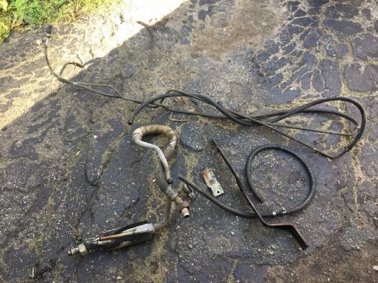

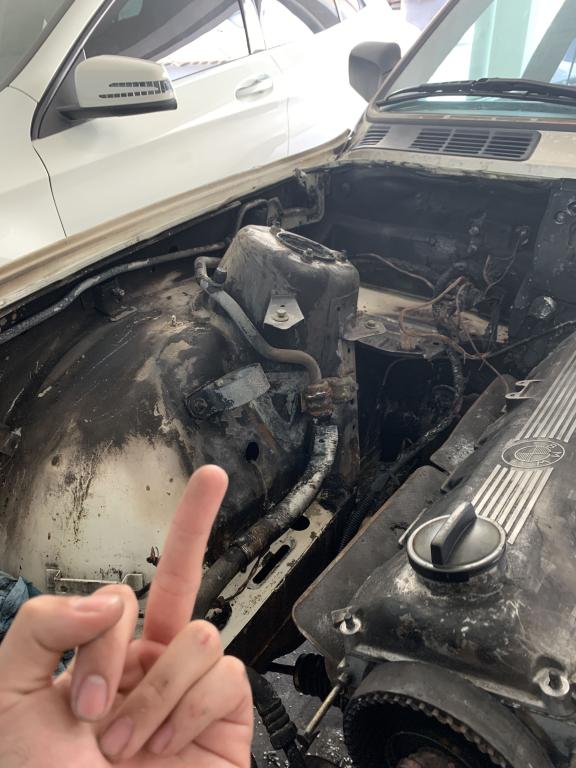

    Here are some more photos: after I removed the burnt stuffs (left), after I cleaned the engine bay (middle), and the culprit (right):
    Click image for larger version  Name:	IMG_4553-min.jpg Views:	4 Size:	81.4 KB ID:	10064159 Click image for larger version  Name:	IMG_4720-min.jpg Views:	3 Size:	136.1 KB ID:	10064157 Click image for larger version  Name:	IMG_4715-min.jpg Views:	4 Size:	67.0 KB ID:	10064158
    • moatilliatta
      • 6149
      Bummer but glad to see a rebuild happening!
      Usually the cold start valve leaks fuel causing a fire on the passenger side.
      Coil brackets can tear landing on exhaust and grounding out ign power making things toasty there.

        • 808ETA
          • Nov 2018
          • 435
          Damn that’s crazy. The fireman was wild for the selfie but I do give them extra credit for the smooth hood cut.

          • Panici
            • Dec 2009
            • 2462
            Did your car have the "fuel cooling system"?
            Possible candidate for fire.
            https://www.realoem.com/bmw/enUS/sho...diagId=16_0301

            • ASEHugo
              He was really cool about the picture and made sure that I was okay with it but definitely on the wilder side LOL!
              The hood cut was pretty nice all things considered and looks a bit like those hood cuts showcar guys do to show off their bays. Small over cuts on the fenders but all fixable!

                Possible, but I don’t think so. That line in the picture you sent looks like mine except for that module or valve or whatever in the bottom left, the side that enters the cabin. Was that a factory option or something? What cars came with it? What did it do…?
                • Panici
                  • Dec 2009
                  • 2462
                  It was an exercise in over-engineering. They were using the AC system to cool the fuel before it hit the fuel rail.
                  Only existed on a limited number of cars, so I guess that makes it a rare option. I threw mine out

                    Hey R3v, it's been a while! I just recently realized I didn't post any updates! How could I...
                    We last left off with me showing my burnt engine bay the bird, but I have since rethought the source of the fire. I believe moatilliatta is correct in that the cold start injector was likely leaking, which started the fire, and the pop I heard wasn't the fire starting but rather the AC line popping due to the heat in that area.
                    A detail I didn't mention at the time was the day after, once I had time to recover, I put the car up on jack stands and turned the motor over by hand, to verify that any and all repairs attempts would be worth it and I wasn't in need of a replacement engine. It hit me how awesome of a resurrection this could turn out to be, so in my post-cleanup excitement, I clearcoated the engine bay to lock in the soot forever.

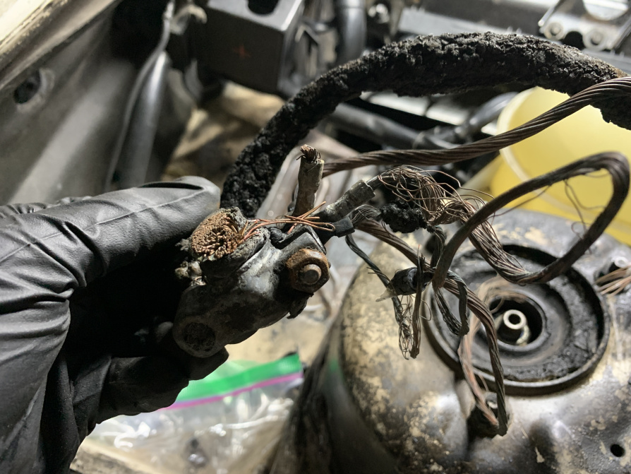

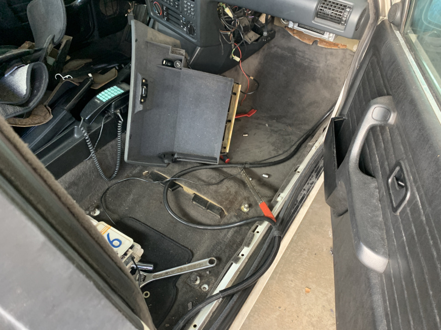

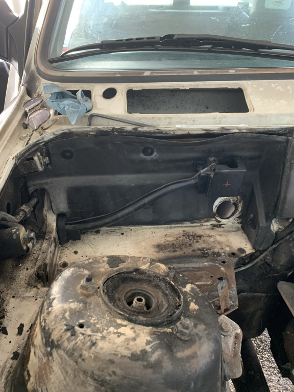

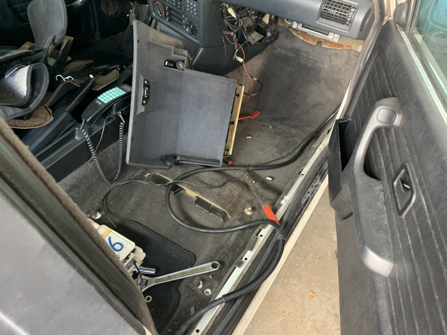

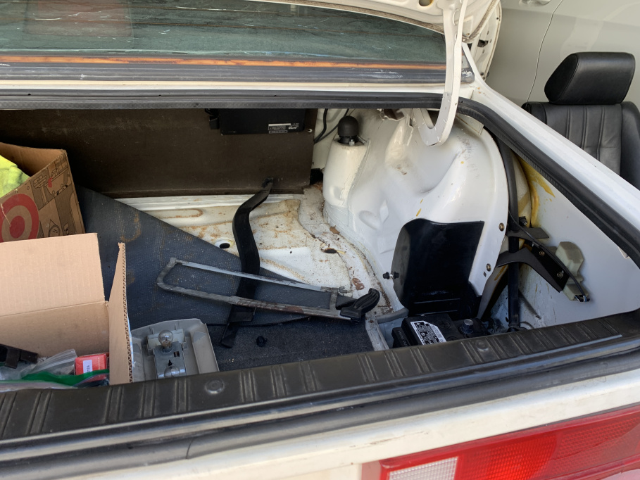

                    I was very lucky the fuse box and chassis harness on the drivers side were functionally unscathed, but the battery ground hub on the passenger side did not fare as well. My car has the battery in the trunk and therefore has the longest and thickest ground cable I'd ever seen running through the firewall all the way back to the trunk. Since the engine bay side burned to a crisp, the whole cable needed to be replaced. This involved some light interior disassembly but was not bad overall.
                    Click image for larger version  Name:	IMG_4761.jpg Views:	0 Size:	253.1 KB ID:	10128533Click image for larger version  Name:	IMG_4762.jpg Views:	0 Size:	247.4 KB ID:	10128534Click image for larger version  Name:	IMG_4764.jpg Views:	0 Size:	198.3 KB ID:	10128535Click image for larger version

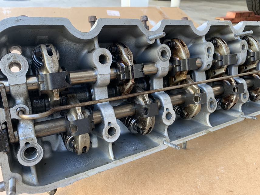

                      2.7i time! Huge thank you to kenika65 for the exhaustive write-up. I'm the kind of person that prefers to measure 3,764 times and only cut twice, so being able to pore through that thread and determine every single part, gasket, bolt, etc. that I would need for my setup was very welcome. It all begins with an 885 cylinder head from an M20B25, so off to FB Marketplace we go, and I happened to find a very very nice example for only $200!
ID:	10129308Click image for larger version

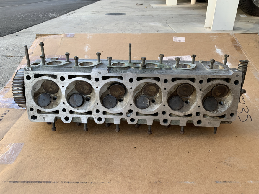

                      Being a complete novice, I took the internets advice and brought the head to a shop to be pressure tested. My negligence in updating this thread is coming back to bite me now because although the head pressure tested well, I cant remember what the shop said about it's mating surface wear (how much its been decked). Also, due to the budget nature of this restoration, I did not have the head rebuilt or decked (as I understand it, the valves must be removed in order to get them sufficiently out of the way) but I'm pretty sure I had them check its flatness and it was within spec. Score!​​ I took a look at the old timing belt, which wasn't that old as I had replaced it about 7 months/~4,000 miles before, but thanks to FCP Euro's Lifetime Warranty, I decided to redo all the preventative maintenance I had done before as...preventative maintenance. The block behind the timing components was singed and gross so I cleaned that up and got to work removing the old, likely original cylinder head.
                      Click image for larger version  Name:	IMG_4963.jpg Views:	102 Size:	232.0 KB ID:	10128542Click image for larger version  Name:	IMG_4967.jpg Views:	102 Size:	220.2 KB ID:	10128543Click image for larger version  Name:	IMG_4970.jpg Views:	101 Size:	216.1 KB ID:	10128544​​​

                      • Panici
                        • Dec 2009
                        • 2462
                        Neat idea with the clearcoat!
                        Glad the engine can be saved.
                        A point of clarification: That's a +12v power wire running back to the battery.
                        The entire chassis is used as a ground, there is no dedicated ground wire running front-to-back.

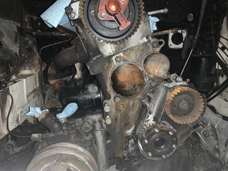

                          If you're still in there, replace that stamped cam gear and intermediate gear with the later sintered versions because they're both known to fail
                          IMO now is the perfect time to swap to the late model cooling setup as well.

                          • ASEHugo
                            • May 2021
                            • 37
                            I've messed around in the battery area so much I should know that lol but every time I see a large black cable coming from the battery my mind goes to ground (pun intended). Thanks for the clarification :)

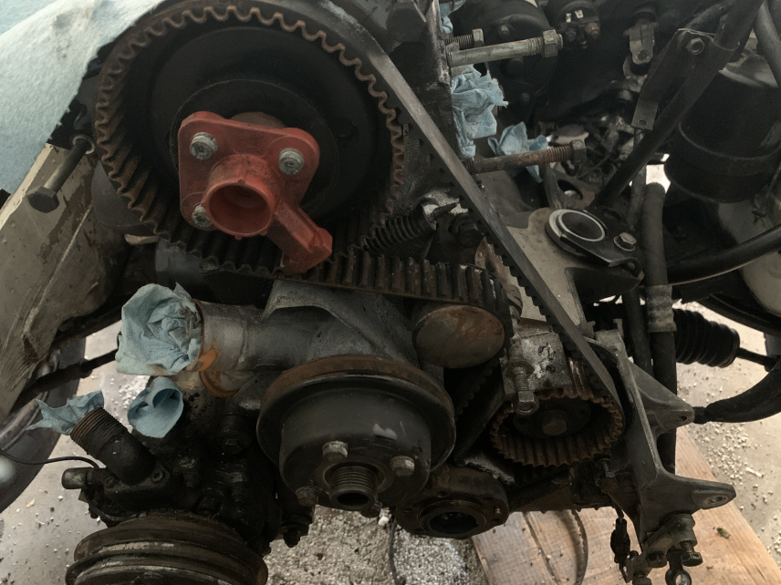

                              I should clarify that I'm catching this thread up on the progression of the rebuild, but yes, while I was in there I upgraded to a late model thermostat, radiator, and hoses but retained the early model water pump and expansion tank so I didn't need the crossover.

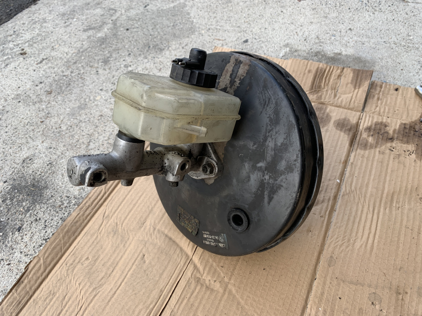

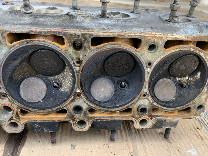

                              At this point, I was able to remove the brake booster which I'm going to safely assume has some internal damage, and was likely original to the car so due for replacement soon anyways.

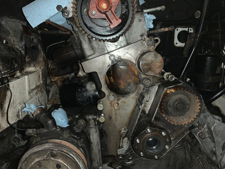

                              With the old head removed, I can take a look at the pistons, carbon galore. At the time I was doing this, I had no experience in engine disassembly so removing the head along was terrifying enough that I didn't clean the pistons much for fear of damage (if only I'd had this thread up to date at the time!).

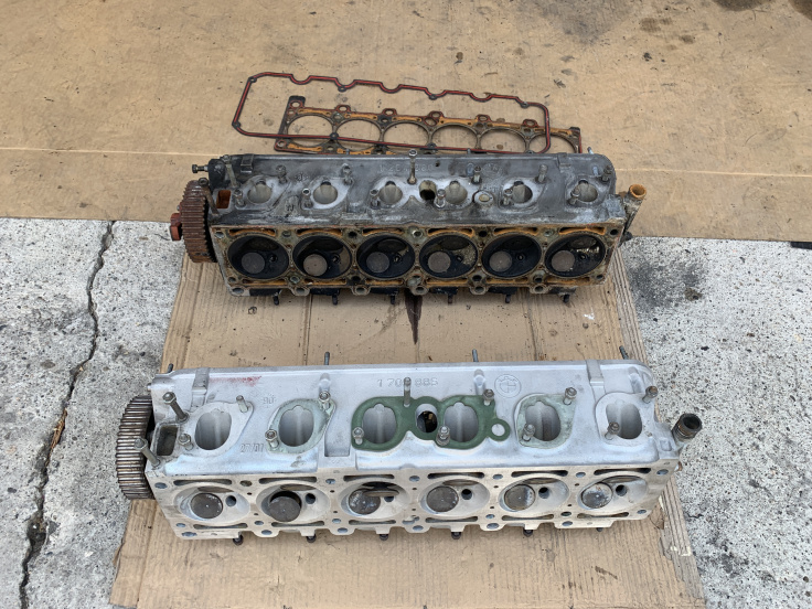

                              Here's the old head next to my shiny "new" 885 head, oof. Look at those rusty coolant passages!
ID:	10129306Click image for larger version
