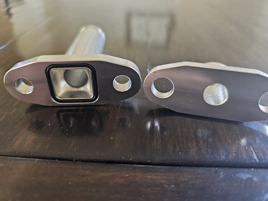

      Bought a new oil drain fitting. Per varg suggestion the turbo was probably having problems draining oil. You can see a difference in the picture, new one on left, old one on right. Won't get me any performance gains but should help longevity and get rid of those high rpm puffs of smoke maybe.

        Take a peek at TurboSmart.com I just picked up a turbo oil regulator. I think you Varg and I have all been battling the same issue. (maybe) ?? Ive tried three different drains and restrictors and after my tuning session I still have a puff of smoke as well.
        Worth a look at least. It regulates the oil pressure no higher than 40psi no matter the engine speed. The idea is without the pressure regulated you end up with too much volume in the turbo and oil gets past the turbo shaft into the compressor and turbine housings.
