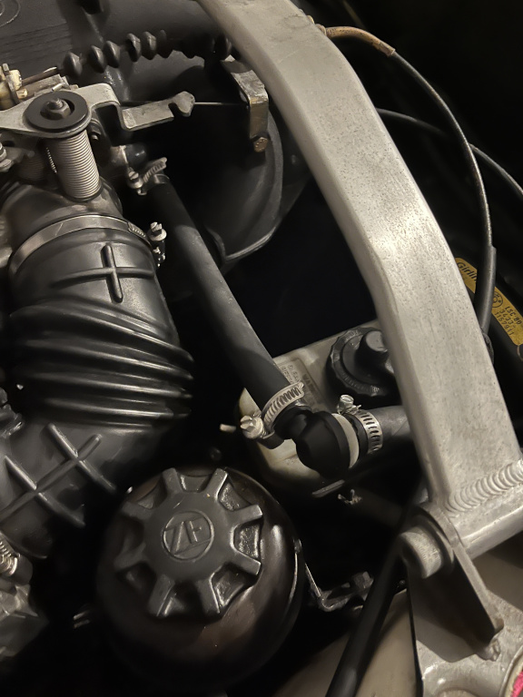

              FCP euro had the incorrect intake boot for the car. The one I was sent did not have the tube to allow air into the brake booster. I’ve decided to convert to the simple brake booster setup used on spec E30s described below. If anyone sees a reason I shouldn’t, please share.
              Most of us have 3 vac lines going to a triple checkvalve which then goes to our brake booster. This can be replaced to a single vac line and a single checkvalve. The advantages are that you get to reduce the # of places that you might get a vac leak, and you end up with a $9 checkvalve instead of a $50 checkvalve. Vac leaks are the enemy. There’s a number of different rubber intake boot designs for the E30 over the years. Some used an L shaped Idle Control Valve (ICV) and some use a T shaped. ...
              The main issue is the fittings from the throttle body to the brake booster. One of them is broken off, and I can’t find an oem replacement anywhere. My efforts to seal it with Dirko and a vacuum tube cap have been unsuccessful. I suspect the bottom one is leaking as well. At this point, I need to just order a real smoke tester and find the leak the right way. This problem has already gone on long enough, I want to just do it right and be done.

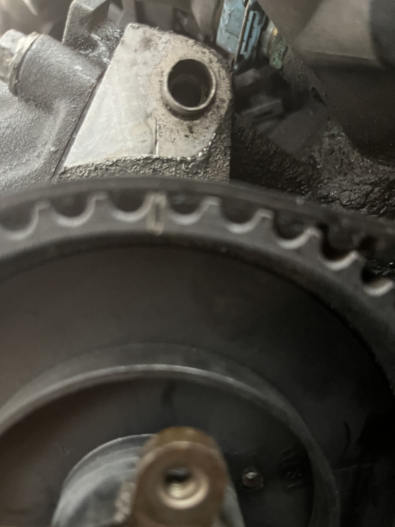

                            After some time driving it, I decided it was time to tackle the timing belt and the oil leak. I got the kit from FCP, as well as some other odds and ends to replace as many seals as possible. I didn't get any good pictures but it wasn't too eventful. The oil leak was 100% from the front camshaft seal since the entire timing cover was caked in oil on the inside. Anyway here's TDC.
                            Click image for larger version  Name:	IMG_1140.jpg Views:	0 Size:	124.5 KB ID:	10142200

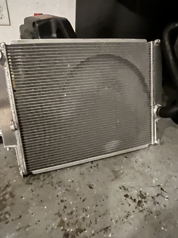

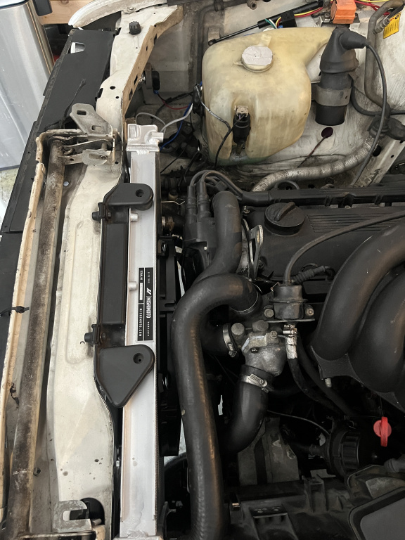

                              Cooling System Situation
                              With my fresh timing belt, new front tires, and upgraded radiator, I went back to autocross. After my first run on the way back to grid I saw a ton of steam pour out from under the hood (which I did put back on eventually). Digging around under the hood, I found that the fan had been contacting the radiator causing it to wear a hole through the fins.
                              Click image for larger version  Name:	IMG_1333.jpg Views:	0 Size:	213.4 KB ID:	10142753
                              I was pretty frustrated since I had noticed that the Mishimoto radiator was much thicker than the OEM. I ordered the E30/E36 radiator, which they guaranteed would fit without issue. When I reached out about the lifetime warranty, they told me it was my fault and refused to cover the radiator (which had been used for only a few hours of driving at this point). Has anyone else had this problem? I double checked that it was seated in the plastic holders at the bottom. I have no idea what caused the issue in the first place, but I begrudgingly ordered another radiator, this time along with a 16in electric fan and fan controller kit. Installation was simple, although the Mishimoto fan mount kit was absolute garbage. I have learned my lesson with Mishimoto and I will not do business with them again. As of now, the car has STILL not been tested on the street with the new cooling system, but I have verified the sensor is working and the fan kicks on automatically.
                              Click image for larger version  Name:	IMG_1531.jpg Views:	0 Size:	198.5 KB ID:	10142752
