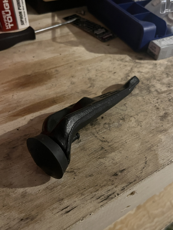

    Bad motor mounts allow the engine to move forward under hard braking.
    BMW put a limiter in place that attaches to the bottom of the bellhousing and hits the subframe to prevent this from happening when the engine mounts fail, but the rubber damper on the limiter is typically missing, allowing the fan to ruin the radiator.

      I suspected that may have been the case. I should probably still fix this so the water pump doesn't destroy my new fan. Thanks for the insight!​

        Yup, I definitely wouldn't do another autox without doing engine/trans mounts.
        The stopper/limiter is 11811132177​ and the rubber buffer for it is 11811132527 BTW. May be worth inspecting/replacing what you don't have while you're down there. ​​

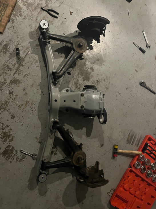

          Rear End Rebuild (Part 1)

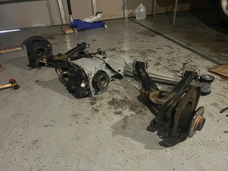

          I've been working on rebuilding the rear end for the last few months. I never thought it would take so long, but here we are. As of today, the car is finally back on the road. But let's start from the beginning.
          On 2/22/2025 I took the E30 on a long drive through the Smokey Mountains with some friends. It was a ton of fun, and it revealed a number of issues with the car. The main one, both in performance and safety, was the rear end alignment. During hard left turns I could hear the rear right wheel rubbing on the inside of the quarter panel. But when sitting still, it was nowhere close. The trailing arm bushings were so destroyed that you could feel the alignment change during the corner. I was worried that simply replacing them might not fix the issue, since I suspected that something was slightly bent. There was a noticeable toe out on the right side, and the negative camber was significantly more on the right as well. Some previous owner must have had a run in with a curb. Also, I wanted to be able to remove the camber resulting from lowering the car. After doing a lot of research, I decided on the serrated camber and toe adjusters from Garagistic. I figured that since the diff was leaking, I'd may as well fix that too.

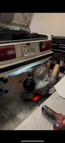

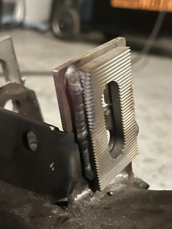

          But at this point, I had not welded in nearly 10 years, I didn't own a welder, and I had only a general idea what I was doing. But I decided that there was no good alternative and that it needed to happen. I picked up a cheap MIG welder off marketplace, jacked the car up and dropped the subframe.
          I did not get good pictures of this process (I will do better with future endeavors) but I used a torch to get the bushings out. I picked up a scrap mustang subframe from a local bodyshop and practiced cutting it up and welding it back together. Once I was feeling confident, I welded the tabs on the subframe.
          I went all the way around, grinded them down, and went again. I'm pretty happy with the quality of my welds given that I have no actual training and not much practice. The most time consuming part was using a Dremel to clearance the inside of each tab. After hours of dremeling, I sanded the whole thing down and painted it with POR15. Then I pressed in all the bushings, replaced the axle seals on the diff, and resealed the cover. I put the tabs near the stock locations and installed the trailing arms and diff to the subframe, then lifted the whole thing into the car. I was so excited, thinking I was nearly done. I was not even close to nearly done, however.
          Part 2 soon, I need to take some pictures for context. But the car isn't in the garage at the moment (not complaining).

            It looks good. Welds should hold.
            keep up the good work.
            Last year I did my camber plates on rear subframe. Yes it took some time to grind and get fitment correct.

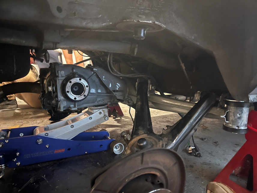

              Rear End Rebuild (Part 2)
              After hours of grinding, painting, and teaching myself to weld I finally had an adjustable subframe.
              Click image for larger version  Name:	IMG_6041.jpg Views:	0 Size:	181.5 KB ID:	10146759
              Click image for larger version  Name:	IMG_6040.jpg Views:	0 Size:	188.1 KB ID:	10146768
              As I installed it in the car with help from some friends I quickly realized I had an issue. There was no way to get to the outside of the toe adjusters because they were pressed up against the subframe bushings. I was hoping to just toss everything in and limp the car to an alignment shop, but there was no way the move the toe without dropping the subframe again. This is the main reason this project took nearly 6 months. I spent many afternoons dropping the subframe, hammering the trailing arms in or out slightly, then reinstalling and checking the alignment.
              Click image for larger version  Name:	IMG_6042.jpg Views:	0 Size:	190.4 KB ID:	10146767

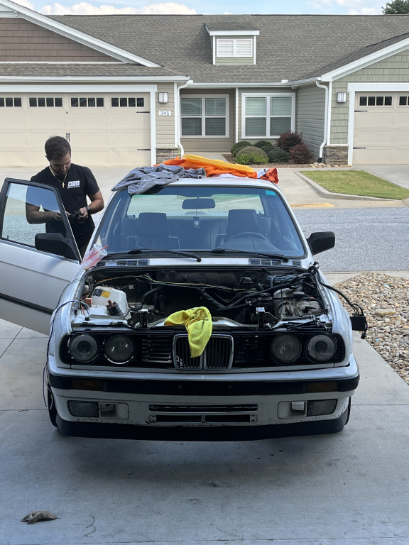

                Cooling Situation Again
                I was expecting the engine tilting problem to be caused by the engine mounts, but they looked to be in good condition. I checked the trans mounts and sure enough, they were badly cracked and almost definitely causing issues.
                The stopper/limiter is 11811132177 and the rubber buffer for it is 11811132527 BTW. May be worth inspecting/replacing what you don't have while you're down there. ​​
                I got these parts installed, but I was worried that they wouldn't do much to stop the engine from pivoting about the engine mounts.
                I did something extremely stupid. I was really excited to take the up to SlammedEnuff Gatlinburg to run the mountain roads of Tennessee with a bunch of friends. After getting the refreshed axles in and torqued with loctite, I took the car for a test drive. I was planning on replacing the trans mounts before I left, but FCP sent me the wrong part, so while I was waiting for the replacement to ship out, I decided to test the car in the mountains to double check the rear end anyway. I was with a friend on a motorcycle, and when he stopped suddenly to take a turn I stopped a little harder than I needed to (being extra careful) and felt the engine move. But I thought between the stopper and the electric fan it wouldn't be a big deal. I was wrong. The engine pushed the fan into the radiator and the center shaft of the fan shredded the middle of the radiator. I didn't notice until the car was overheating.
                I have no one to blame but myself at the end of the day, but this is just so frustrating. I am now ordering my third aluminum radiator. This time I will be breaking the mishimoto curse and buying a CSF. But there is no way to get one before the event :(

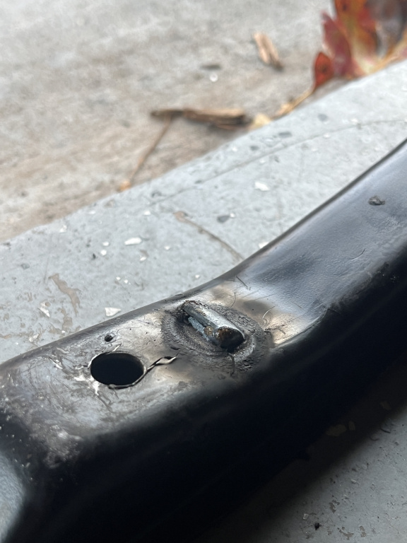

                        Click image for larger version  Name:	IMG_1772.jpg Views:	5 Size:	138.2 KB ID:	10149902
                        I filled in the back of the larger one with some weld to make sure I wasn't weakening it by removing material. I threw some self etching primer over it and installed everything. No issues so far!

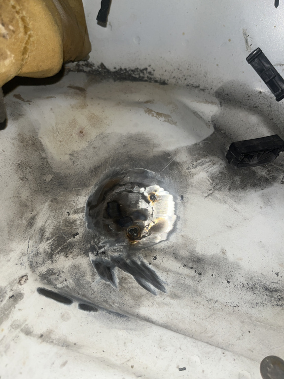

                        Also, I decided it was time to address the rust in the passenger floor. I pulled the seat and moved the carpet, then cleaned up the holes with a flap disk and a dremel.
                        Click image for larger version  Name:	IMG_1727.jpg Views:	6 Size:	207.1 KB ID:	10149906

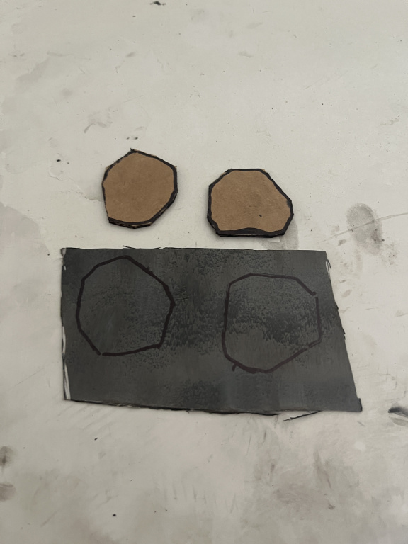

                        I used a piece of cardboard as a template, and cut out patch panels that fit perfectly into each hole. I cut them out of a twisted corolla hood I got for free at a local body shop.
                        Click image for larger version  Name:	IMG_1730.jpg Views:	7 Size:	104.2 KB ID:	10149904

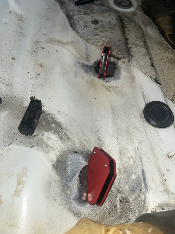

                        After some dremeling the edges, they dropped right in.
                        Click image for larger version  Name:	IMG_1732.jpg Views:	8 Size:	178.3 KB ID:	10149903
                        Then the hard part. It took some practice to weld them in without blowing a hole straight through. Keep in mind my welding skills are from a metal shop 4H group when I was 12 and youtube university. I found that making a quick circle, then waiting a few minutes for the metal to cool worked best, slowly going around each panel, then using a flap disk to flatten in down. After it look convincing I shined a flashlight through the top and went at it again from the bottom. The flashlight makes it easy to find the pinholes between welds. It was significantly easier to weld from the bottom, which surprised me. I used a dremel to clean up the weld boogers on the bottom, then used to degreaser on both sides. I used self etching primer on top and 3M undercoating on the bottom.
                        Click image for larger version  Name:	IMG_1742.jpg Views:	8 Size:	181.7 KB ID:	10149905

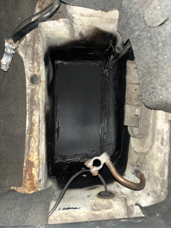

                          After my success with welding in the floor patch panels, I decided to tackle the battery tray. Half way through this process I moved, which made it take a little longer than it should have.
                          The situation...
                          The battery tray was by far the worst rust on the car. So I chopped it out.
                          Click image for larger version  Name:	1.png Views:	0 Size:	138.2 KB ID:	10157390
                          After hours upon hours of cleaning, grinding, and cutting, I could start adding again. I welded in 2 separate patches, one on the side by the frame rail and one to replace the floor.
                          This is about half way through welding it in. I realized that it would be super difficult to get a watertight seal all the way around just by welding, so once it was strong enough to stand in I used seam sealer.
                          From the factory, there was a support bracket which attached to the plastic battery holder. I cut a piece of angle steel and welded it to the back such that the plastic could rest on that instead. Everything got metal etch, etching primer, then 3M undercoating. And the bottom got a layer of fluid film.
                          Click image for larger version  Name:	2.jpg Views:	0 Size:	177.0 KB ID:	10157389
                          The finished product

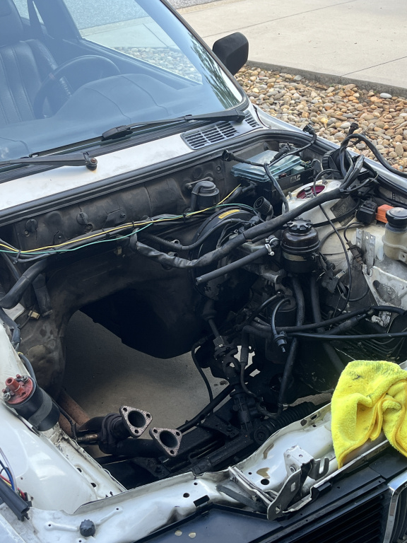

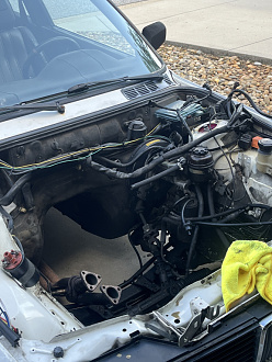

                            Engine Update
                            My engine repair adventure started with finding a new head. My plan was to replace the head, clean the cooling system and get back on the road. Plans changed when I drained the oil. It looked like a peanut butter milkshake. I was worried that there may be damage to bearings, and I knew I would never clean that junk out without pulling the engine anyway. The gentlemen I was buying the head from had mentioned that he had a built bottom end that needed a refresh, so I decided to check that out as well. That bottom end was a 2.9 built by Metric Mechanic, with 86mm deep pocket pistons and a 2.7 crank. The story was that the engine had a fuel wash issue, and the cylinder walls were glazed and scored enough for it to lose compression. I got the head and bottom end for $1200. I am in the process of rebuilding the bottom end from scratch, reusing only the rotating assembly. The head is rebuilt and ready to go, I have all new silicon coolant hoses, and I've cleaned out the inside of the radiator. Just waiting for piston rings and new rod bearings (cylinder 3 had some wear). Cylinder walls are honed and all measured to be perfectly round. Hopefully I'm finally getting close to having the car reliable and drivable. My poor E38 daily has been patiently waiting for its turn in the garage.

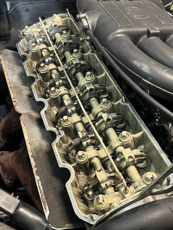

                                2.85 Stroker Updates
                                I come bearing pictures.

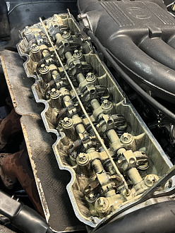

                                This was the situation with the old head...

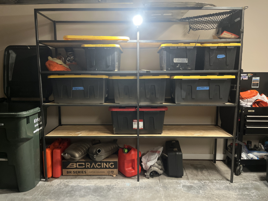

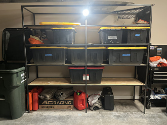

                                I built this badass shelf before I started the project to keep the parts mess under control

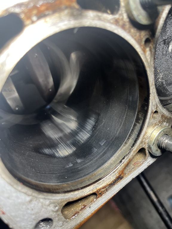

                                And this was the condition of the cylinder walls on the stroker bottom end. A quick ball hone cleaned them right up. I used a snap gauge to verify they were within round.
