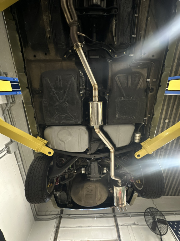

            Alright I found a local-ish fab guy to rebuild my midpipe with a vibrant ultra quiet resonator. He also pushed the muffler back 1.25" inches or so. Lastly he had to clearance the headers a bit to help clear the control arm bushing. Another Kpower L...
            Result is a much more acceptable tone. Still loud but not headache inducing. Sound clip here: https://www.instagram.com/p/DPzbMdOj6M3
