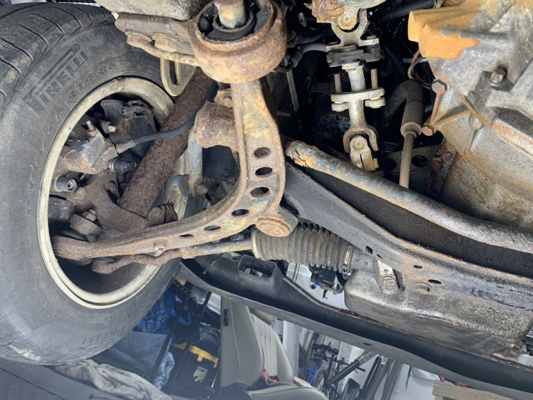

          I started to remove just about everything. If you've ever worked on a car like this you know the pain of rusty parts. Something simple like removing a lug nut was an hour long process on this car. You can see my special trick to get the gland nut off the strut here. My hope was to restore as many parts as possible without buying replacements. But some things were just too far gone. The trailing arms and subframe were totally roasted.

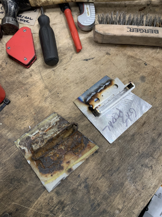

                Feast your eyes on the most gorgeous welds to ever grace the planet. Whatever, it works and you can't see them. It's pretty hard to weld to the thin panels of the car without blasting through. The floor was a great place to learn though because I had a few areas that needed to look good. I made all the patch panels using 18 gauge cold rolled steel. The various bends and shapes were just done with a vise, hammer and grinder. After welding, I coated all the seams with Eastwood seam sealer and then painted over with Eastwood rust encapsulator.

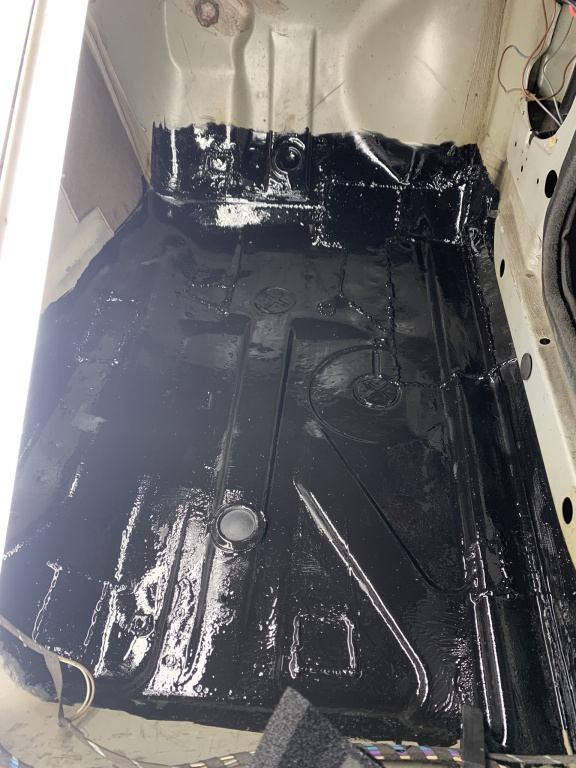

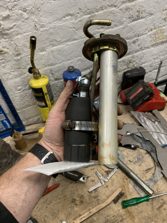

                    With all the rust sorted, I installed the new fuel tank, fuel lines and made the brake lines using copper and bubble flares. Lots of YouTube university to learn how to do this stuff. I took this opportunity to replace the 2 fuel pump system with a single high pressure pump. I know this is semi-controversial but it's worked well for me so far.

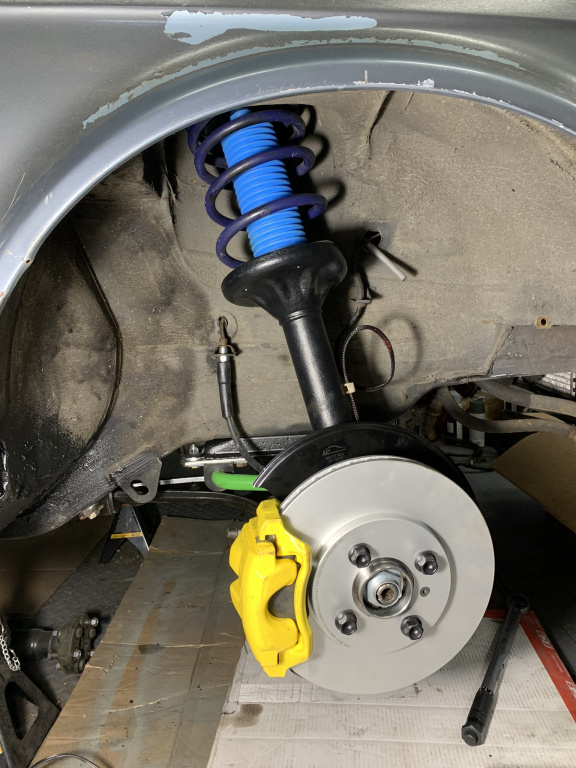

                        It was a really nice change of pace to actually be installing things back onto the car. All wheel bearings replaced, bushings (80A poly), parking brake system, axles, etc.
                        I also installed a z3 rack and solid steering coupler. Replaced the rotted fenders with a set from a florida car.

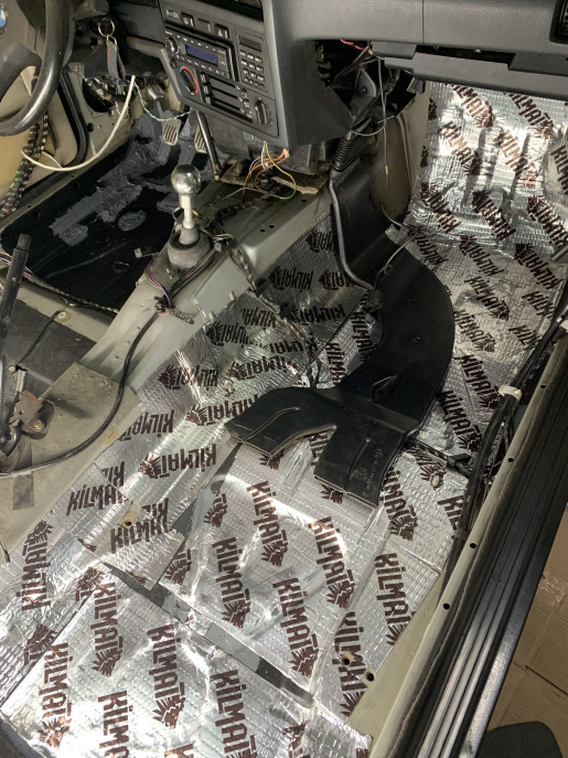

                          Got the interior all back together after finishing up the gas pedal mount. The actual bracket I got from Valca's Garage. I covered the floor with Kilmat after all the repairs.
