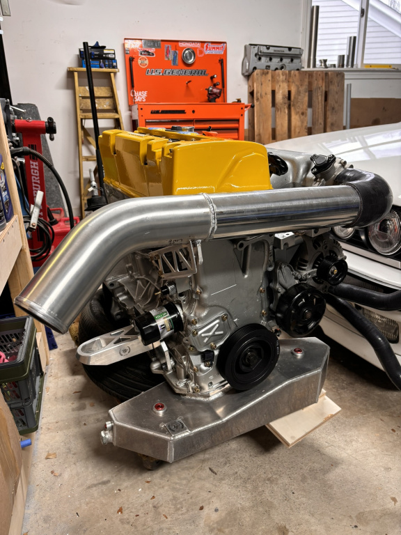

              Intake looking good. I'm not a tig welder so I'm gonna have a local guy help me out. Next up is pulling the motor so I can finally shave the bay.

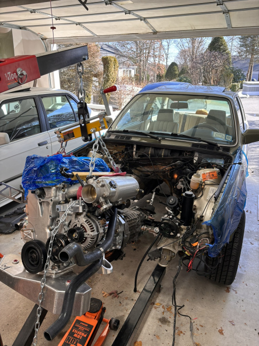

                Motor is out. Engine bay shave can begin, need to get mig gas and the kit from rageitparts. Intake came out super nice!

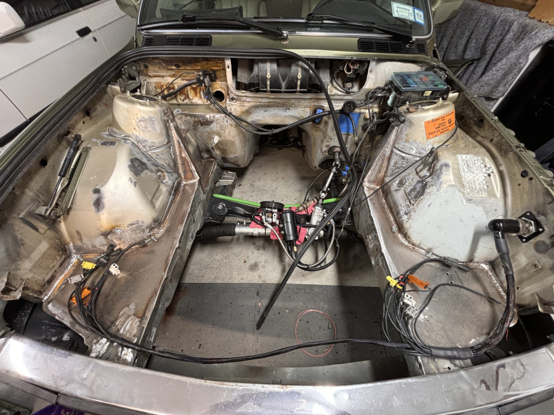

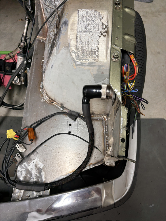

                          Going in for paint in 2 weeks. Saved some money by doing the majority of the welding myself. Got the wire tuck all sorted out using a bulkhead connector from Maven performance. Redid the whole harness, came out pretty slick!

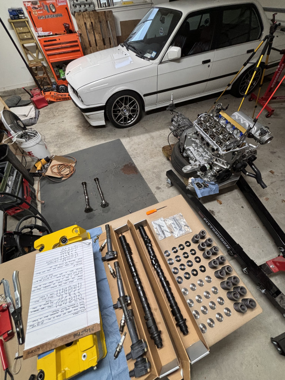

                                Car is off for paint. Meanwhile I installed Skunk2 “stage 2” valve train parts. Cams, springs, seals, retainers, etc.
