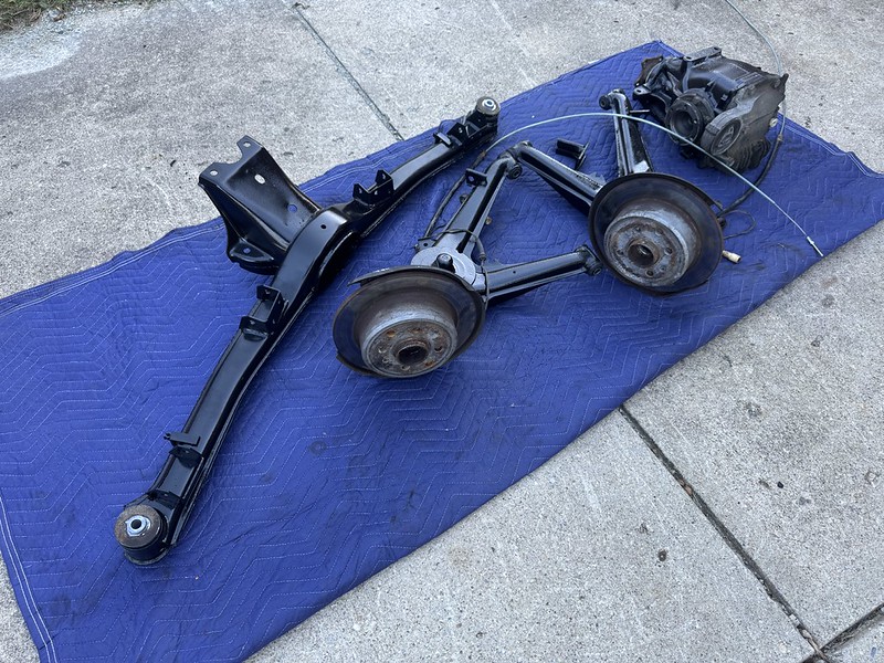

                    Final weekend update.... I've gone further off course, but at least it's all shiny now

                          I have the Forsvara subframe bushing tool and AKG trailing arm bushing tool- both make the job a breeze to remove/install! Would highly recommend them both
                          I've found the Febi trailing arm bushings are 1-2mm too big and don't install like they should. I switched to Meyle the last few times and they went in much easier.

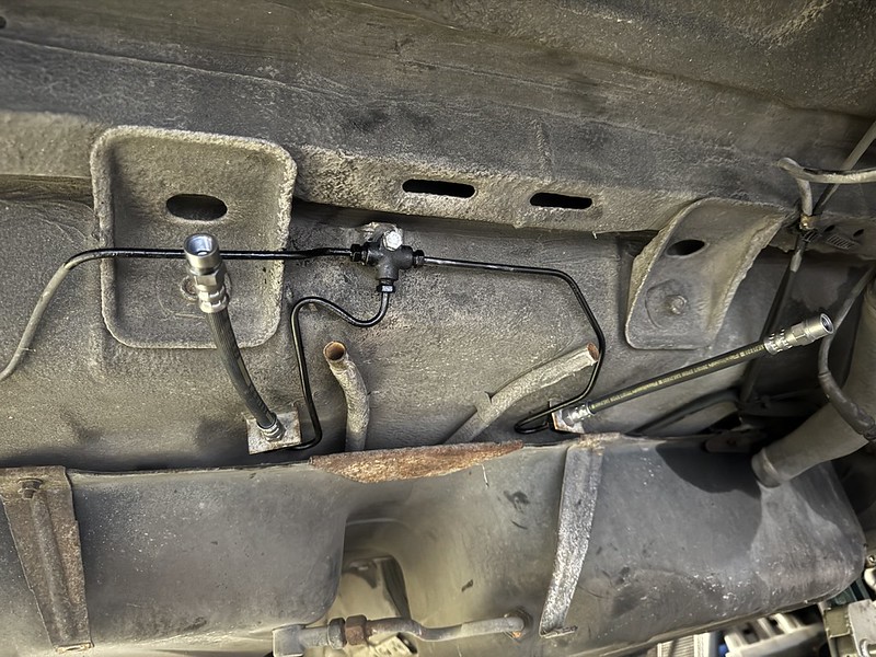

                          I told myself I'd only redo the subframe if I could get it back in same day. Once everything was out I started painting stuff which delayed me by a day, but two days to do all of this isn't bad. The factory coating was coming off of the brake lines above the subframe/fuel tank, so I cleaned/painted them. Replaced hardware with nicer spares where I could, all new Corteco soft lines, and its back in!
                          I also got the exhaust, auto trans lines, etc removed so all that's left are bellhousing bolts before I can drop the auto out.
