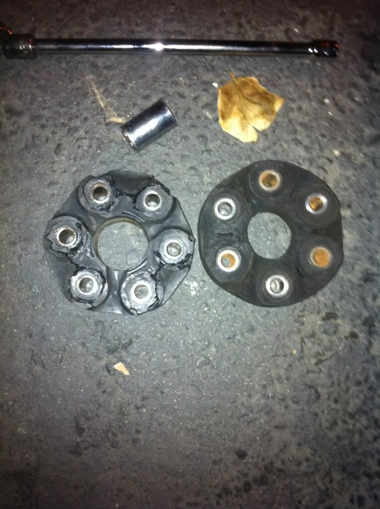

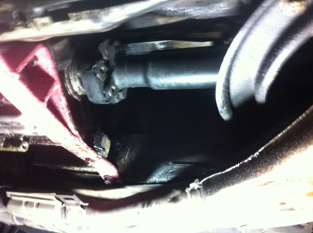

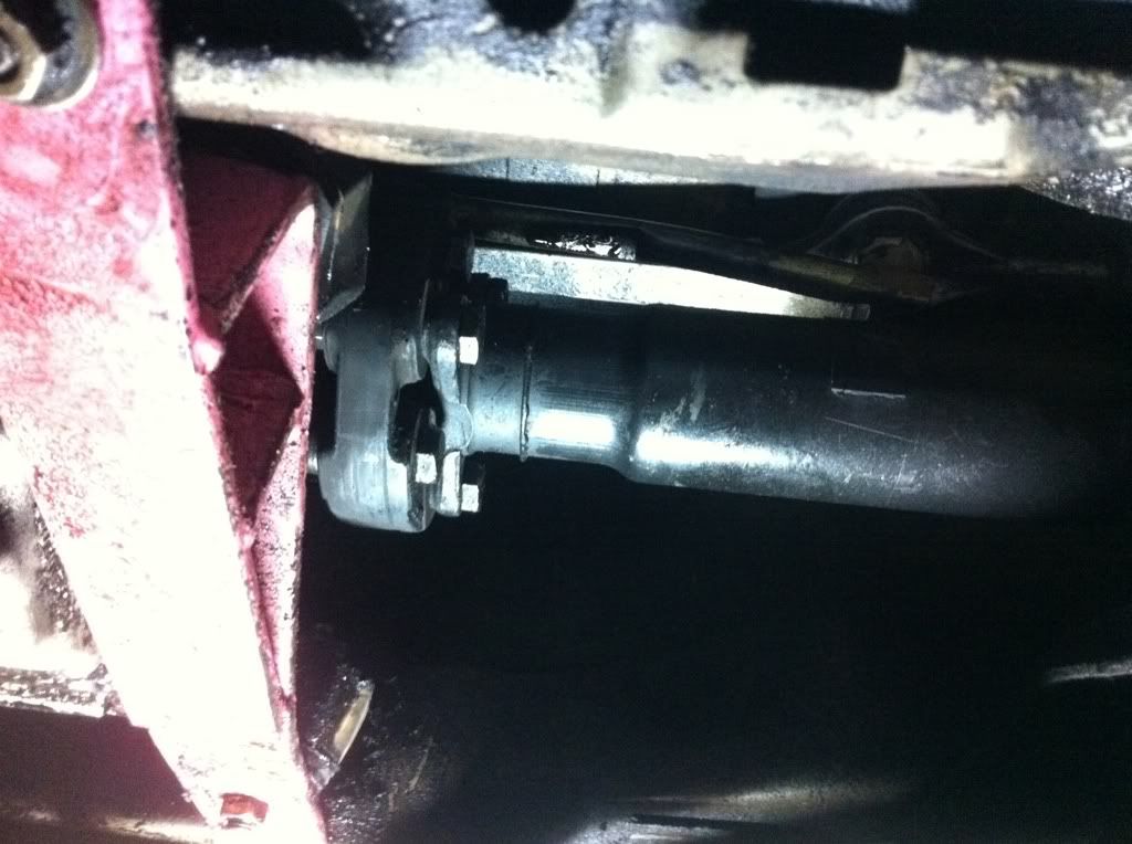

    I still had some vibration when I got on it, turns out I forgot to preload the CSB and this was the outcome
    Popped the spare guibo off Rory's parts car
    Much better... don't forget to preload your CSBs!

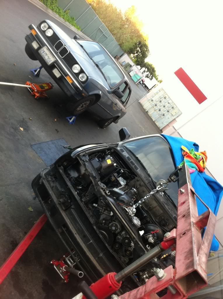

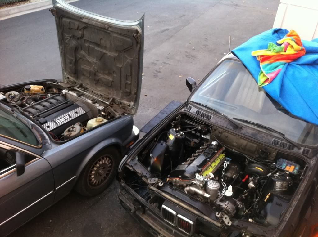

    Speaking of Rory, here's what we were up to on his car
    Cool beans.
    paint sucks

      What exactly do you mean by preloading?
          Move the CSB bracket forward before bolting it tight so it has tension.
          Its okay I dident know until a few weeks ago too :nice:

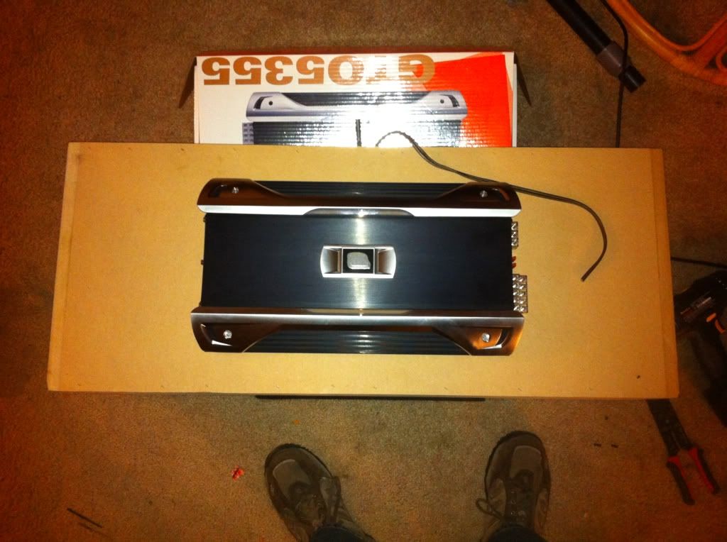

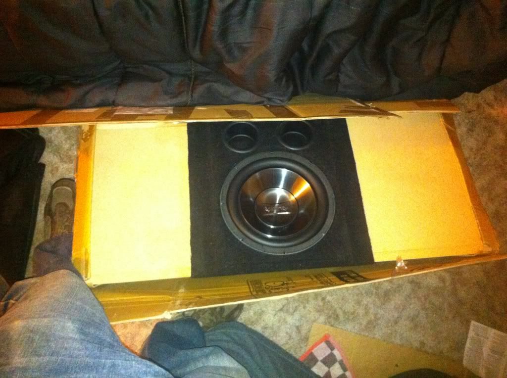

                            Anyway the install is coming along, I just decided to mount the amp to the box and make a carpeted panel with a cutout.

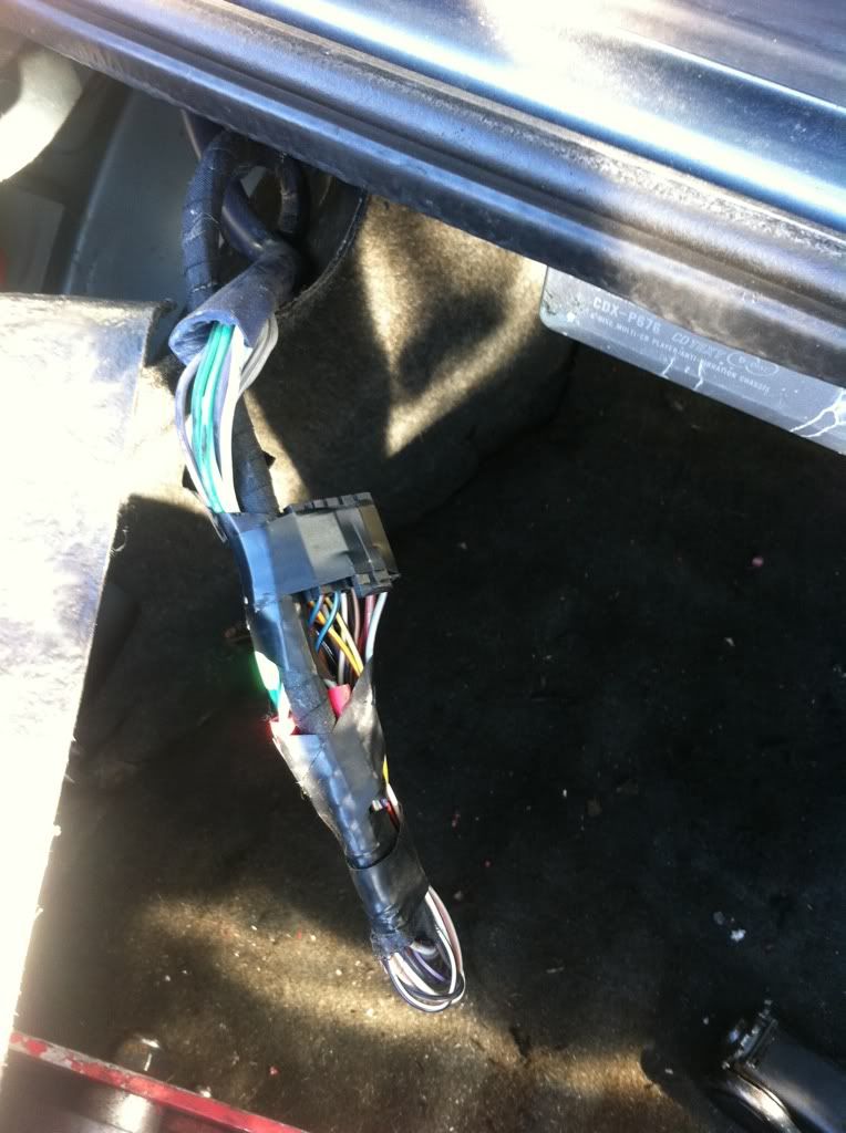

                            The previous install left the amp missing, luckily the wiring to the trunk is still there.

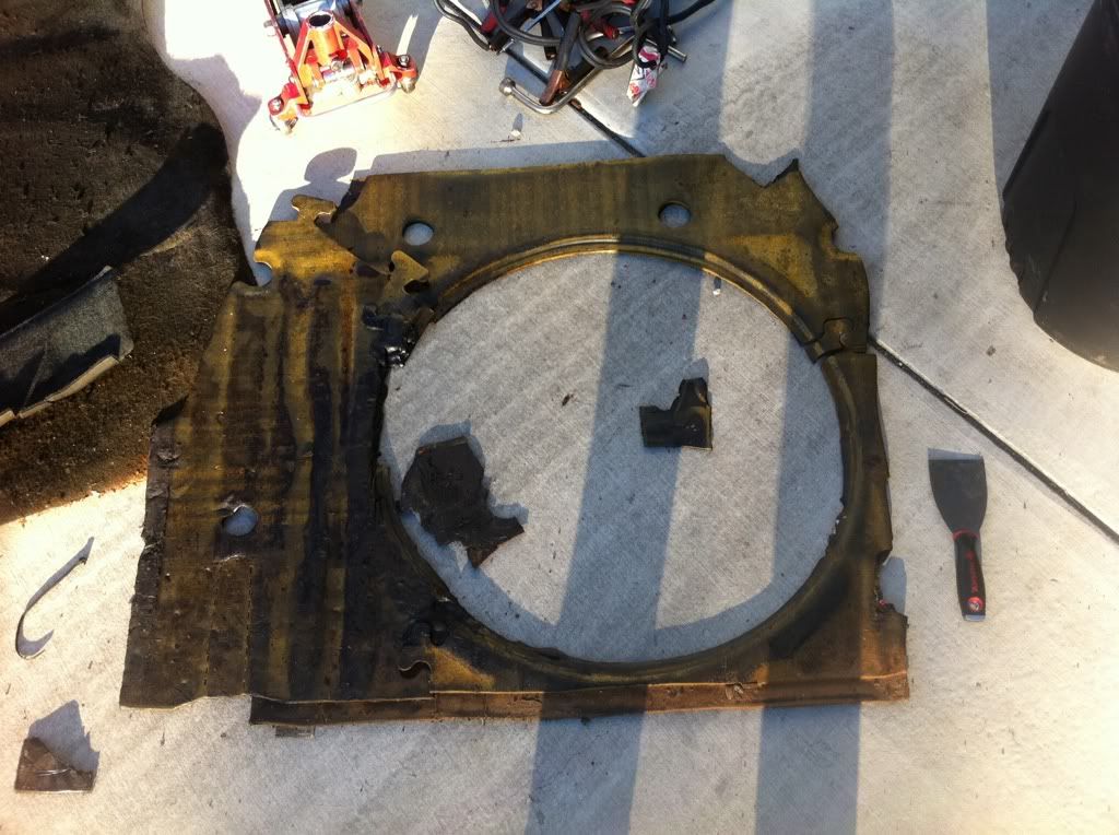

                            Trunk tar came out intact
