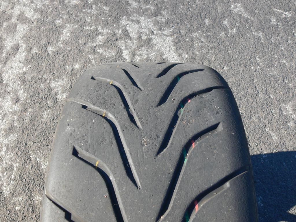

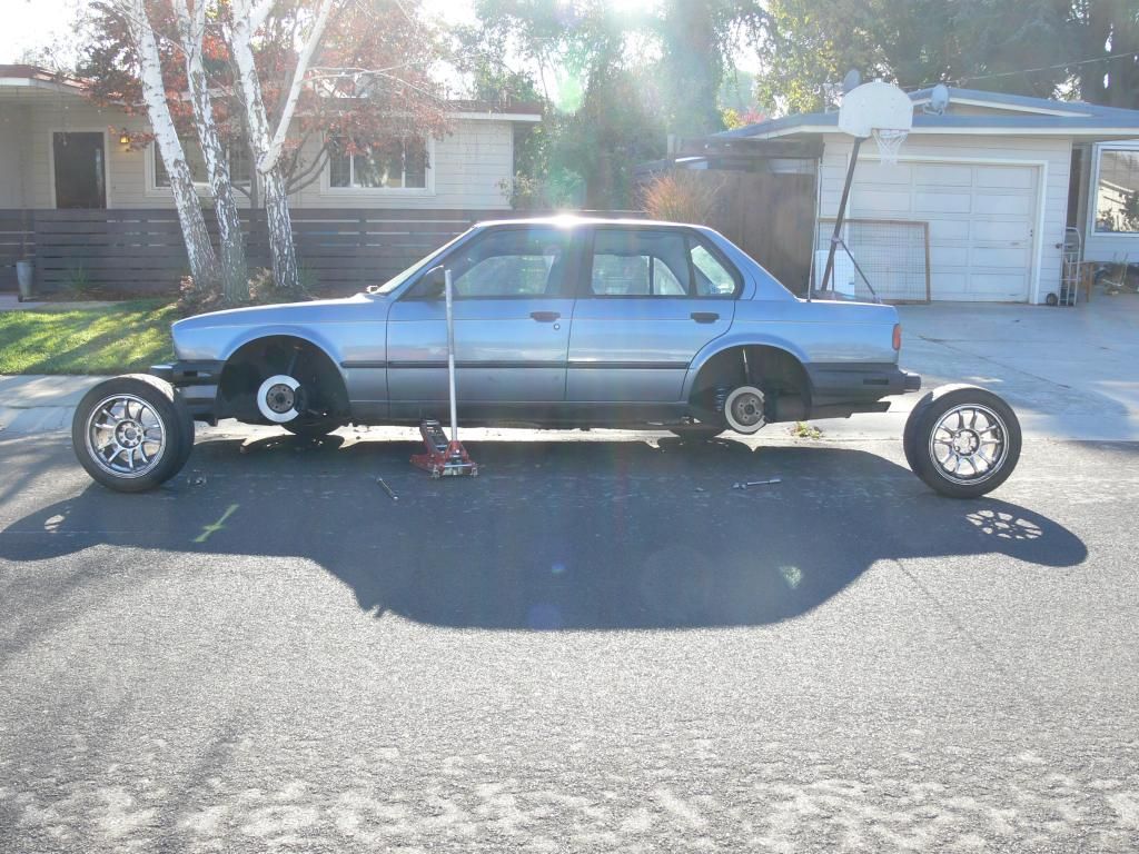

                            Rotating tires
                            This is how soft R888s are

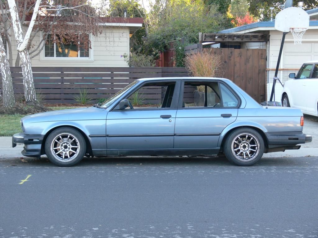

                            Sortaflush... offset is something
