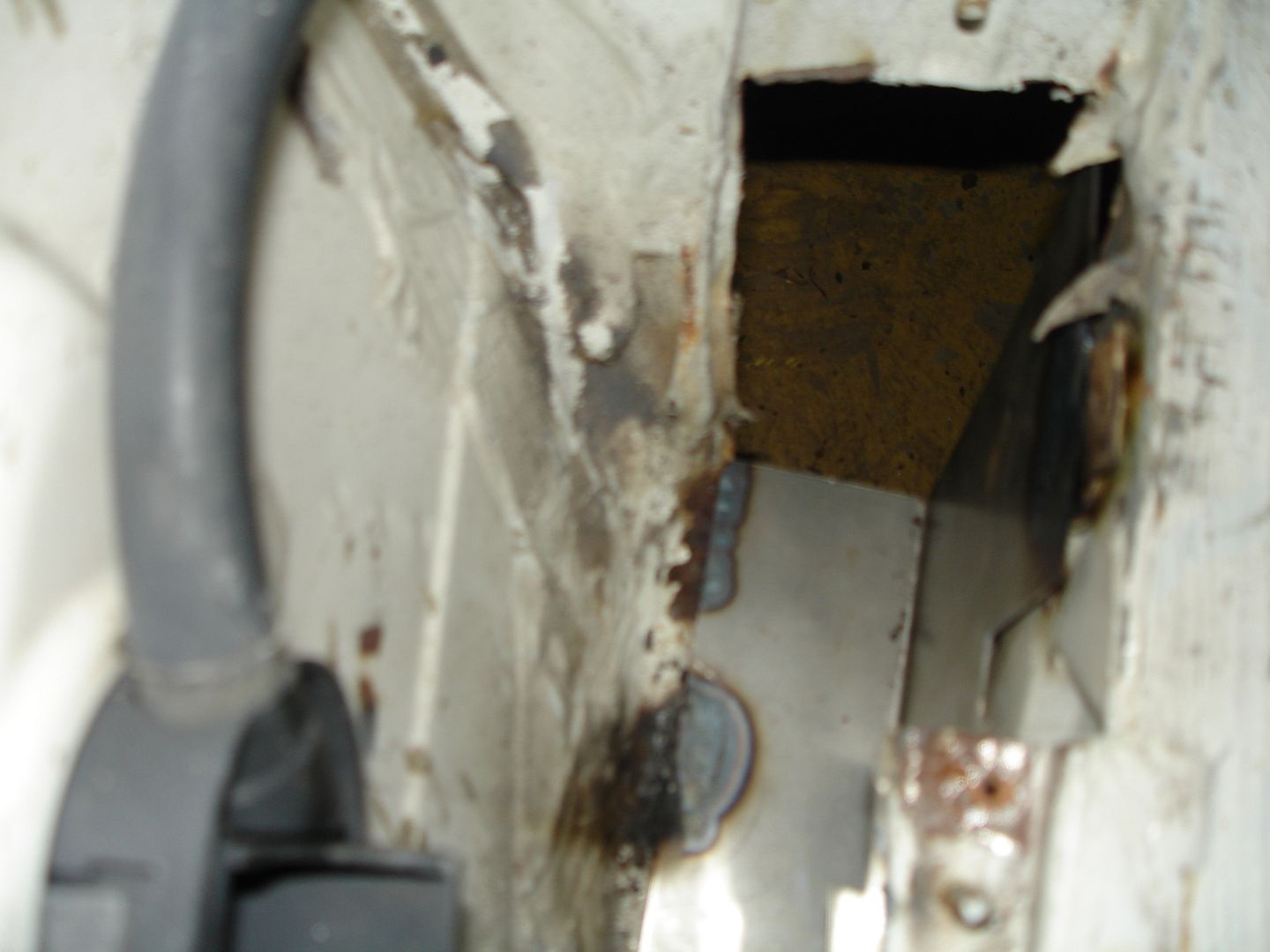

Finally got a chance to take the windshield out and see how bad my cowl rust is. Its not horrible but BMW still has the complete cowl metal for sale. At the price of $47.00 I figured instead of messing around with patches ill just replace the whole thing. Its on order and will be here in 2 or so weeks seeing as its coming direct from Germany.
The worst of it
Its all bubbled up infront of the dash too, so the dash will be coming out now, didnt really want to pull it, just another headache.
Josh has also been working on the L/R wheel well it had alot of rot in it.
This the first part of the two part patch. It is just lightly tacked on for now.
From the bottom.
The car as it sits right now, looks so pathetic
