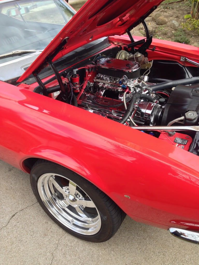

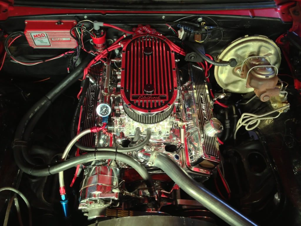

    And for the people that like hot rods...here's the other project getting worked on.
    327 bored .030 over (332cid)
    Dual 500cc Edelbrock Carbs
    262 Isky Cam
    Edelbrock E-210 Aluminum heads. (2.08" Intake, 210cc runners)
    ARP Hardware everywhere...
    10:1 Pistons...
    Put down 220whp/302wtq on the old stock heads and single shitty carb....it will see the dyno soon for tuning.
    It's noticeably running better/smoother/more powerful up top/torquier down low.
    It broke a stock motor mount already. So couldnt get a good burnout video...so here's some revs ;)

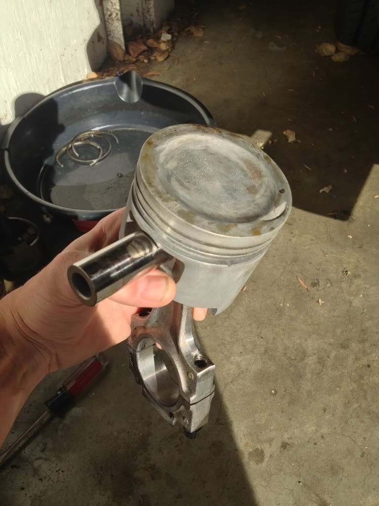

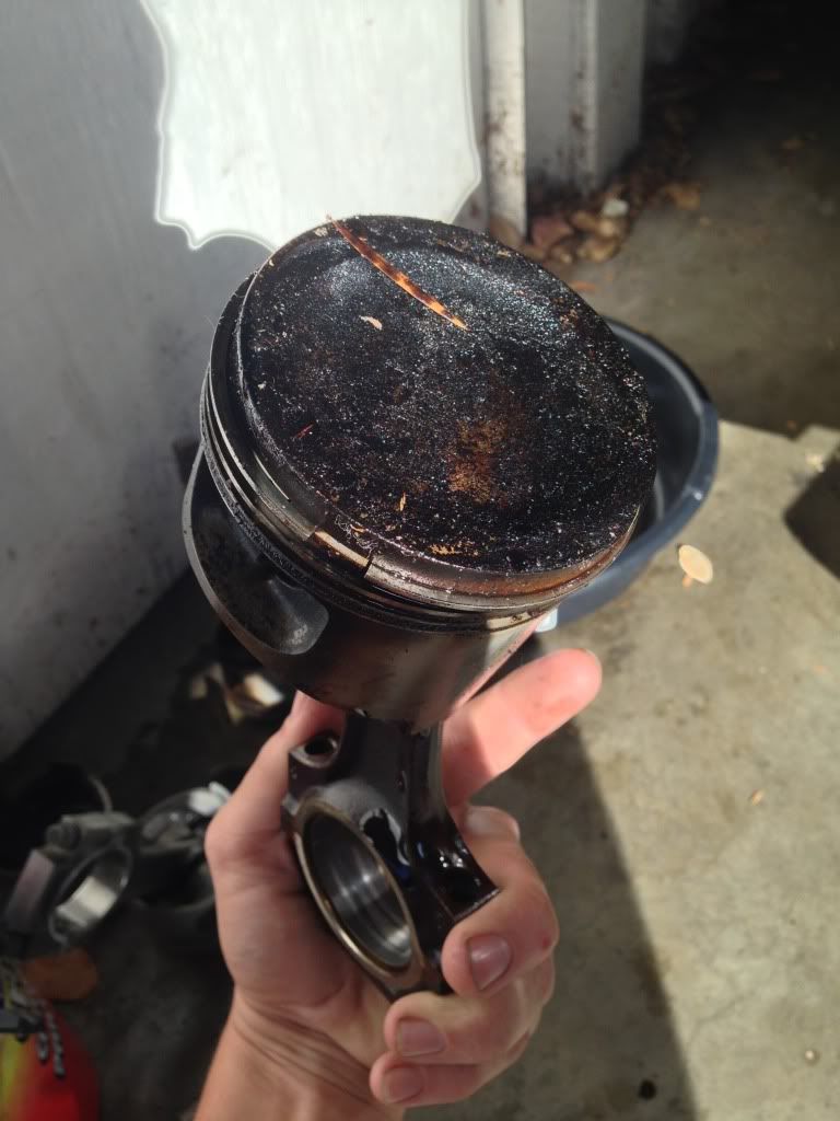

        First off, Berryman's chem dip works pretty darn well as you can see. The bucket says 15-30 mins..theyre high. Did nothing in that short amount of time...but over night...it cleaned em up great!
        Before:
        After:
        I'm cleaning up the rods/pistons, Gonna make ashtrays out of the pistons for myself and friends since I doubt anyone needs eta pistons, maybe try to sell rods heh.

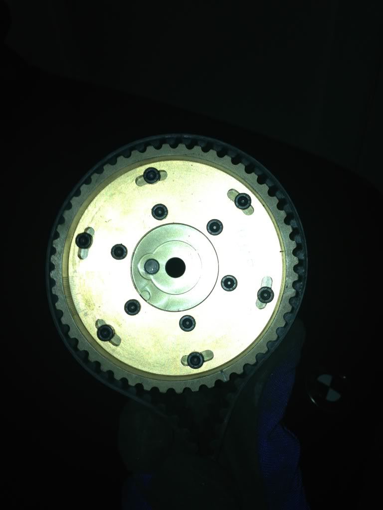

                So I have been busy with school so not much done. I've been playing with the head P&P.
                I want that porous part to be smooth just like the area next to it that BMW sanded right???

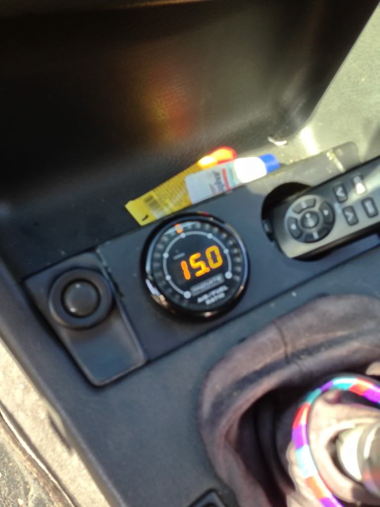

                Also changed the wideband o2 sensor for the mtx-l. you can get it at o'reillys for cheaper. was 51$
                a tad lean..it fluctuates from 14.5-15.0.

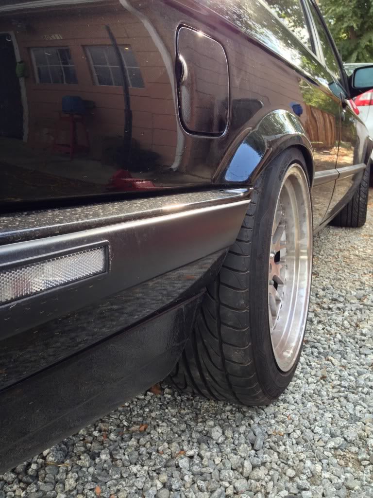

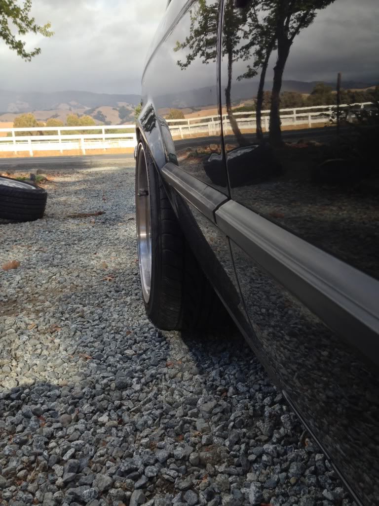

                I also tried on my friends wheels (16x9 et25) with a 225/45. I found a 10 mm spacer makes a 225 sit PERFECT in my rolled fenders. What you think? I've decided on the wheels I'm gonna get. Just gotta figure out if they'll fit the front...I'll tell ya this. I want 16x9 square.

                          I wish I had more pics those wheels were the ccw classics replicas. They're a friends, just tried them on to test offsets. I'd say its safe to say a 16x9 et25 fits with a 225/45 with no spacer on back with lots of room. The pics have a 10mm spacer with still enuf room
                          For no rubbing. Or maybe no spacer + more tire!
                          I didn't try the fronts. I plan to next time I visit my

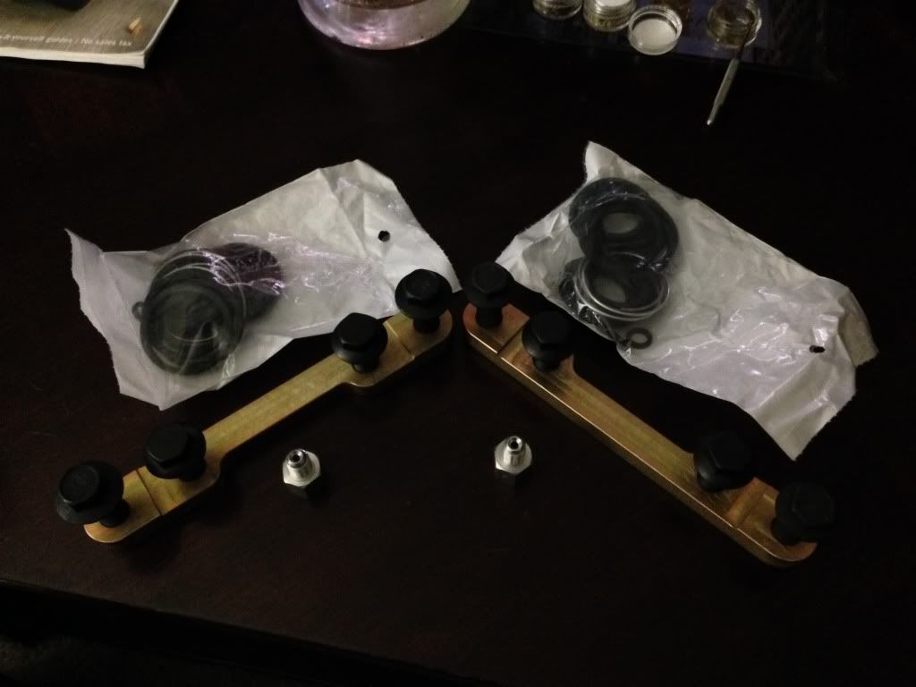

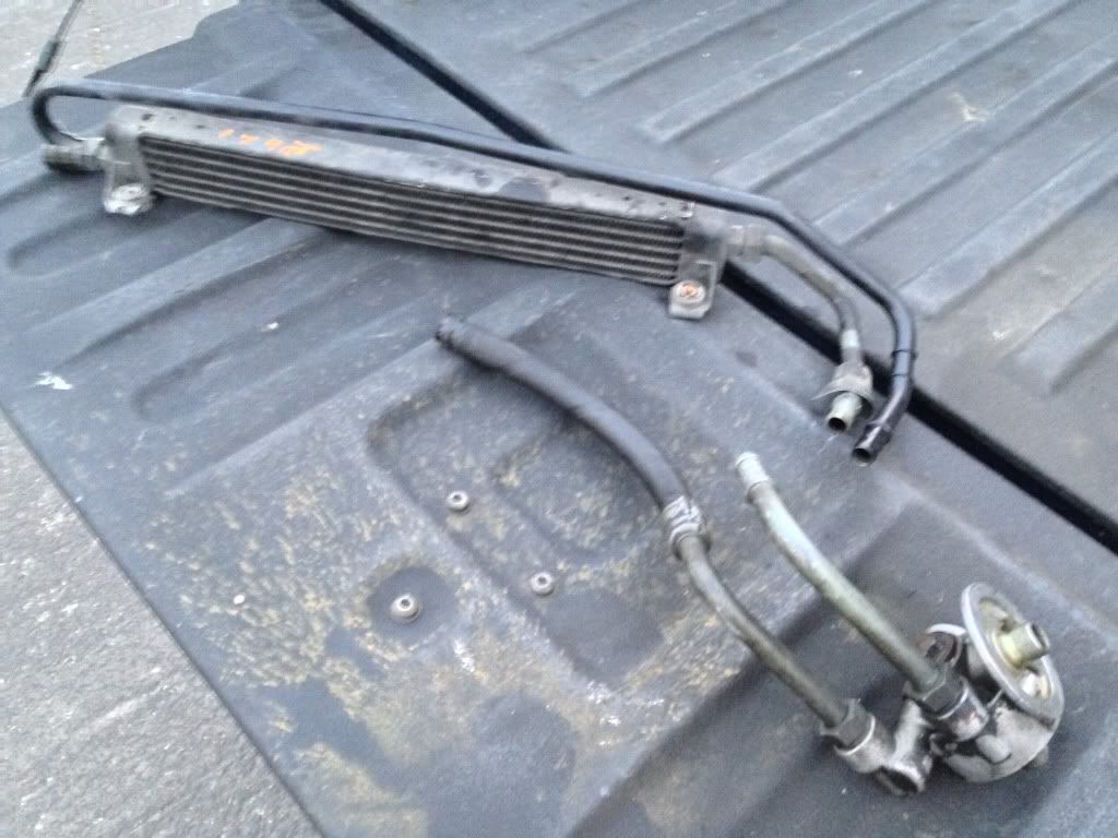

                            Here's the brake adapters and rebuild kits

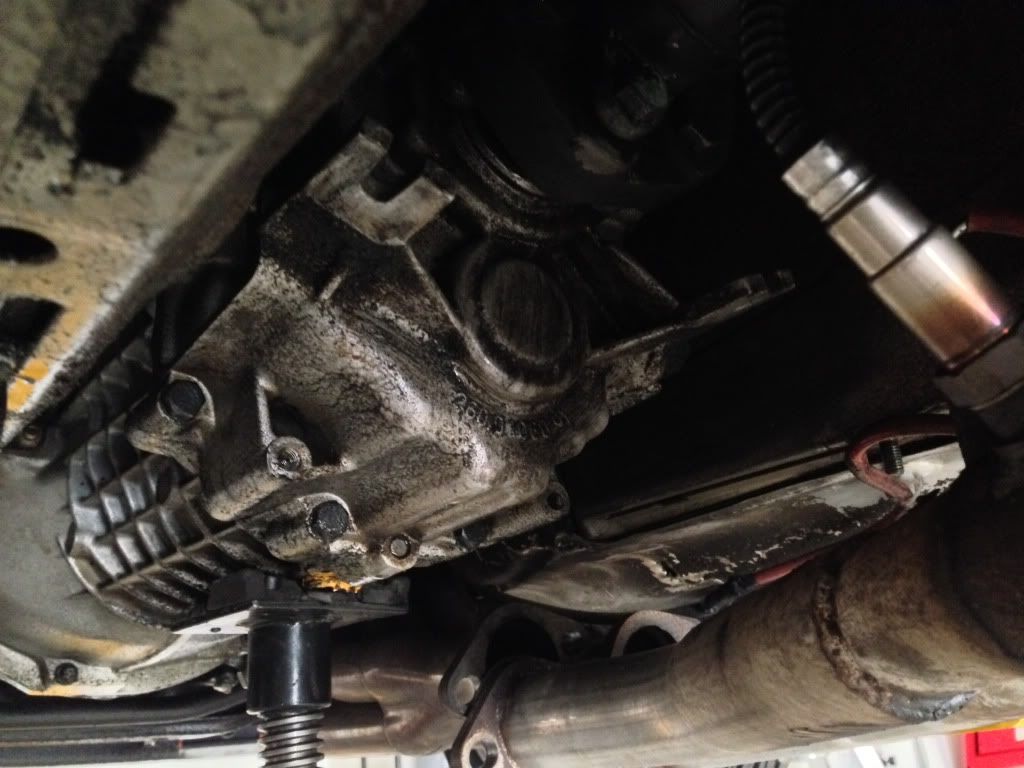

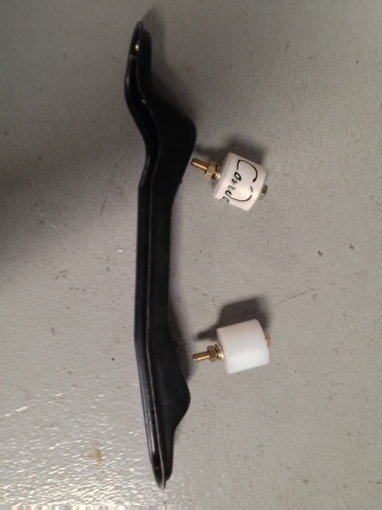

                            since my car was/is an eta it doesnt have an oil cooler, So i found a clean one from pick n pull. i filled it with oil and it didnt leak anywhere...also pressure tested it at work...i wanted to replace the hoses so I cut them off and now i regret it because my hydraulic hose place doesnt have the collars to crimp on the new hoses, theyre telling me to use hose clamps.
                            What do you guys use for those have replaced these lines? OEM BMW is like 100+$ each.
                            Yummy. Oil everywhere haha...its seeping somewhere. no drips ever really.
