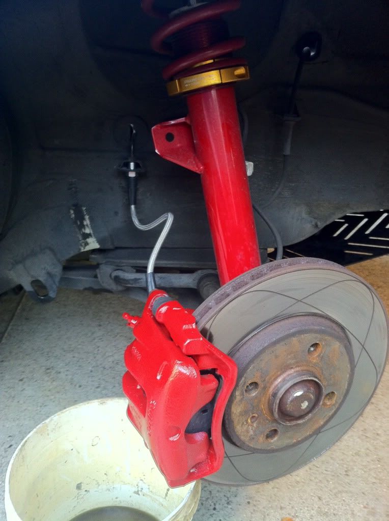

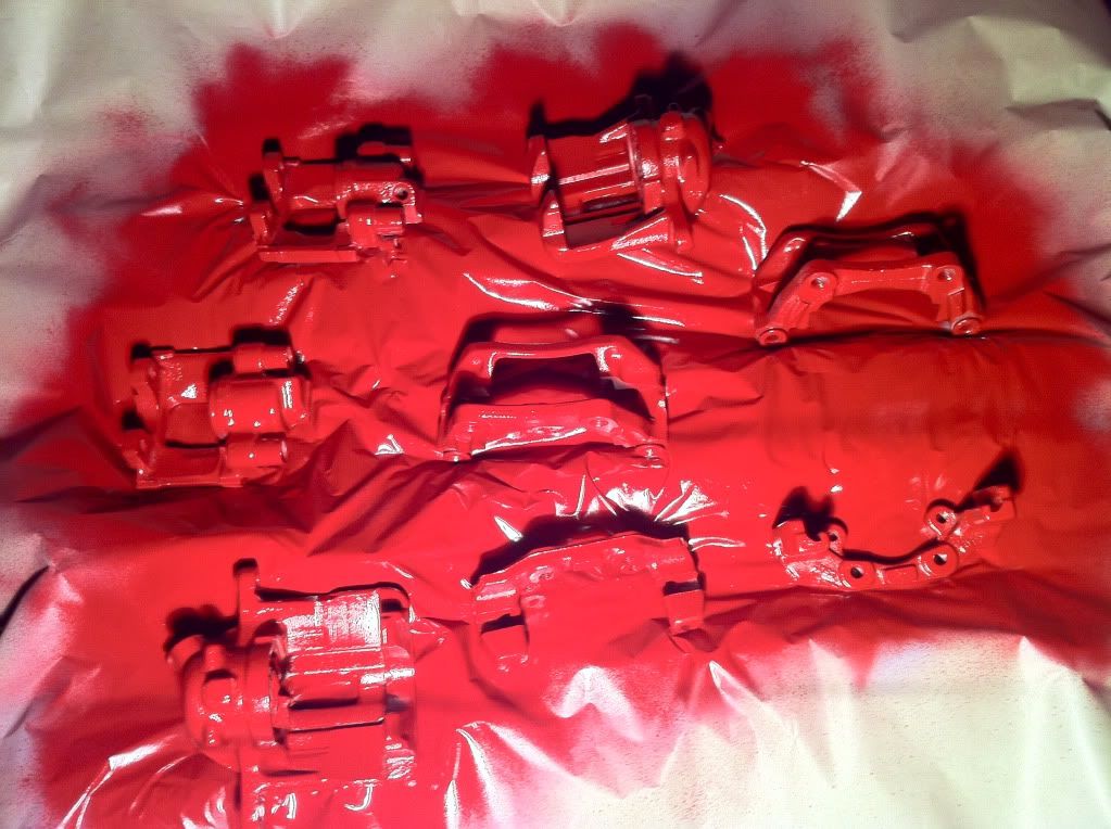

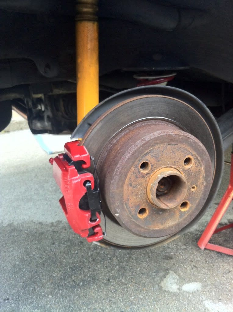

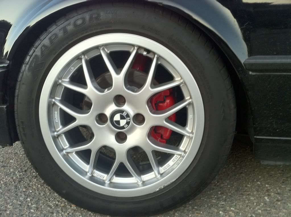

But yesterday I tore down my brakes, rebuilt the calipers, painted them, put stainless brake lines, ceramic pads, New spark plugs (W8LCR), new distributor rotor/cap, and fuel filter.
Looks like I haven't updated this in a while. Since then, I've purchased a Miller MAF/W.A.R. Chip...and s50/s52 swap is out of the question now and replaced with turbo plans :)
Heres some pics, my car runs sooo much smoother with the new parts and STOPS!!!!
Painting the calipers

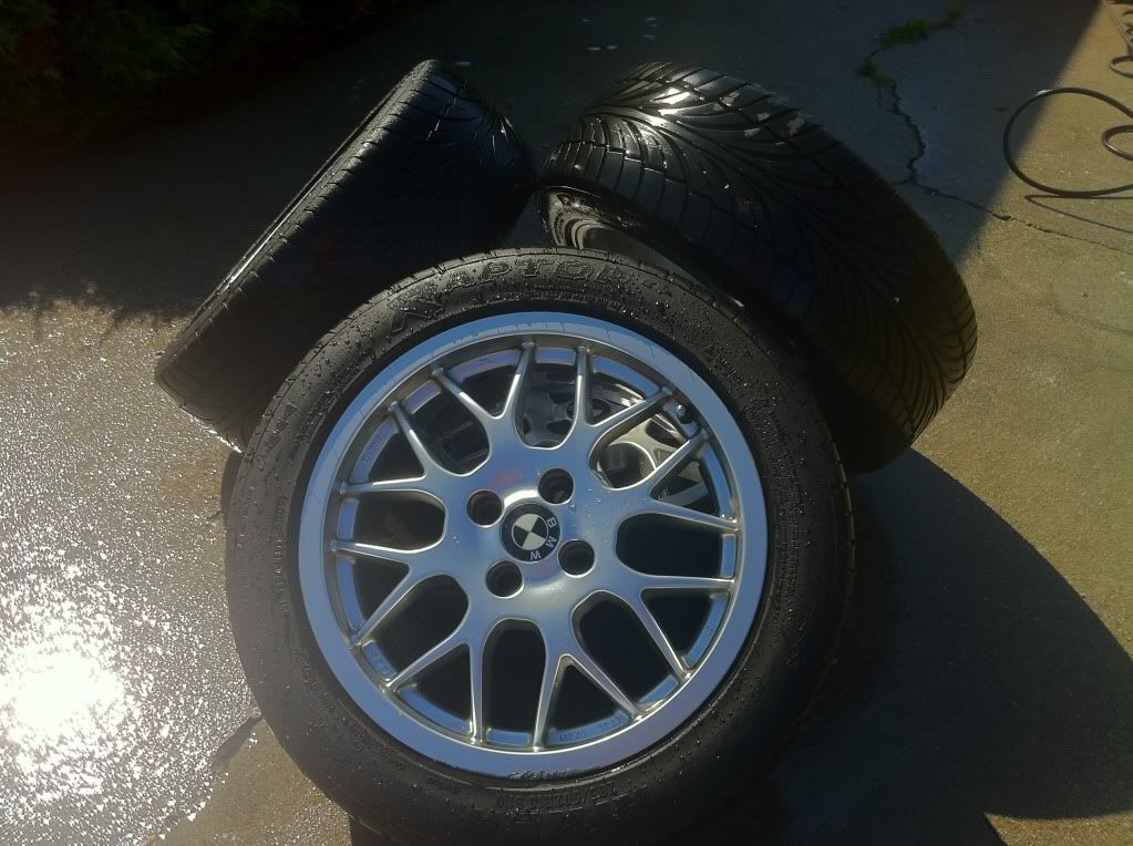

While the wheels were off I cleaned them nice and good with the power washer, scotch pad, and some wheel cleaner. Nice and clean!!
Calipers reinstalled...
Rear...
And back on the ground!!! Just noticed this was taking before I put my iS lip back on
A close up..

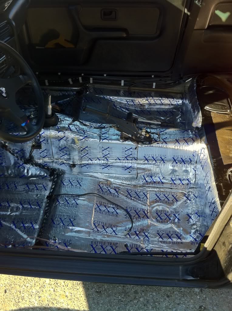

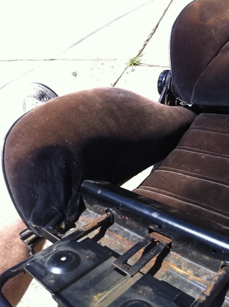

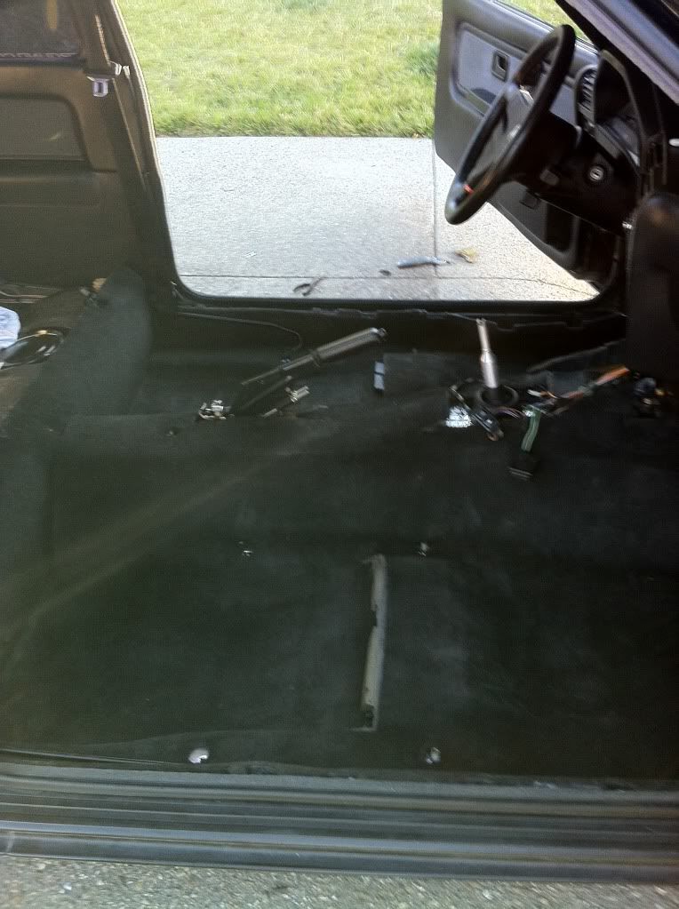

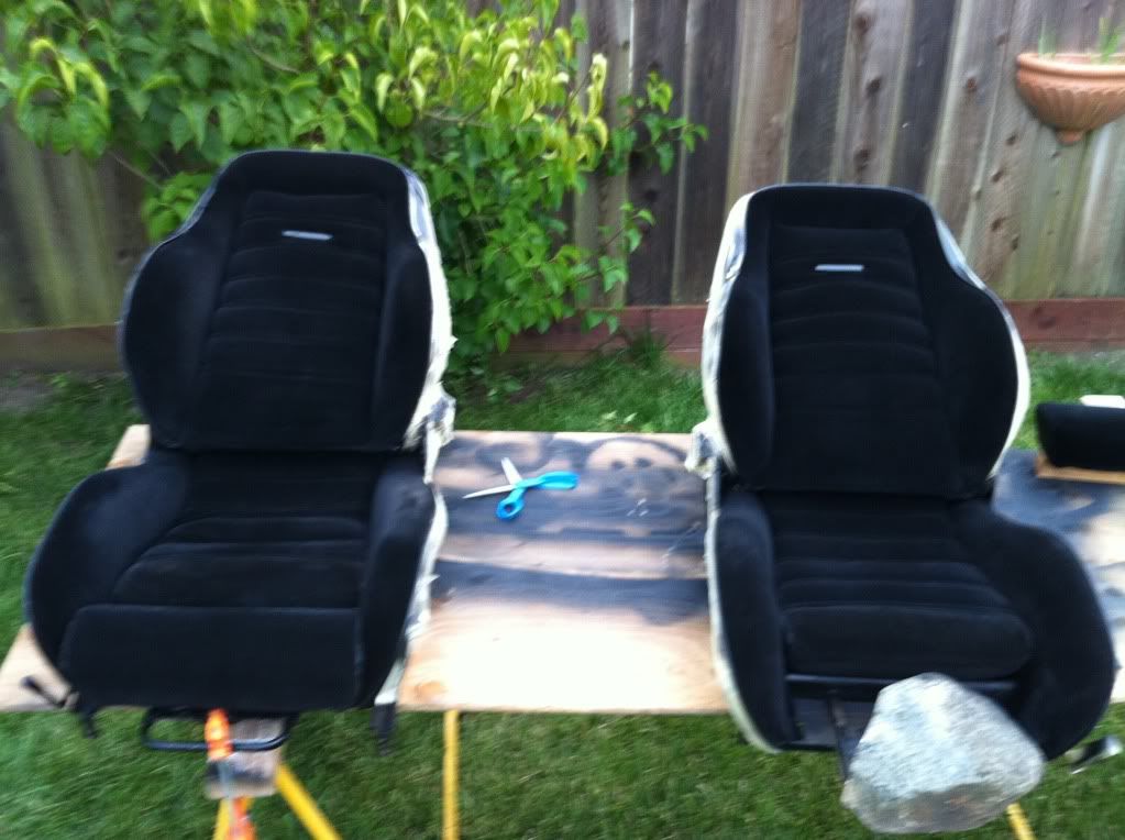

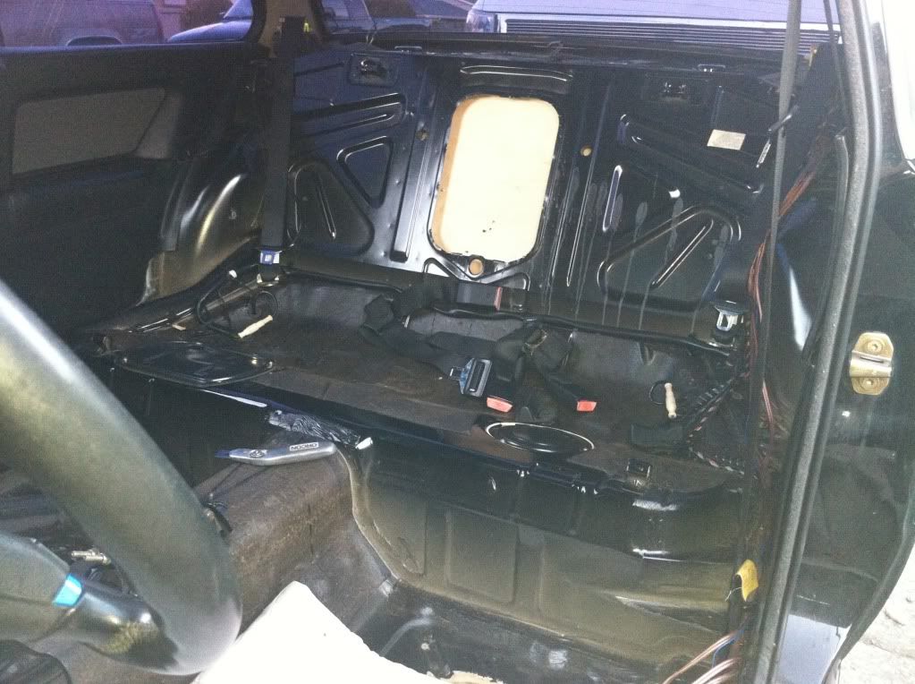

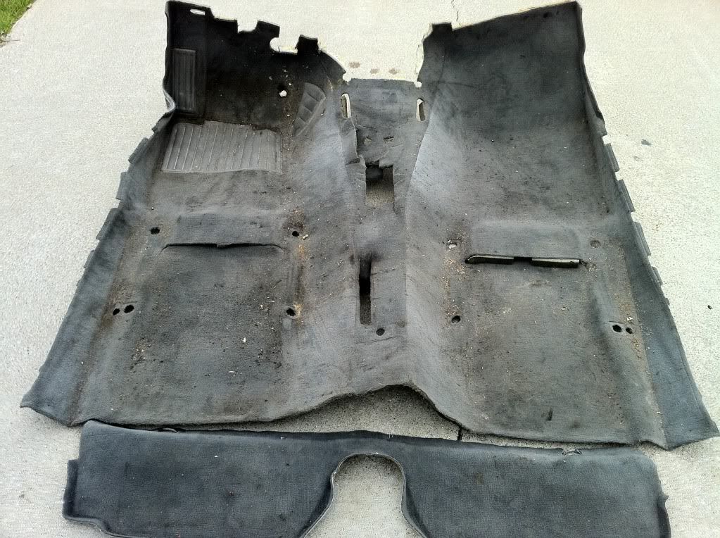

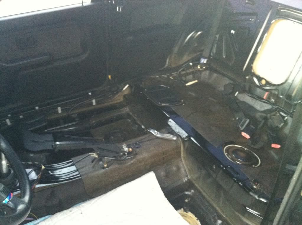

So, past few days I've been trying to tackle this...takes forever, and I'm working full time now. So no time to work on the car :(. So, I sprayed my recaro's, this stuff works awesome!! Sprayed the carpet also, and with some rubbing/petting, they both feel like they aren't painted. Almost like they did before I painted, maybe in time. But anyways! Heres some pics!
First you gotta take everything out!
They were black at one point :)
After some paint :)
THrow a layer of Fat Mat's Rattle Trap Extreme (Knock Off dynomat, works just as well for 1/3 the price)
Then new carpet in :)
And thats where I stopped, I can't tell you how much of a pain in the *** this is. But the outcome is soooo nice! :) Well worth the total of 50$

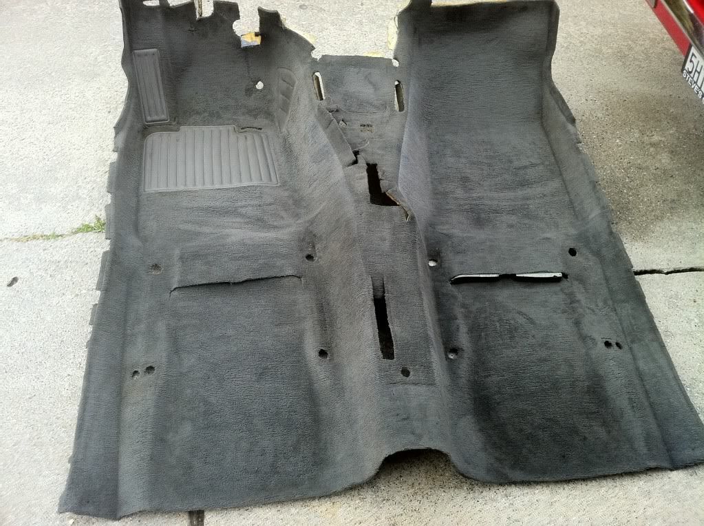

Been super busy, and tired after work so haven't been doing much, but heres some pics. Also did some research on these m50 injectors. So in the application with a 3 bar regulator for m20's, these m50 injectors will actually put out 15.81lbs/hr (166cc/min). According to some calculators, these injectors will support about 181 hp at 80% duty cycle, if the BSFC is .42 that someone recomended. I believe these should help out with my engine, since i feel like I'm running lean, since my 2.7i/cam/m30afm/alpina chip. I found out that alpina used same stock injectors, but used a bigger fuel pressure regulator which means more fuel, so thats why it was able to achieve 210 peak hp. Maybe this weekend I'll install, and let you guys know how it feels (if at all noticeable). I also ordered 50 sq ft Fat Mat Rattle Trap (Like dynomat). Gonna lay it all on the trunk/interior when i swap the carpet into my car. I'll get some more pics then, but to hold you over, these are the ones I have so far.
Filling her up! :)
Grey dirty carpet.
All Cleaned up. Used laundry soap w/ stain fighter/hose/brush.
Will get pics of black carpet soon, Also got a new late model rear deck with the built in 3rd light (flush) and sprayed that black too. Used Duplicolor fabric/vynil spray, I sprayed a couple coats and brushed it. Its not hard and feels like I did before I painted it.

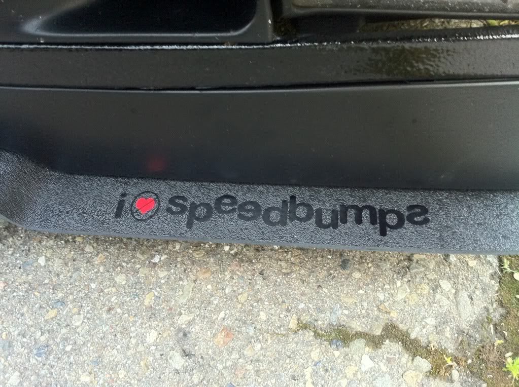

My new sticker :)
I really do now that my lip is 3.5" off the ground and my skid plate is 2.5"

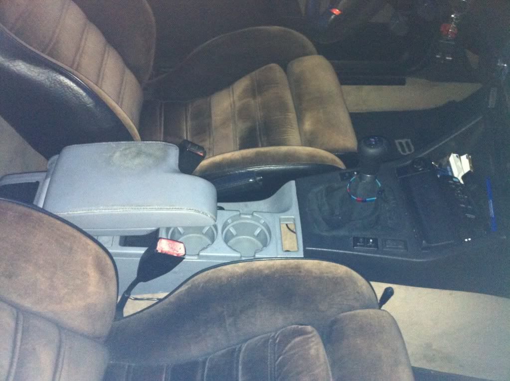

And...my project. e46 console, Gonna paint it black, Also got a new black leather wrap for the armrest with red stitching :) I will also be painting my Recaro's from the brown to black with the same duplicolor. I'm really happy with the result of the carpet and wanna try on the seats. If it doesn't work, I'll live with it until I can afford to get them rewrapped with grey suede where the brown is. But I'm confident it will work!

I also started retrofitting my e46 console, I cut/grinded the armrest to fit, its currently sitting in my car, just not bolted down, but it fits and looks good!
