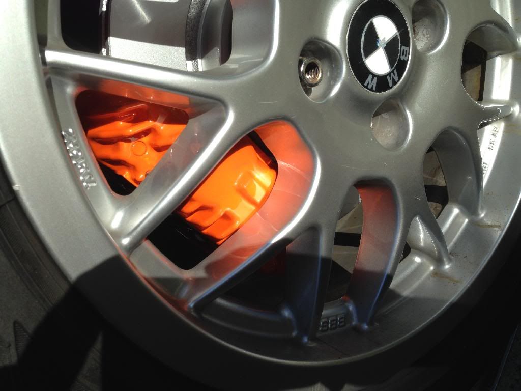

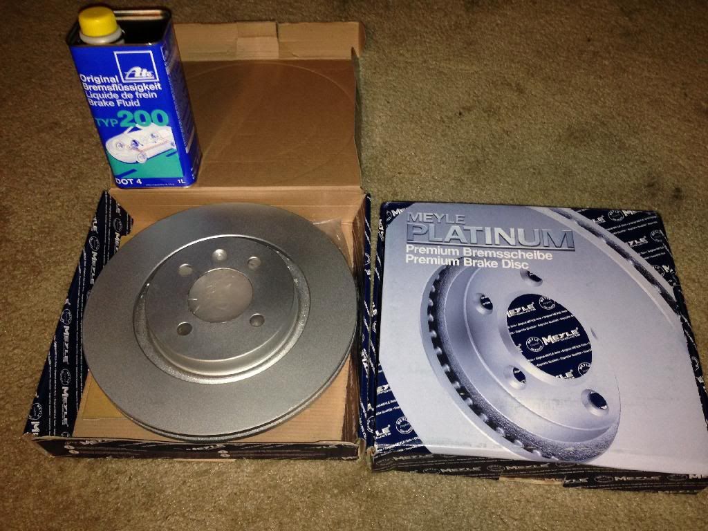

        Got some Corrado g60 rotors for the rx7 bbk. Gonna get them bored on the lathe at work.
        I just need to order new pads (rx7 fronts/e30 rears). I'm torn, I dont want a noisy pad, but Im greedy for max braking. I kinda want the porterfield r4s's but hear they're noisy.

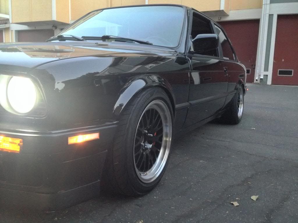

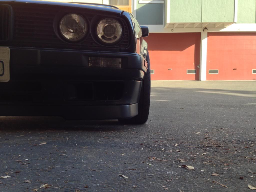

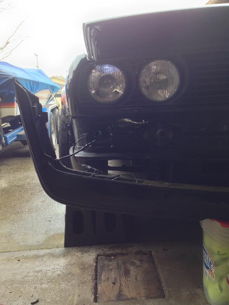

          Wired up my city lights finally. Been lagging like crazy.
          Got em wired up to the sidemarkers.
          Also washed both cars ;)
          Also got a new iS lip, gonna be ordering some fog light deletes and new hardware to hold all the valance stuff in because I straightened back out my valance from the Auto X incident

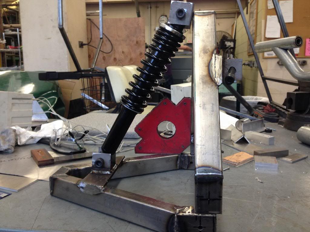

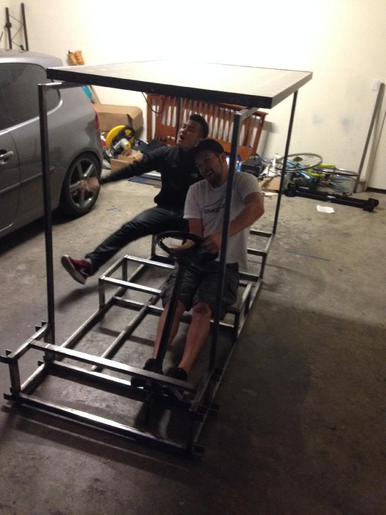

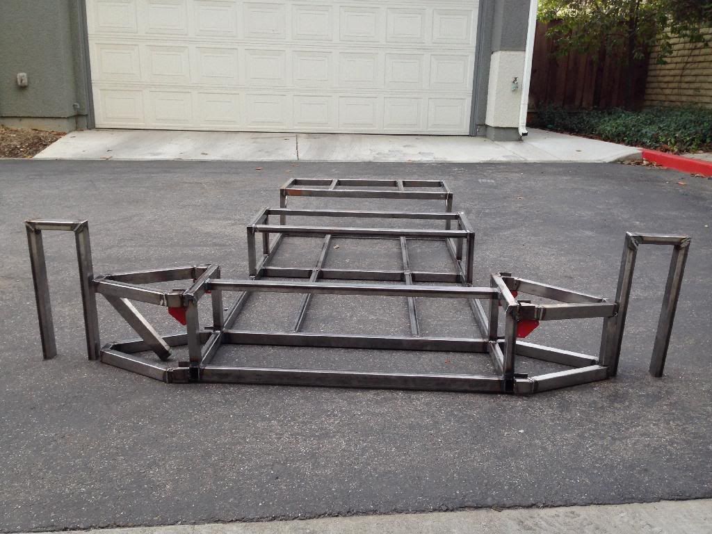

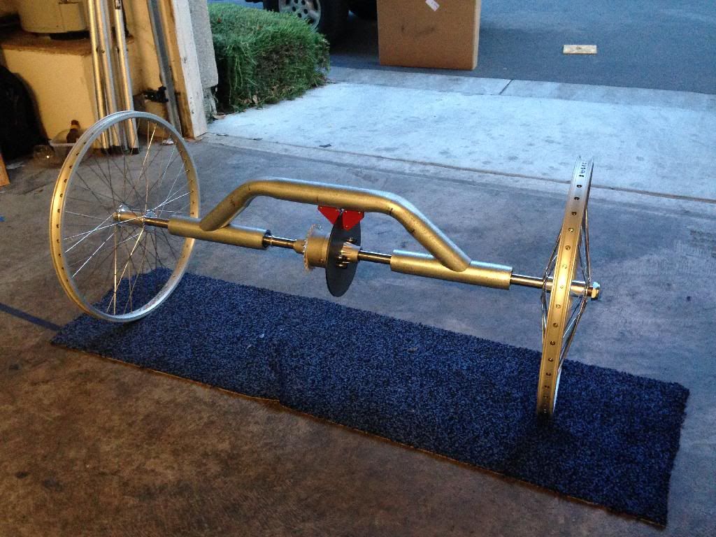

                    So, I haven't updated in a while cuz school is nuts, senior project is taking hella time up, but is super fun, and I've learned how to weld because of this project. I'm getting better :)
                    We're making a Solar Quadricycle Hybrid vehicle. Basically a solar/electric golf cart.
                    Last semester we designed it all up and CAD'd it, now we have to fabricate it this semester. Super fun.
                    Here's some pics. If you guys care...
                    Fun stuff, and pretty suprised on how it turned out for my first ever fab work. lol, just dove in, couple practice beads then started on the frame. now i have the confindence to go CRAZY with my 2002 build.

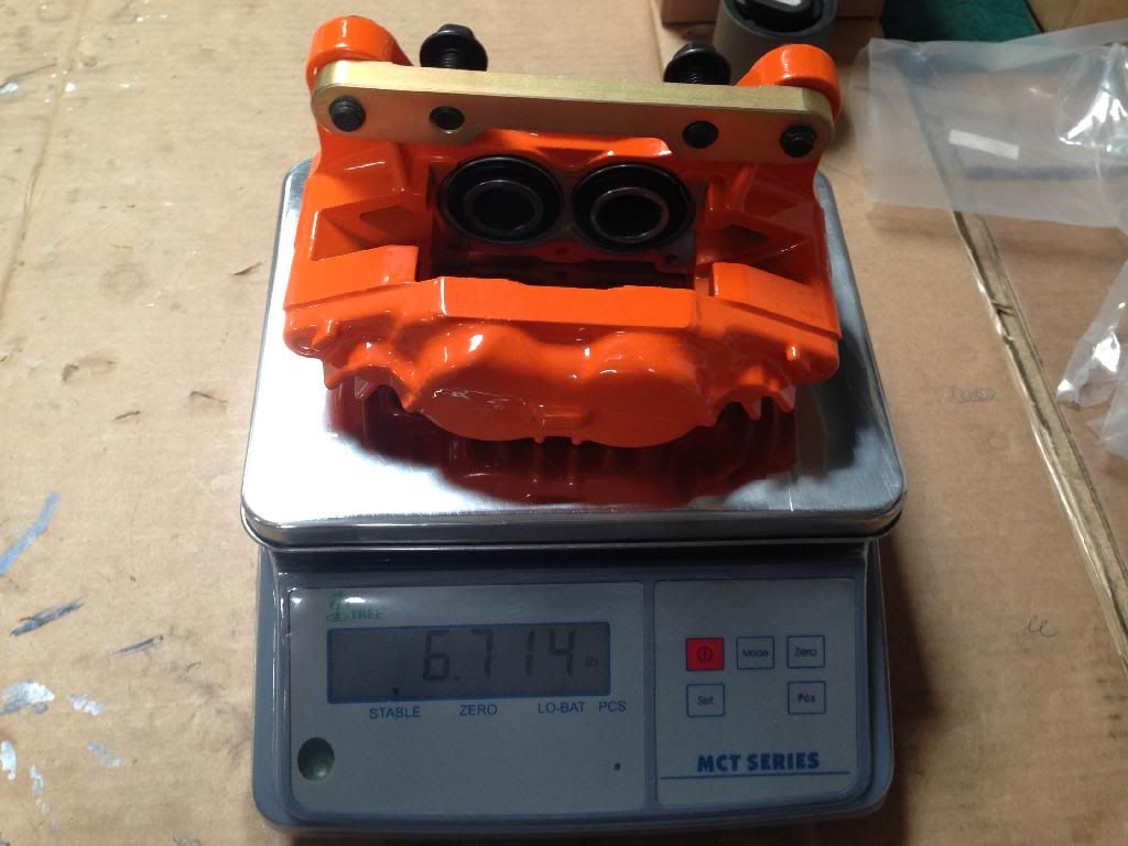

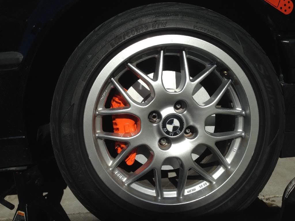

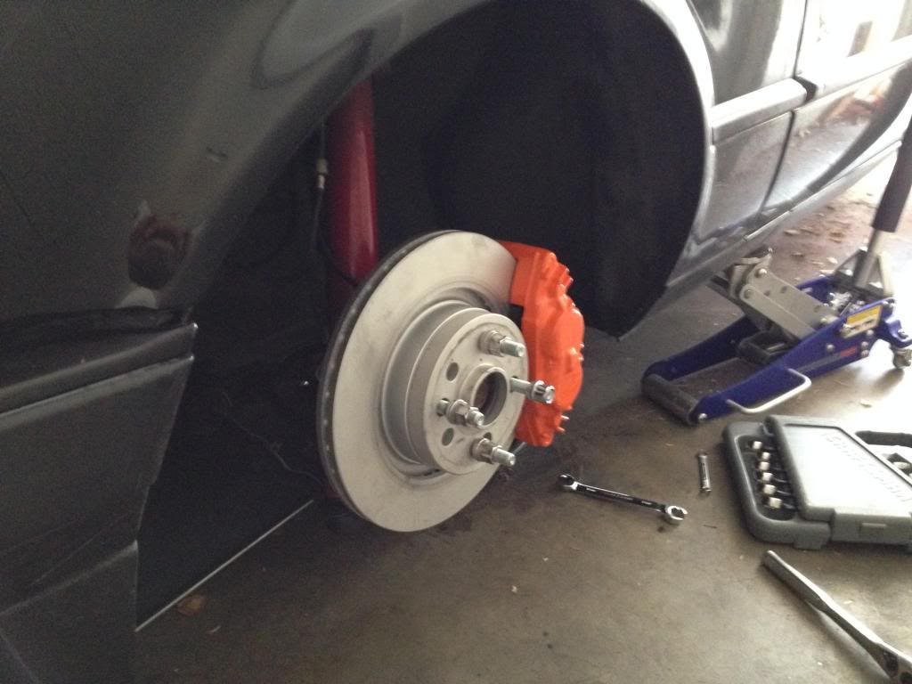

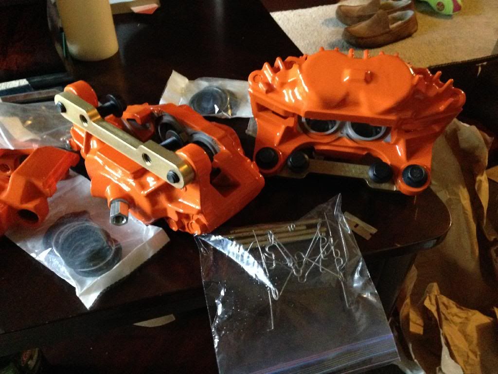

                    Back to some e30 stuff, even though i've been broke lately. I've messed with the BBK finally.
                    But I need 15mm spacers to clear the caliper instead of my 10s. Which means i need new studs too. FML.
                    Polished the pistons
                    Will get a stock caliper weight when i take mine off.
                    Fits....but hits the nub

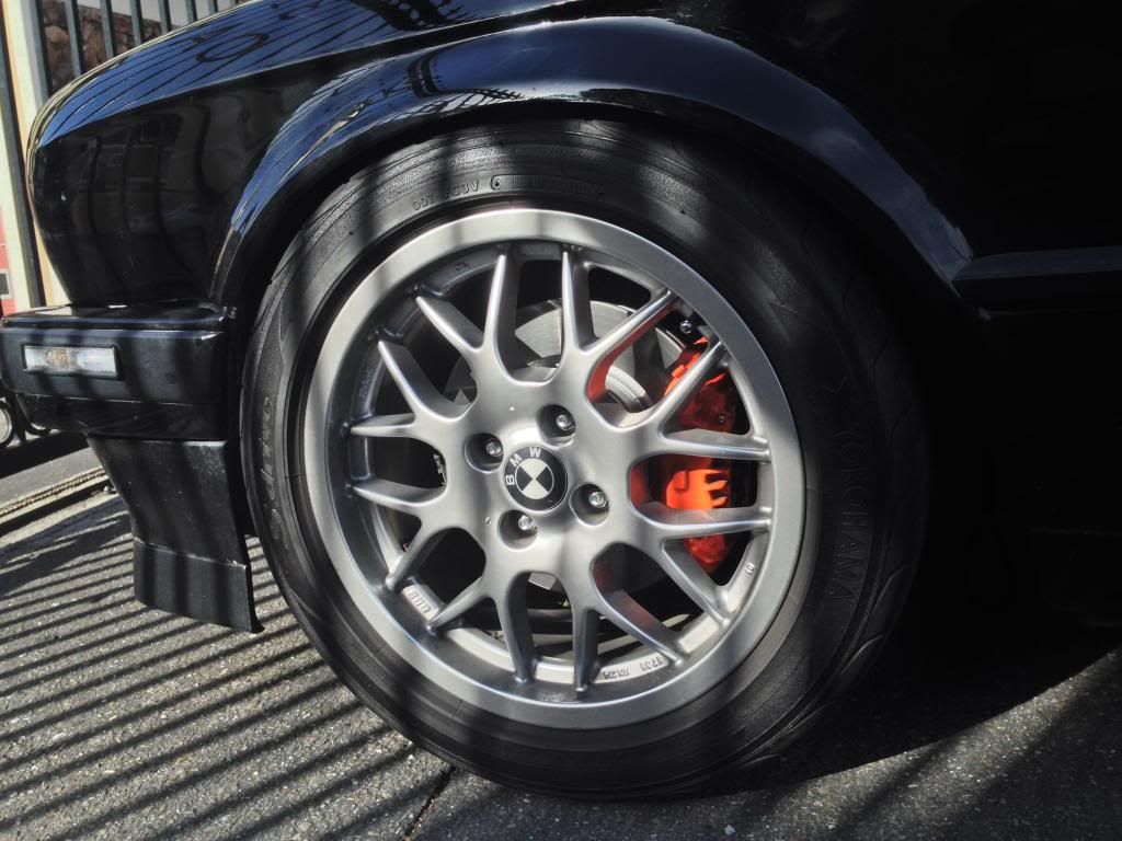

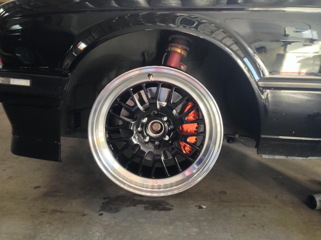

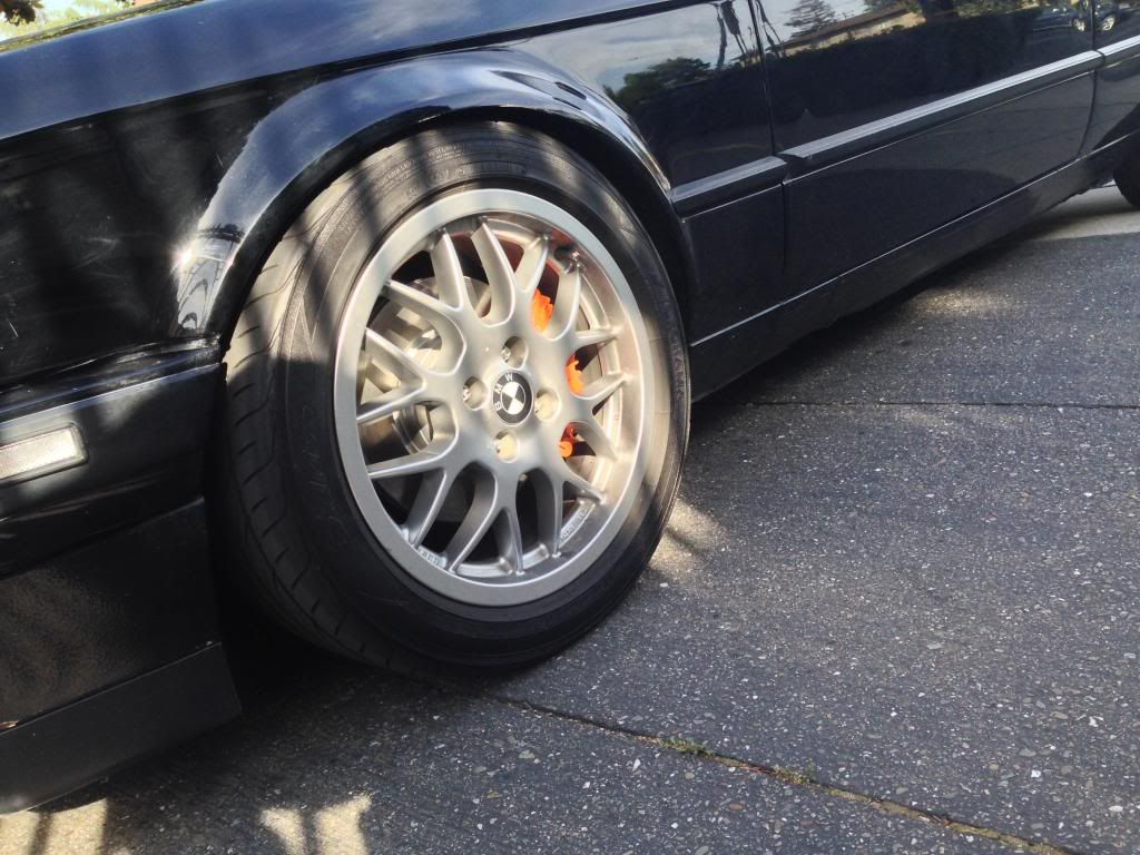

                      So I got some bigger spacers (20mm) to fit the BBK. #Hellaflush! Lol.
                      I love how the tire pokes out the side...this is probably my favorite angle of my e30/a car.

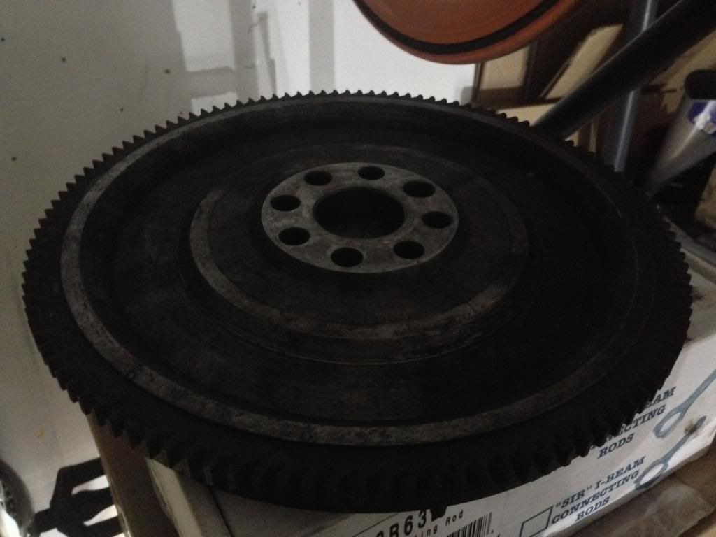

                      Time to slip this crank spacer for my 2.9L m20 on. Thanks to Matteo for the help on extra torch power and the hookah tongs :)
                      And after its on/where it goes.
                      Keyways arent hit in all the way.
                      Matteo also sold me a resurfaced 323i euro flywheel :) Since i gave me lightened/resurfaced m20 flywheel to a friend so he can attend his drift track day he had paid for.
                      Heres a comparison pic to show people... The back side of my old lightened m20 ~15 lbs
                      323i flywheel ~13.5 lbs
                      Bad pic, but notice the diagonal step down which was machined out, you can mimic this on the m20 flywheel, but you gotta know how deep you can go. also you need a lathe big enough. my machinist only had his mill, so he just took down the back flat.
                      This lil shit made my BBK install a little more difficult
                      But i got her on
                      and the other side
                      Wish my struts werent red now...
                      wheel on.
                      Theres plenty of clearance, could have use a 17mm spacer probably. a 15mm works, but theres like 3 thou of clearance.
                      The pop :)
                      AND THEY STOP!
                      The braking has MUCH improved even only just swapping calipers/bleeding. gonna do a brake fluid flush when i put my orange stock rear e30 brakes with bronze bushings on. but going to bimmerfest and dont have enuf time for that cuz of school. that will be next weekend :)

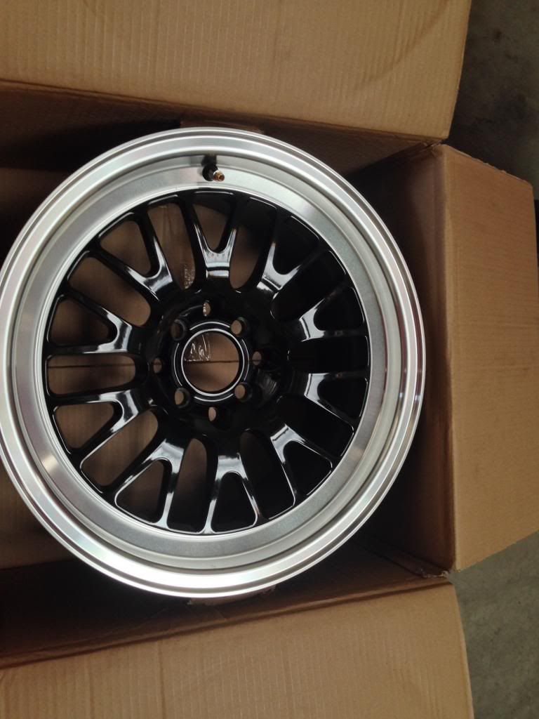

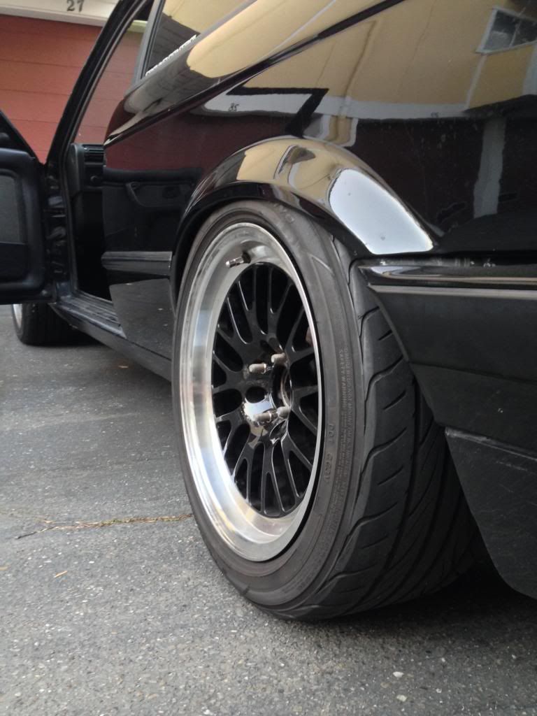

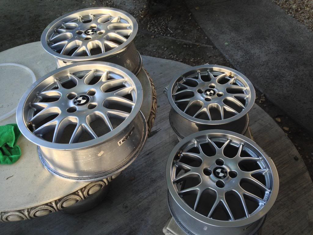

                              Got an insane deal on a set of wheels. Shout out to Leo @ Veloximo & Detail Addict, he's the man for any needs related to wheels or detailing or pdr. His website is http://veloximo.com/
                              and he's also a e30 owner and enthusiast so why not keep the business in the community :)
                              Need some fender work before i can roll like this :) 10mm spacer is too much but looks sick! haha.
                              how it is
                              I love the front fitment
