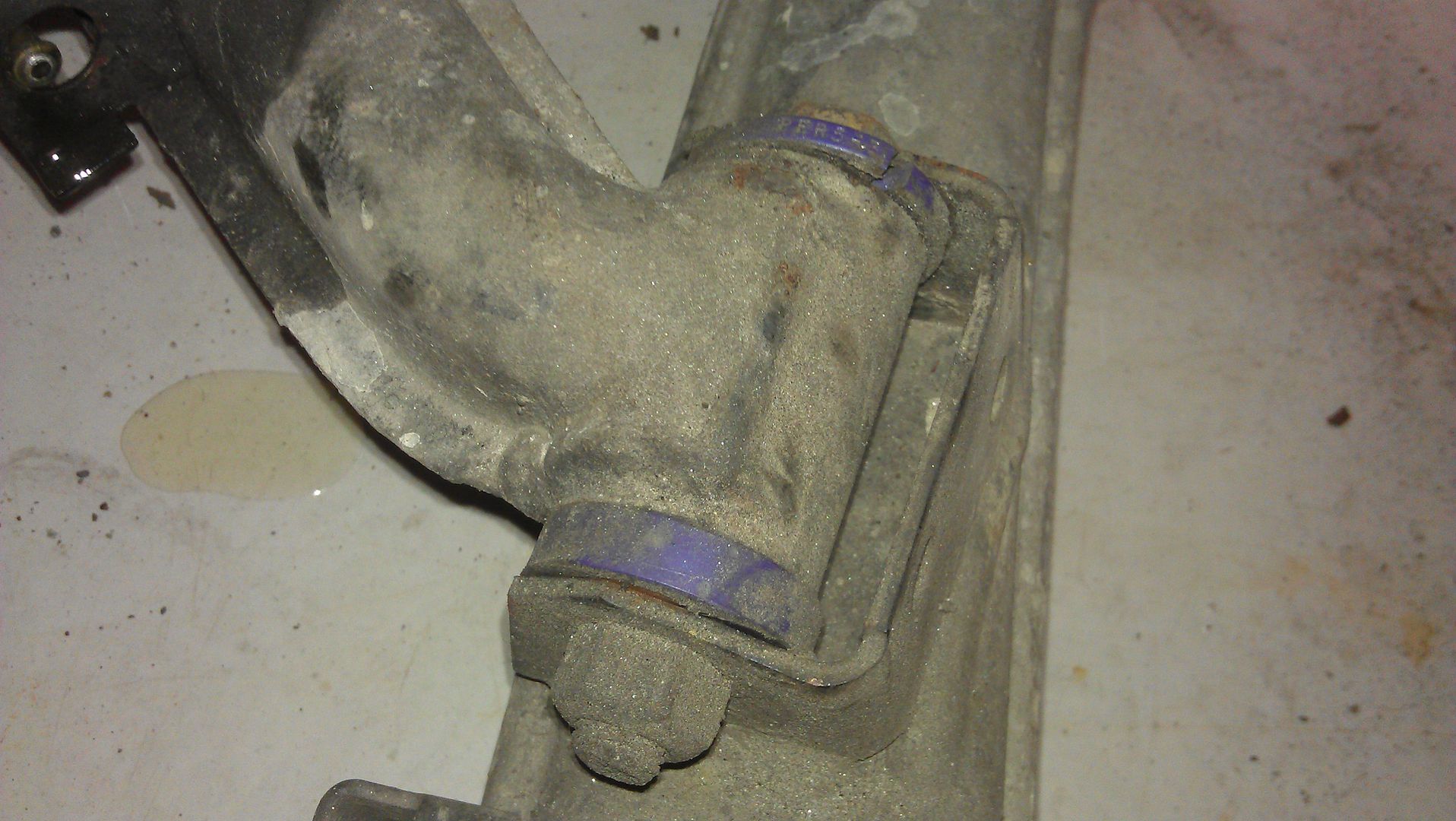

    I have taken out the rear axle as well and welded in Z3 reinforcement and swaybar reinforcement on the control arms. I also find that my 2 season old Powerflex bushings was all cracked up and ruined.

      Powerflex....
      Powerflex have lifetime warranty, so I got new from them in the black 95a polyurithane. Camber/toe kit is from AKG Motorsport.

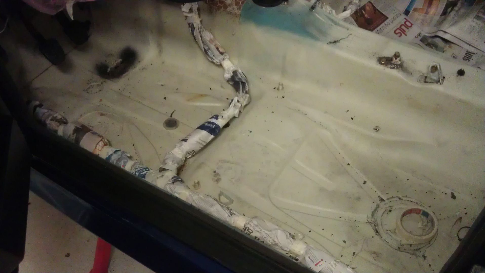

                Radiator was not good enough finsh, so I painted the sides with black wrinkle paint.
                Painted the floor with a thick coat of epoxy.
                Battery box also got a layer
