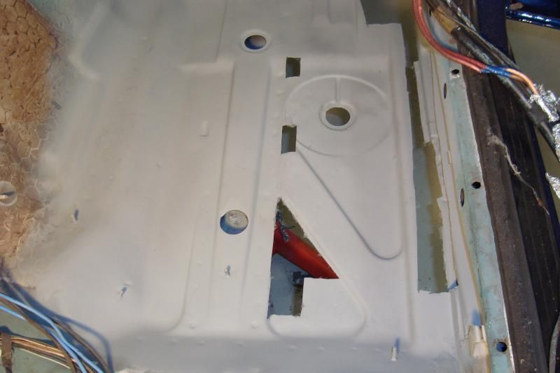

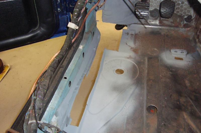

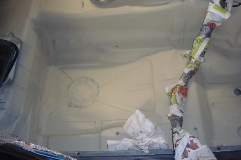

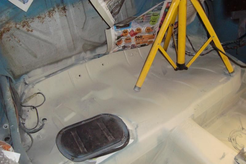

    Removing asphalt mats inside car to save some weight!

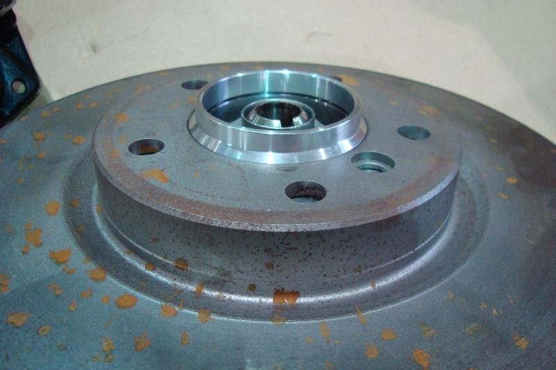

                          Making my own spacers to put behind the E36M3 brake disc
                          Made som extra so I could sell them :)
